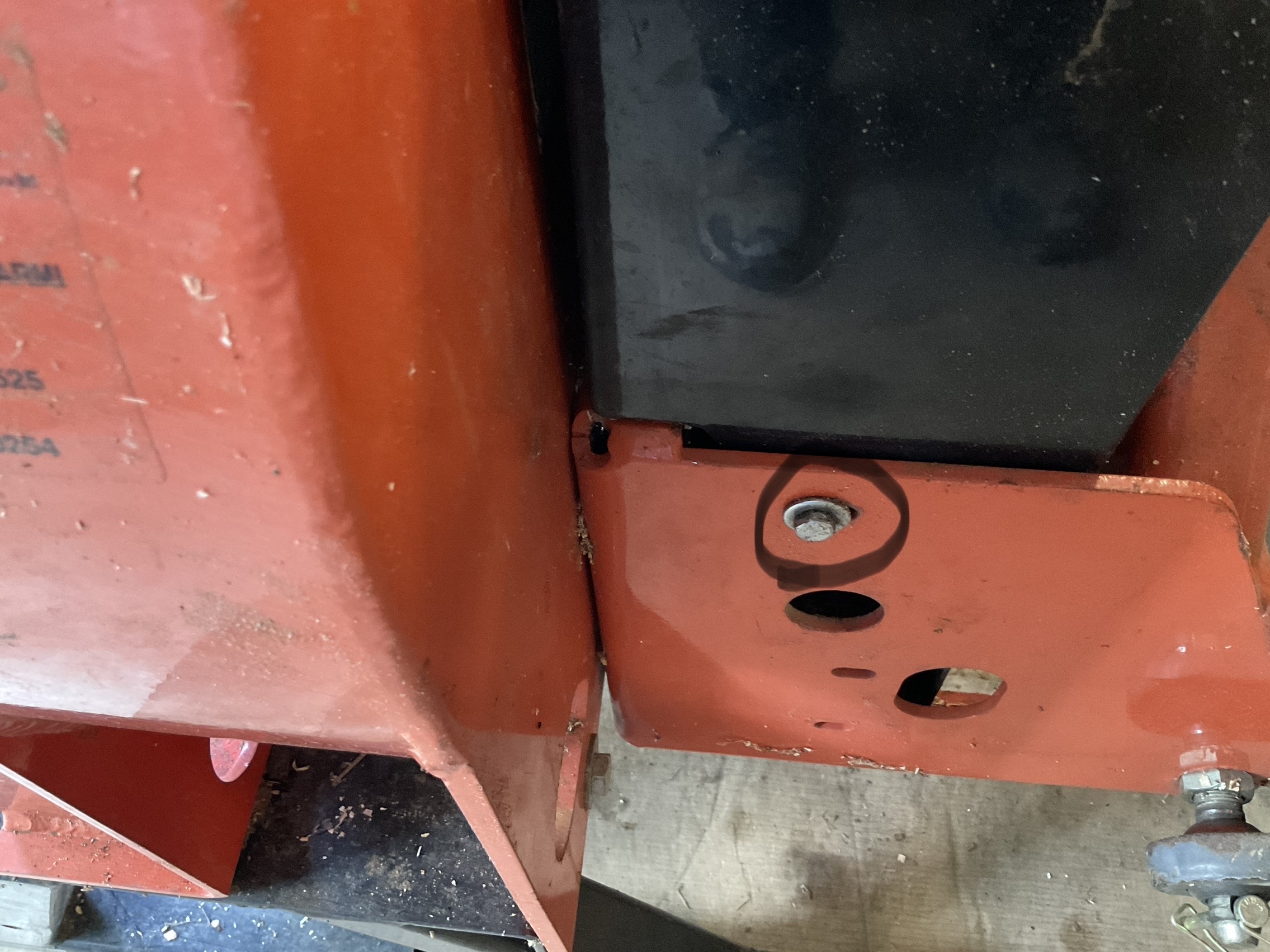

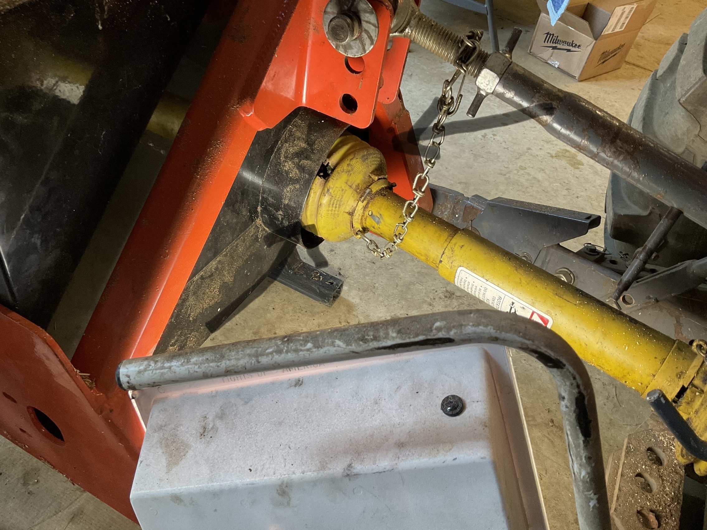

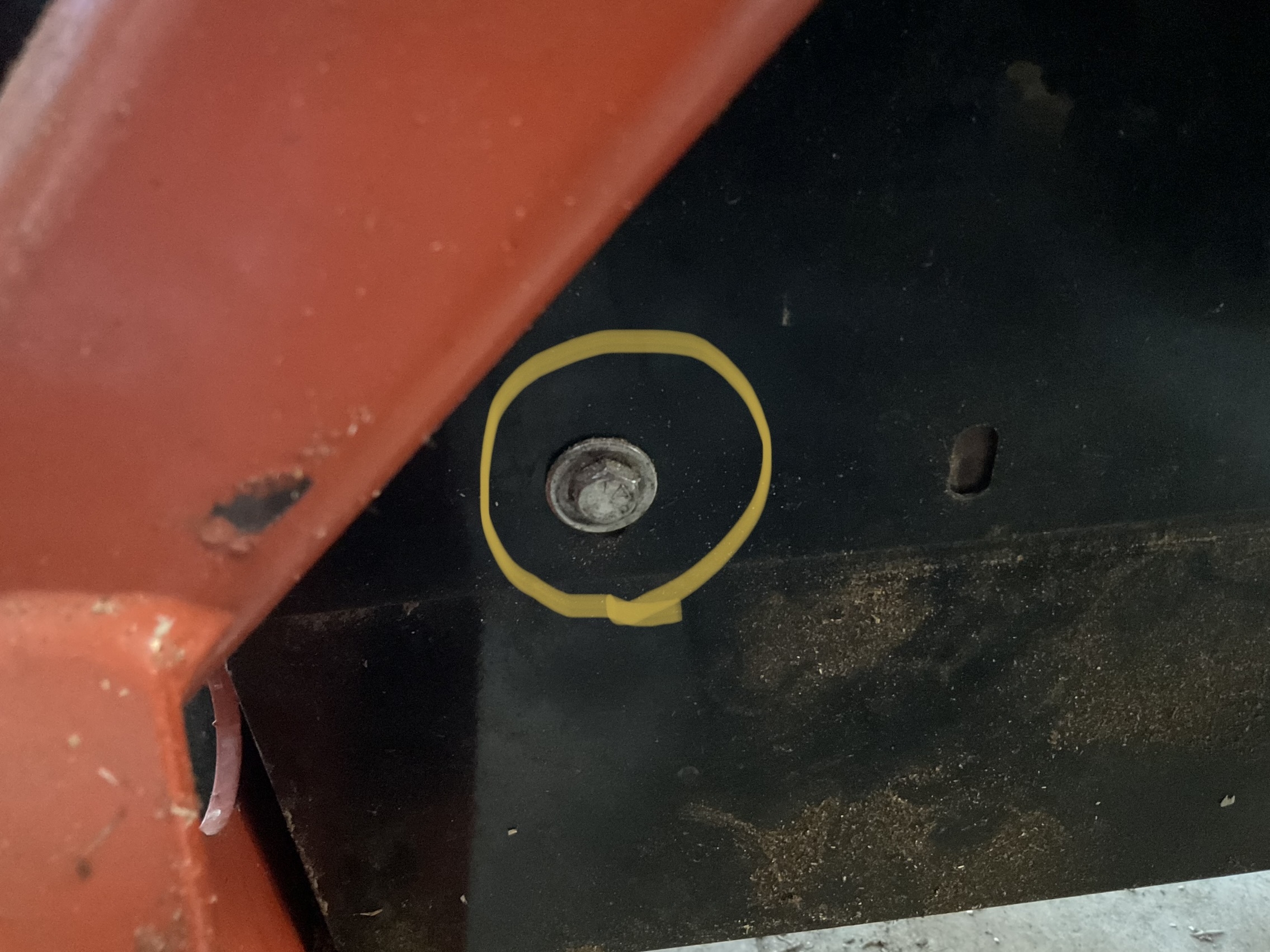

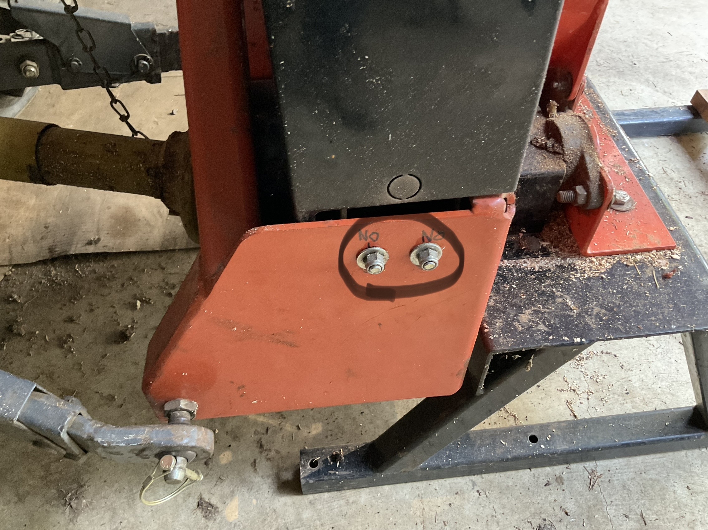

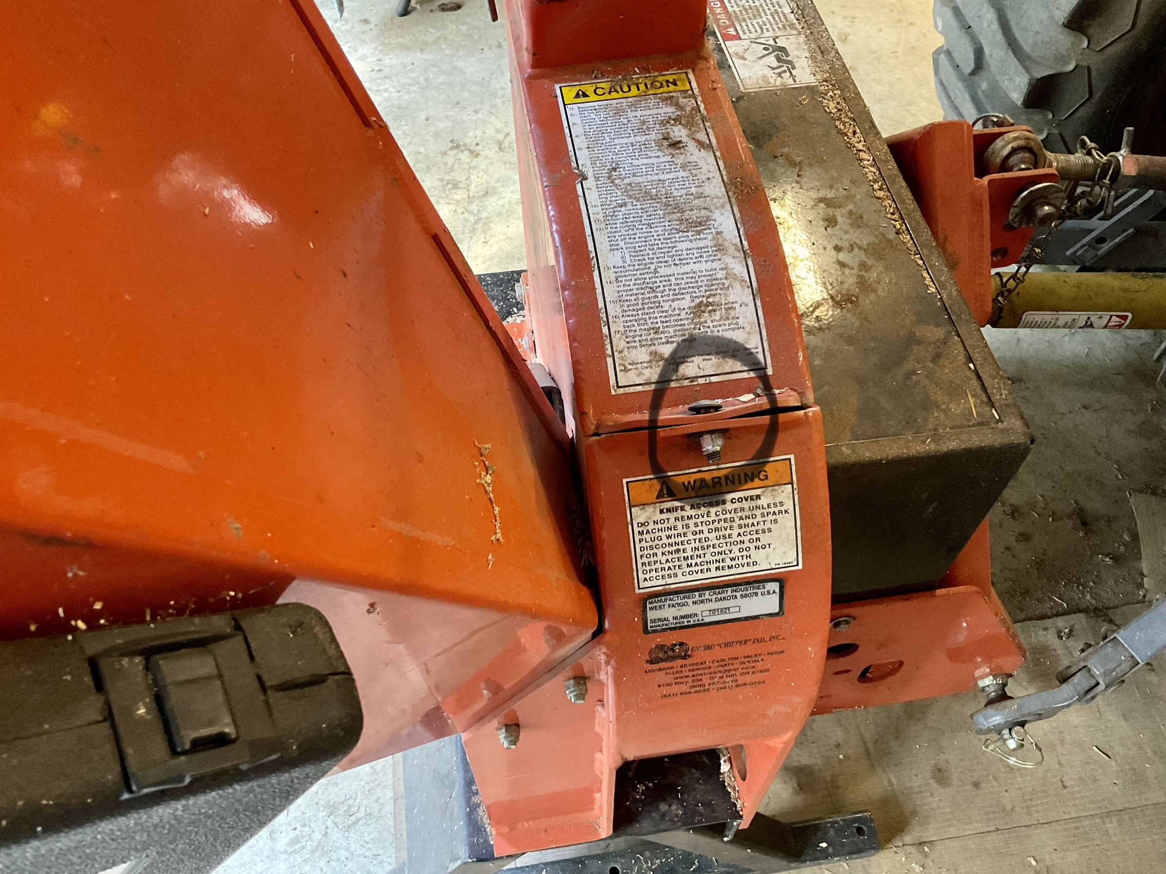

Pictures below show which bolts need to be removed to access drive belts. PTO shaft can stays on the chipper but has to be removed from the tractor and then separated so that collar can be slid down to access two bolts inside the ring by the
PTO shaft.
