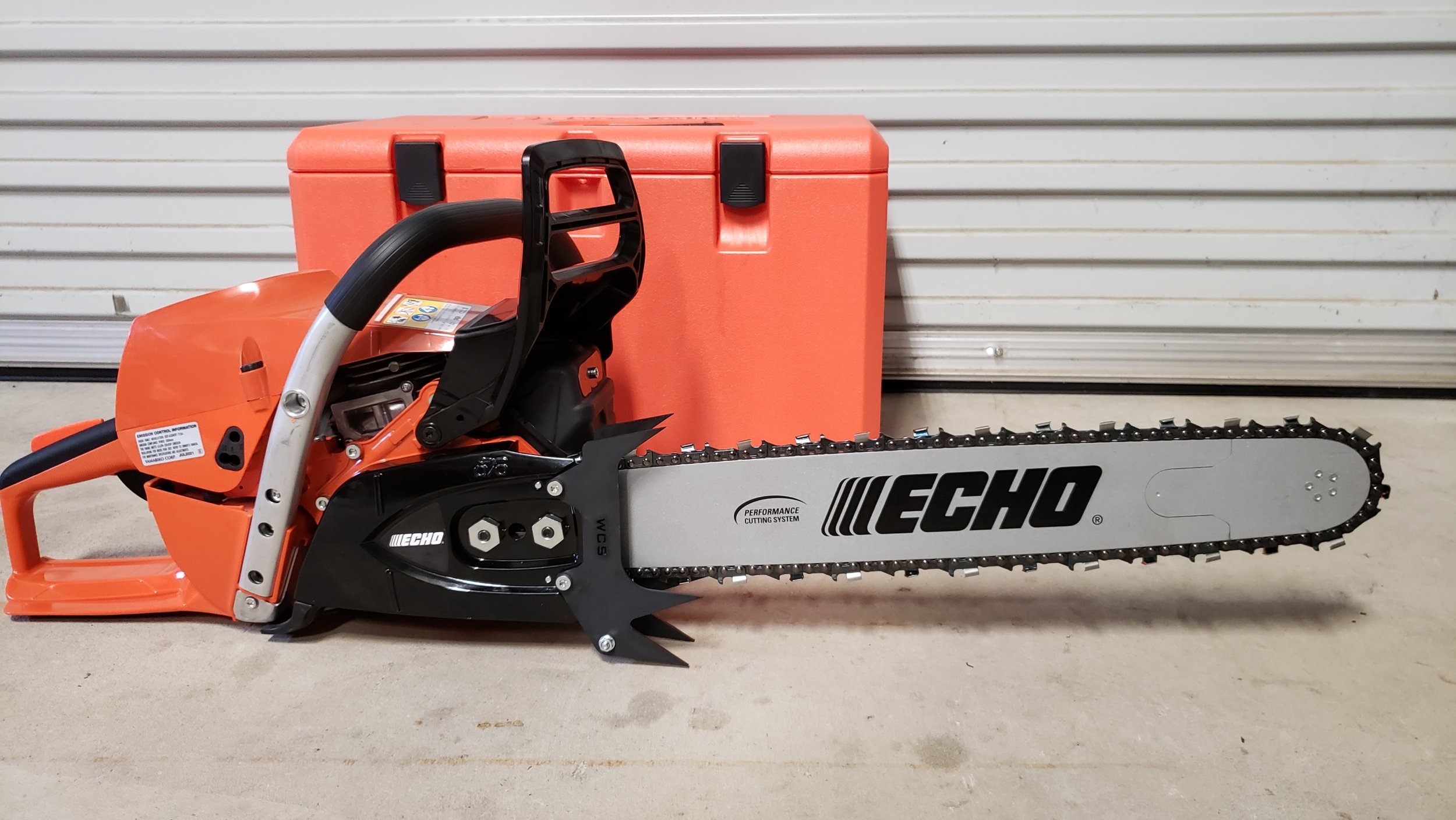

I just bought a brand new Echo CS-7310P saw. (20" bar 3/8 .058 ga) This saw starts very well, runs very good.
I would like to hear from the folks in here if they have this particular saw, and what they think of it after running it for awhile.
The saw is only using VP 50:1 Fuel in the 1 gallon tin can. I did pick up a 6-pak of the Echo Premium 2 stroke oil to mix (NON CORN) fuel later on after the VP fuel is used up.
Muff Mod: Is the muffler mod really worth doing? Anybody have pics of their muffler mods? How does your saw run after the muffler mod? Was there that much of a difference?
I`m not into porting the saw, so as to make that clear right off the bat. I cut trees down for firewood when needed. I saw up storm damaged trees. I`m not interested in costly porting mods.
So far, mine is untouched, exception to adding the Westcoast 3 Bark Dogs.
Be very careful if you decide to change out the bark dogs, Echo really dumped gobbs of some form of white loctite in the bolts to the inner dog.
When i took the OEM dogs off mine, the top inner hole stripped most of the thread out of the case just getting the bolt out. I had no clue they filled these holes so full of loctite.
I was able to run a tap in the holes to clean up Echo`s loctite mess. When i installed the new WC3 dogs, i used loctite when i put the inner dog bolts back in the case.
The outside dogs have a bolt and a nut, (nuts are hidden behind the nylon chain guides within the chain case cover) those were no problem removing/reinstalling when i installed the WC3 dogs.
