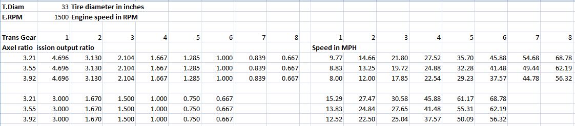

I wonder how many trucks slipped out of the factory this way? Was it on purpose to keep the mpg numbers up or just a honest mistake?
99% of the drivers wouldn't know where to look to see what they really have.Chris
Chrysler introduced the eight speed transmission in March 2013 RAM 1500 production which came standard with 3:21 axle ratio. Previous production came with the six speed transmission with standard 3:55 ratio and that is the ratio listed under standard features on the window sticker. There was a three week window of production before the window sticker caught up with the eight speed transmission/3:21 axle ratio. Chrysler issued a stop sell on the new eight speed transmission equipped trucks but dealers still sold them and I was one that bought one.
My first clue that something was wrong was the RPM versus 70 MPH, around 1600 RPM. I measured the tire circumference and calculated the MPH/RPM relationship with respect to each of the eight gear ratios and each of the three axle ratios. Finally I looked on the rear axle and saw a barcode tag that clearly said 3.21.
Are you sure it is bumper to bumper and not just powertrain? Lifetime bumper to bumper with zero deductible seems a bit of a stretch to me.
Yes, I am very sure, Chrysler gave me the Max-Care warranty, life-time, $0 detectable warranty, chrome bed rails, and a $750 Mopar gift certificate instead of a buy-back.
Chrysler Maximum Care warranty. Ultimate coverage for Chrysler.
It was the norm rather than the exception. They switched suppliers for the drivelines in 2013 and didn't have enough inventory to install the 3.55's and in some cases the 3.92's, so 3.21's were installed in a lot of trucks, no matter what the order said. When I bought mine the dealer went out of his way to make it clear what ratio was installed which I thought was a little unusual at the time. However it makes very little difference in performance because of the 8-speed auto, which essentially has two bull low gears. These trucks jump off the line with almost no throttle.
Your are right about the new axle supplier for MY13 (ZF) and about the 3:21 axle ratio having more off the line grunt that a six speed transmission with 3:92s but the reason why is inaccurate, read why above.
