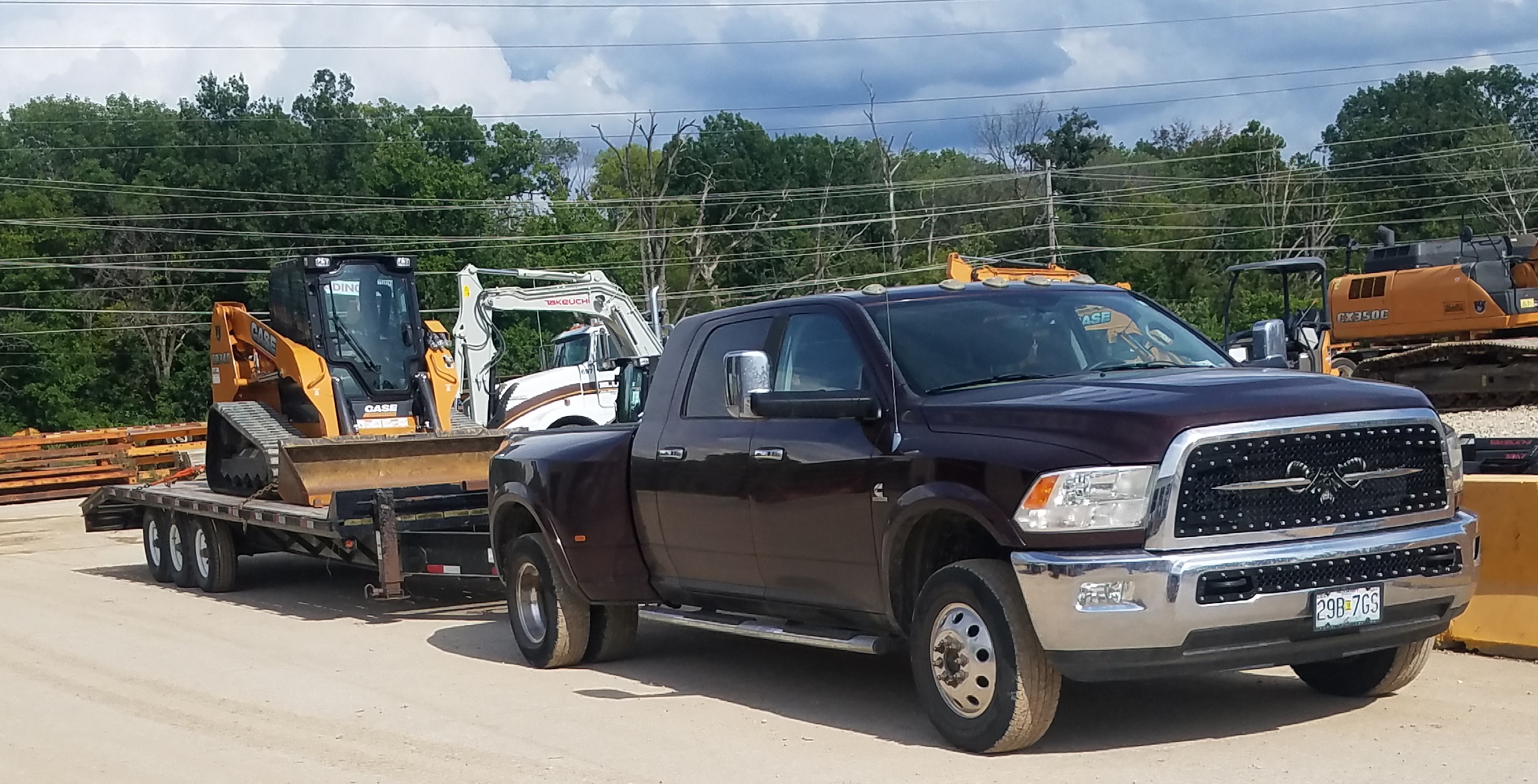

Bringing it home. It was worth the trip. Very clean unit.
