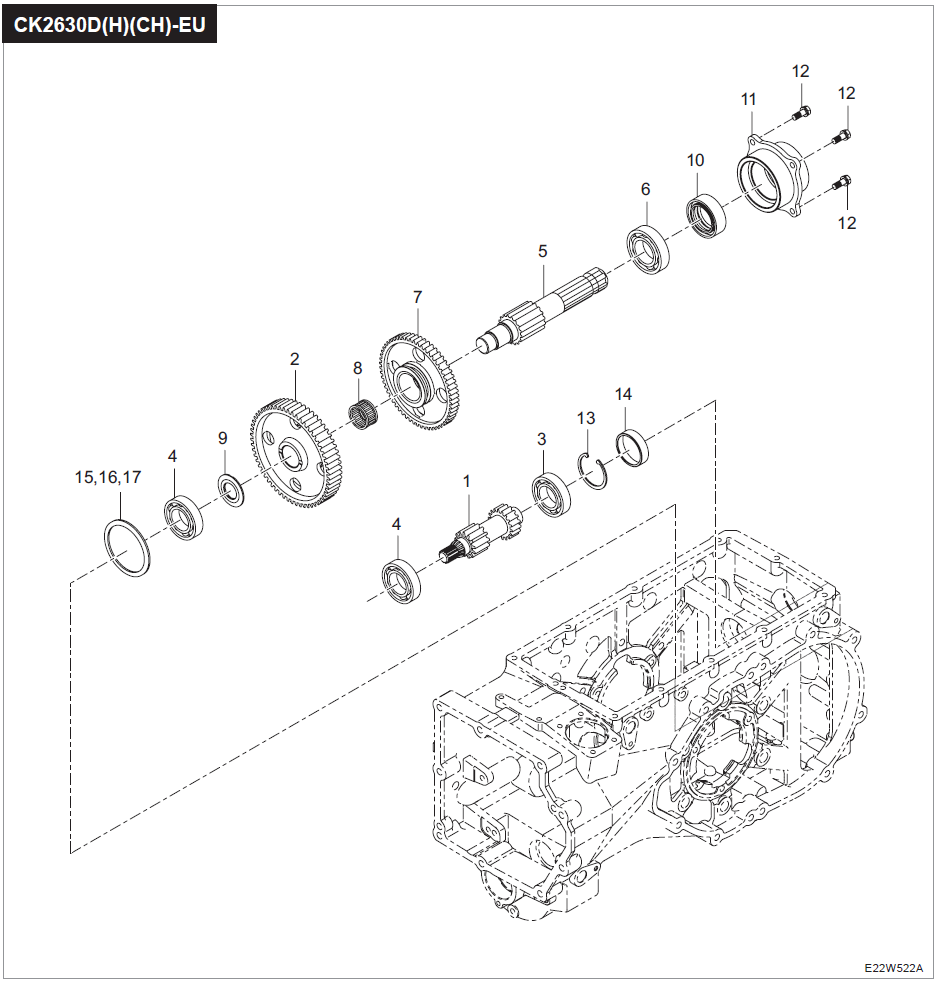

I know this thread is a year old, but I'd really like to get the parts to install the 540E function on my Bobcat CT2540 (Basically a Kioti). I've looked everywhere I can think of and I can't find them. Is there a kit or something? Any help is appreciated!

PTSG, thanks for that info! I think that's the exact same transmission too. Here's a link with some good pictures: KIOTI TRACTOR CK2630 ROPS / Cabin | Middlewich Machinery.
So any idea how I can get the gears and linkage? Or at least a parts drawing with part numbers? Any help is appreciated. Thanks!

Yes, the transmission should be pretty much the same, specially in the PTO area.
I only have the workshop and owners manual for the new CK XX30 series we got in Europe recently. Unfortunately, I don't have the parts manual so I could share with you to figure out the exact part numbers.

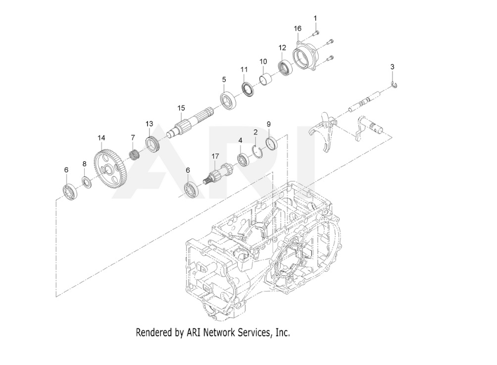

Anyways, I went on Michigan Iron Equip to check the parts diagram for the CK2610 and comparing to the CK2630 and it almost looks like you would only need the big gear and roller bearing that goes with it. Everything else looks like it's already there as the smaller gear for the 540E is machined on the shaft.
I'm using the CK2610 and CK2630 as reference.
CK2610:
CK2630:
From a quick view, part #7 (gear) and #8 (bearing) is what you need. Also, looks like the PTO gearing for the 2610/2630 is different from the 35 and up models.

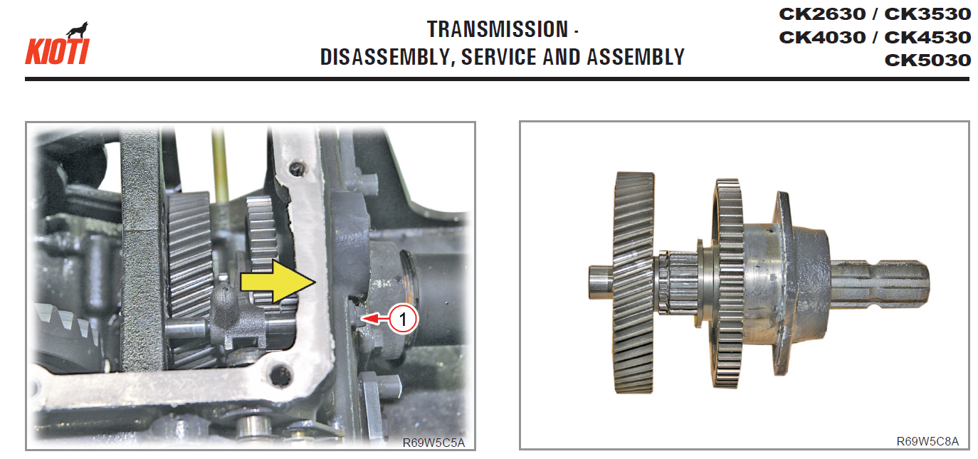

Some more info. I could be wrong but looks like you basically ditch the old shift collar and the new gear becomes the new shift collar and gear all together. I also suspect that there is some sort of stop on the PTO lever of the CK2610 to prevent it from going to the 540E position.

Wow, thanks for all that info! That's really very helpful. I'll also need the shift fork and linkage because my 2540 doesn't have the manual lever because it's electronic engagement with the clutch. There is, however, a place for the lever and linkage. So I'll have to add the sticker, lever, linkage, shift fork, and gears. Now to find part numbers and somewhere I can actually buy this stuff...
   / Economy PTO on a Kioti #20
PTSG, I think that "stop" you're talking about is on the shift fork shaft. It has 3 grooves instead of 2. 540, neutral, and 540E.
