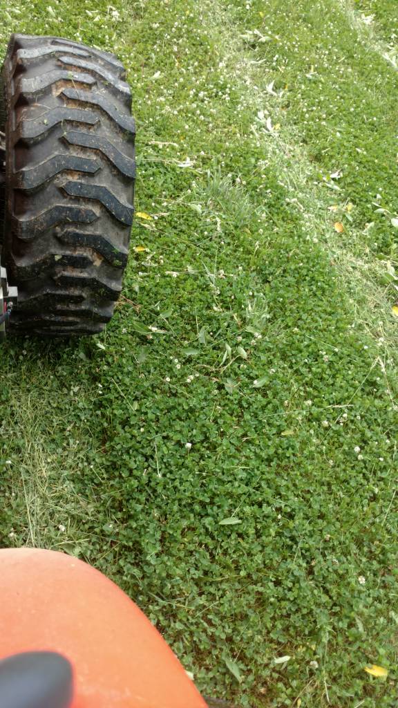

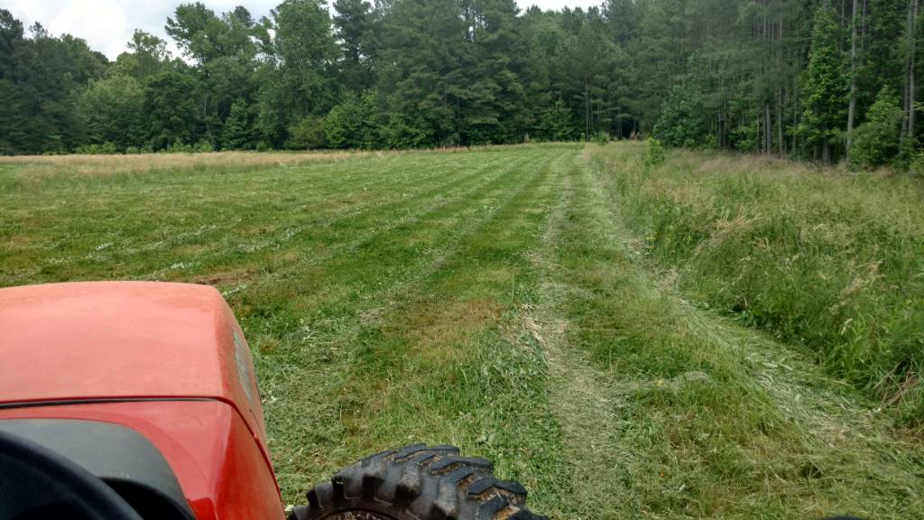

My M7060HD12 with a 6' bush hog in 24" grass will run about 550 PTO rpm at 3.2 mph and do a good job. I can't tell any harder load on the motor, it has plenty of hp to handle it. Loving this machine so far. IMG_20180521_150125898_HDR.jpegIMG_20180521_145950850.jpegIMG_20180514_134730230_HDR.jpeg
