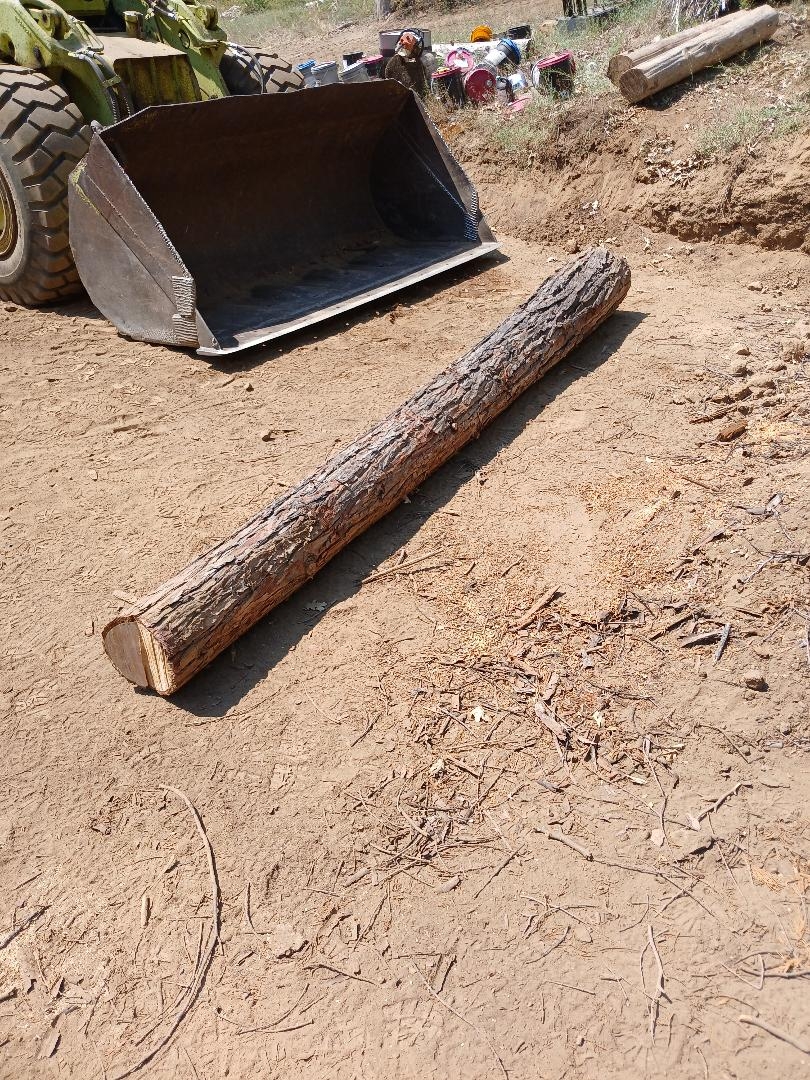

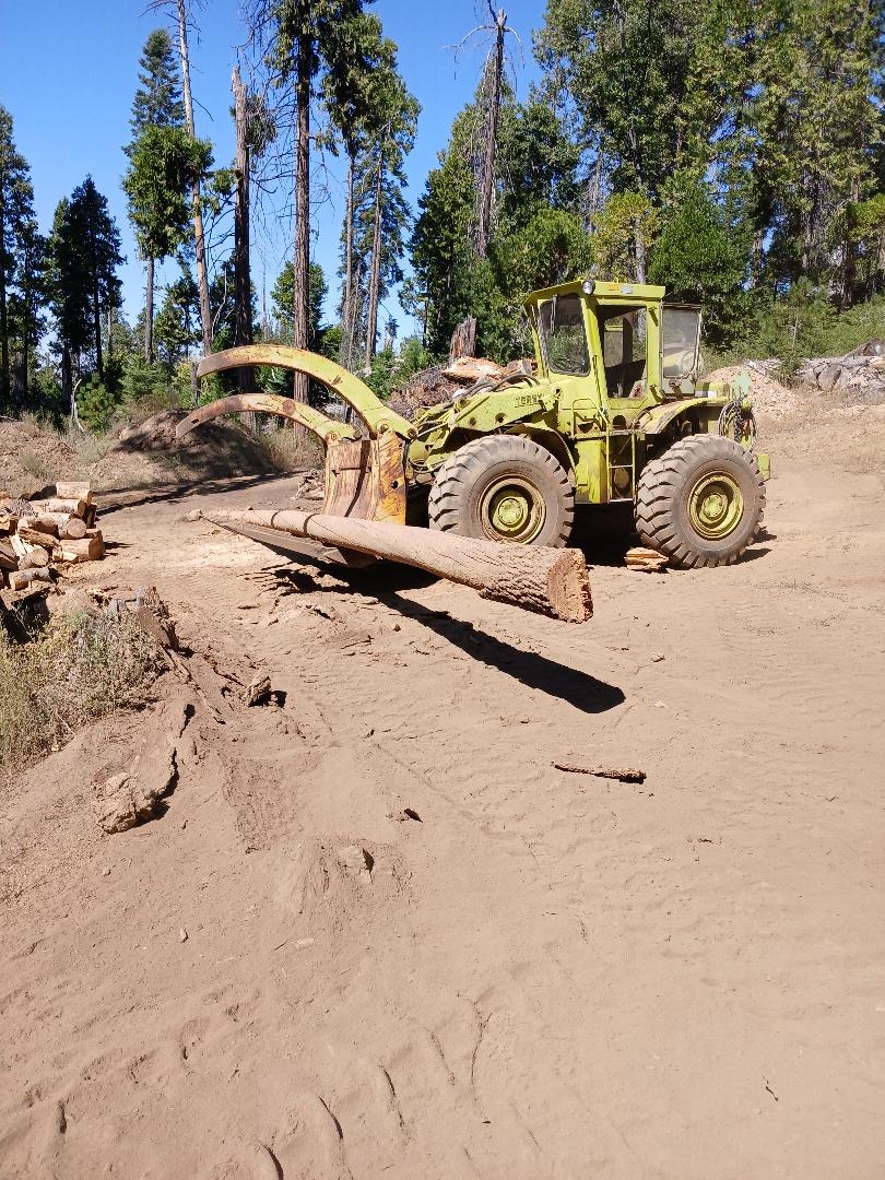

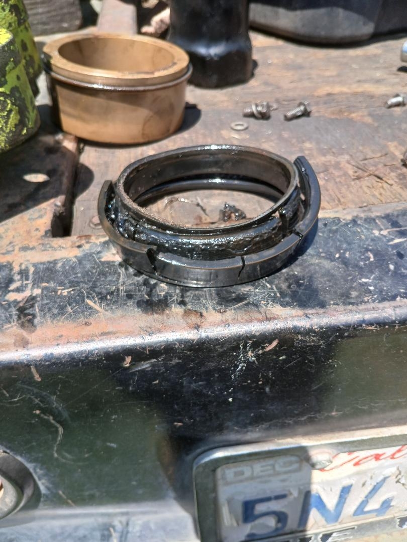

We’ve spent some time up there, but haven’t ran the loader a whole lot. It developed a bad leak on one of the lift cylinders, I’m letting it sit now.
Here’s what Terex says to do about it.

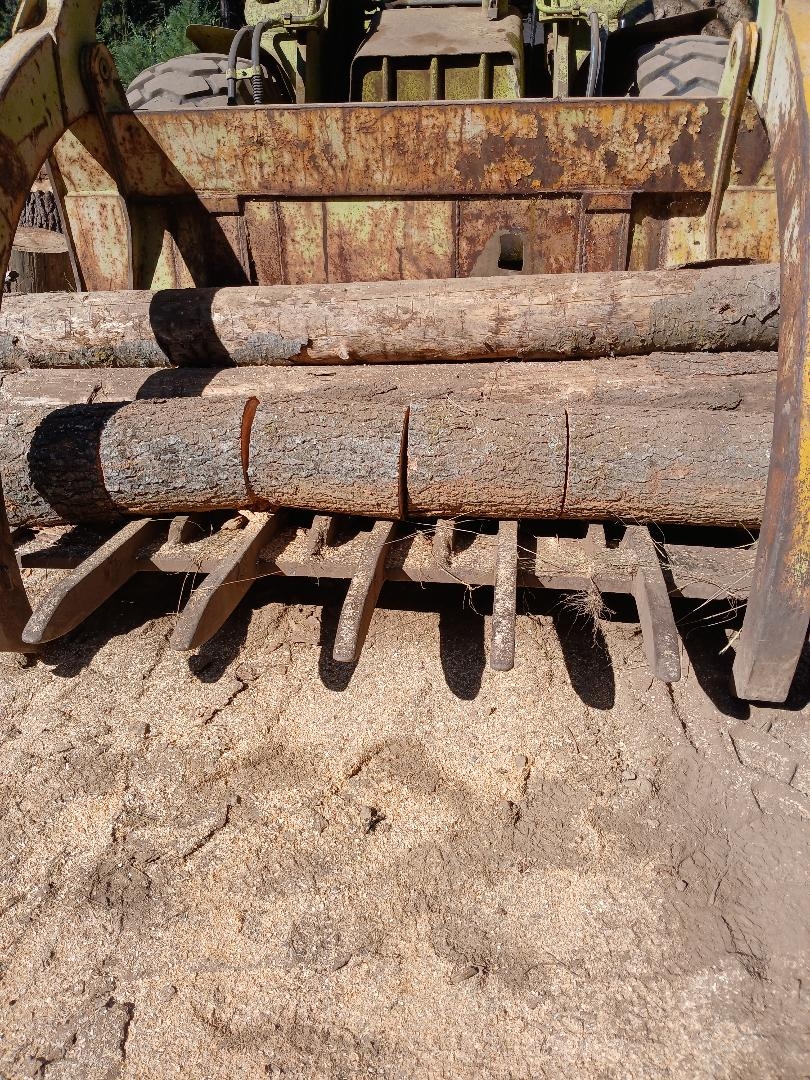

I cut a log to hold the arms up, and plan to have the bucket off like in the image. My son is repairing the tripod, I plan to assemble it around the log when vertical, to hold the log up.
I also improved the spot I work on the loader, it’s actually level now, and wider.
I ordered parts to block off the cylinder and lines while I work on it, it’s a different type than the other cylinders on the machine.

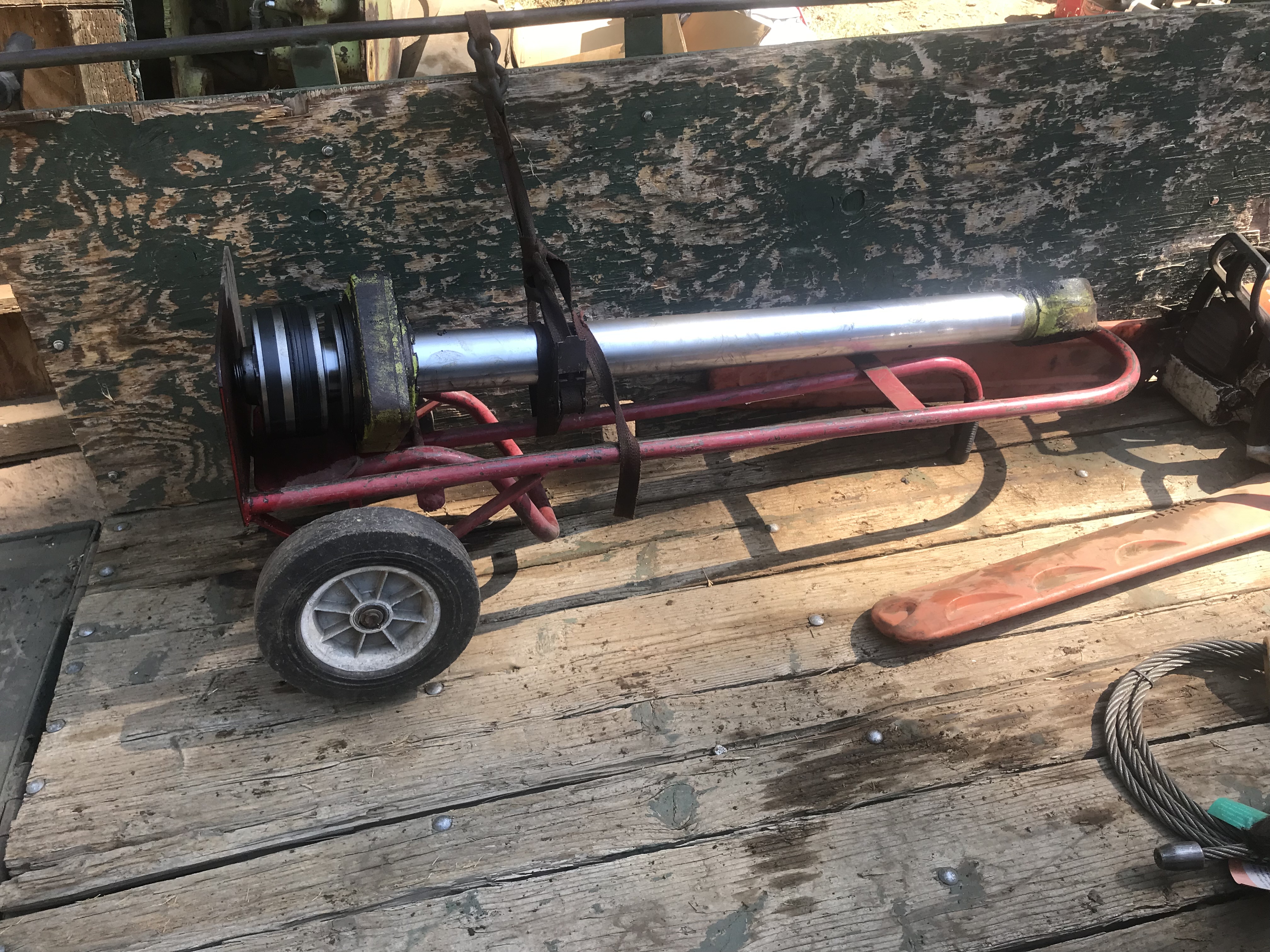

I haven’t been updating this and don’t have time now to explain everything. I’ll just post pictures for now.
   / Ed's 77 Terex 72-41 Wheel Loader #625

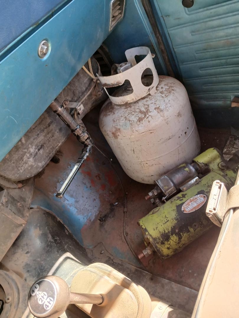

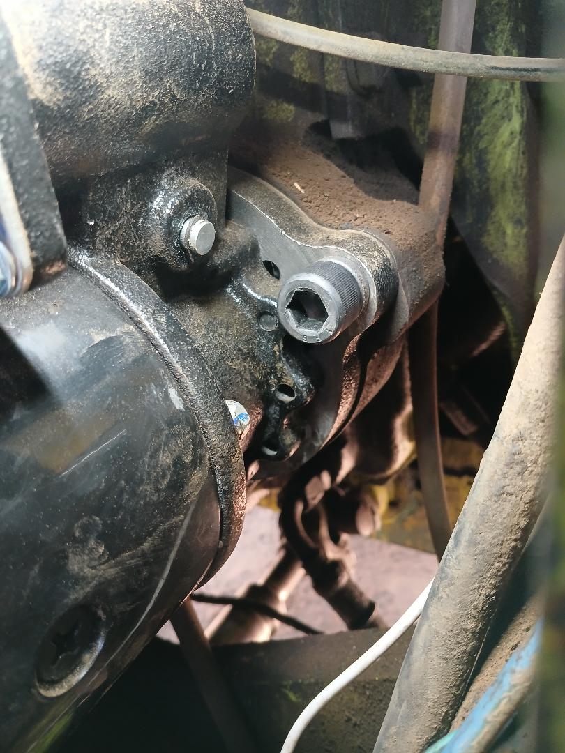

Looks like quite a bit of work, rebuilt a cylinder then it looks like a new starter on an adapter plate.
   / Ed's 77 Terex 72-41 Wheel Loader #627
My last "HD" gear reduction starter came on an adapter plate, I ended up having to re-clock the starter on the adapter plate.
#628
Got the original starter rebuilt, it spins noticeably faster. I don’t hear cranking, it’s just running all of a sudden. I’m hoping this’ll help with cold starts.
