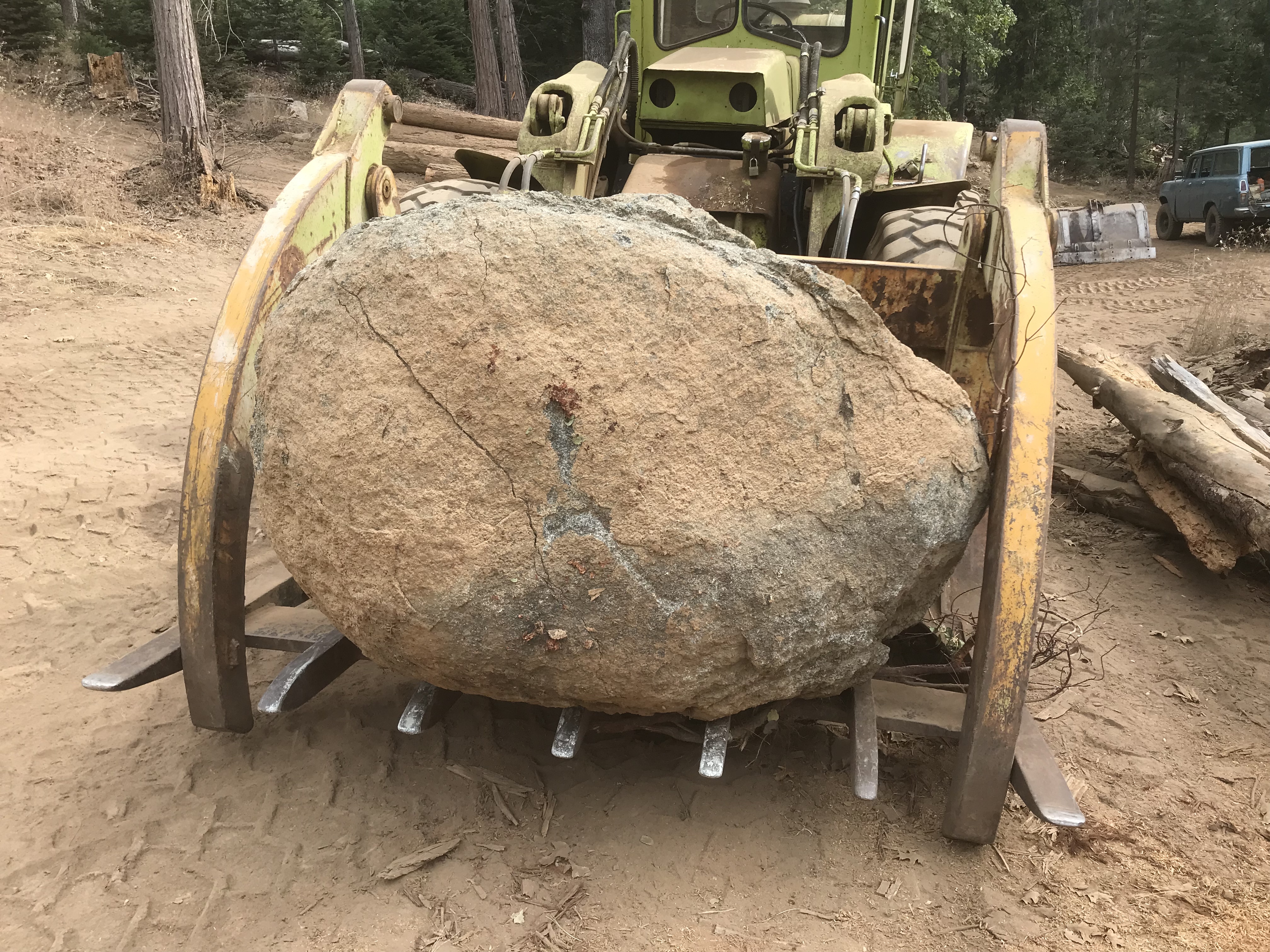

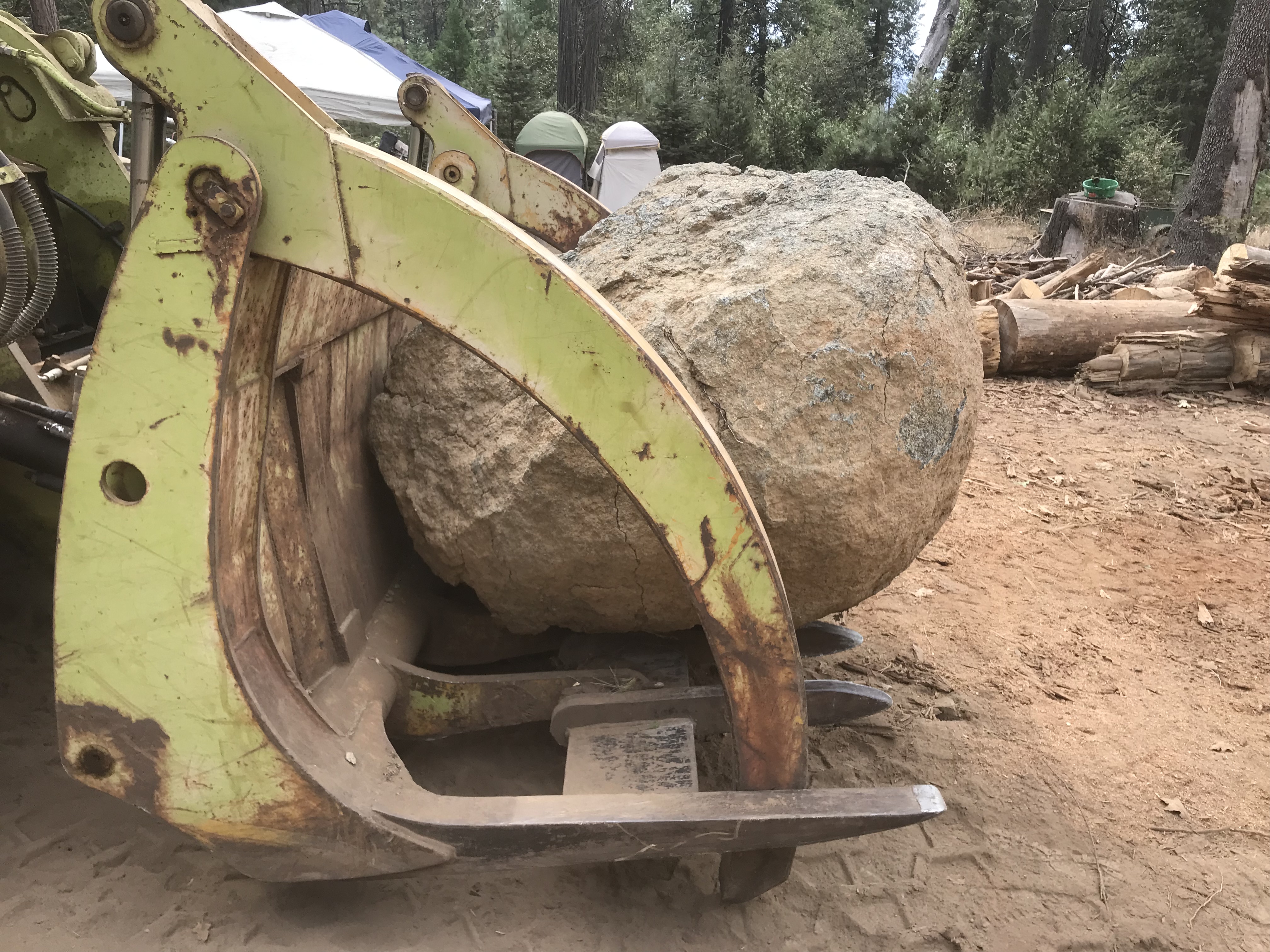

Had to move a rock. A landscaper friend estimated it at 8-10 tons.

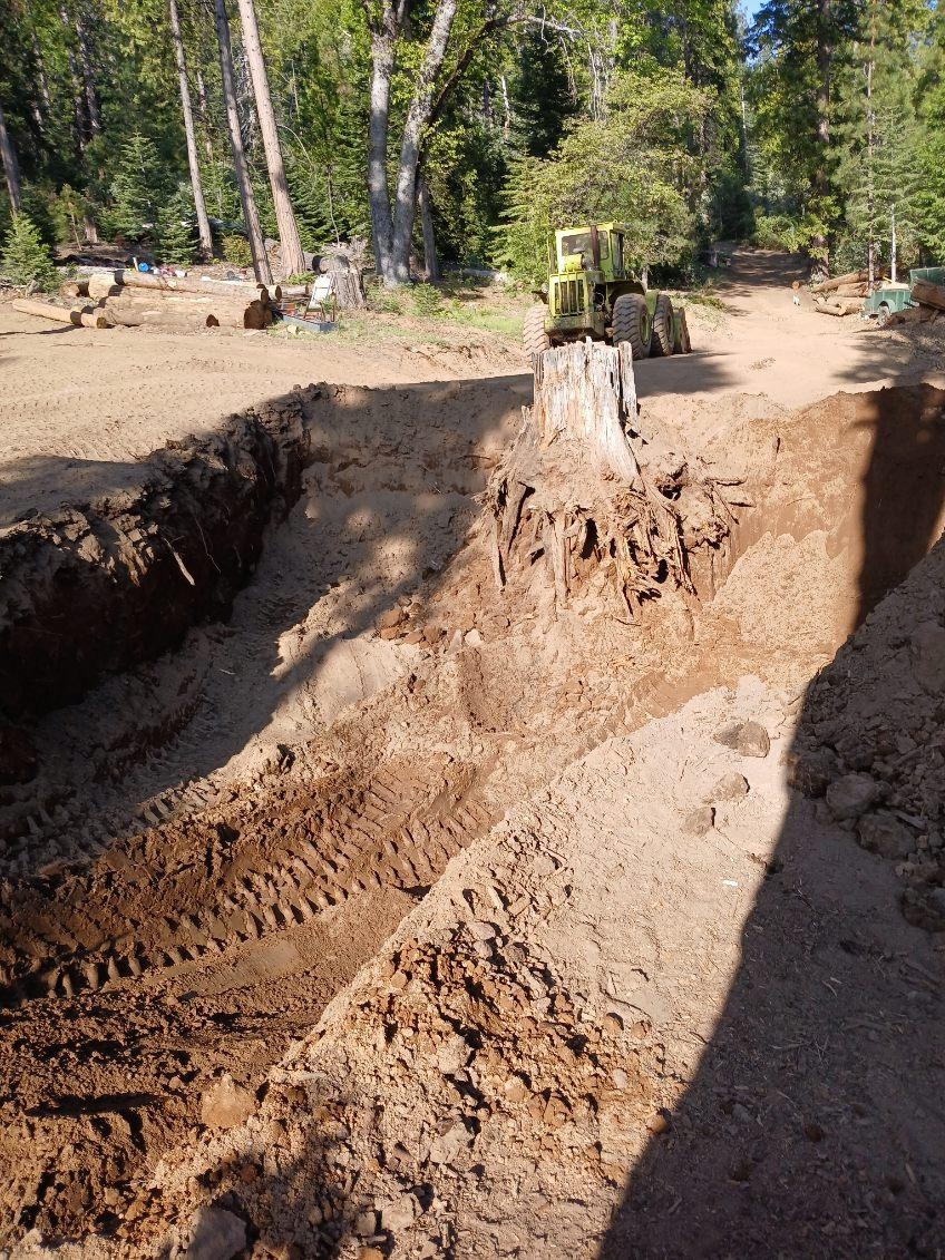

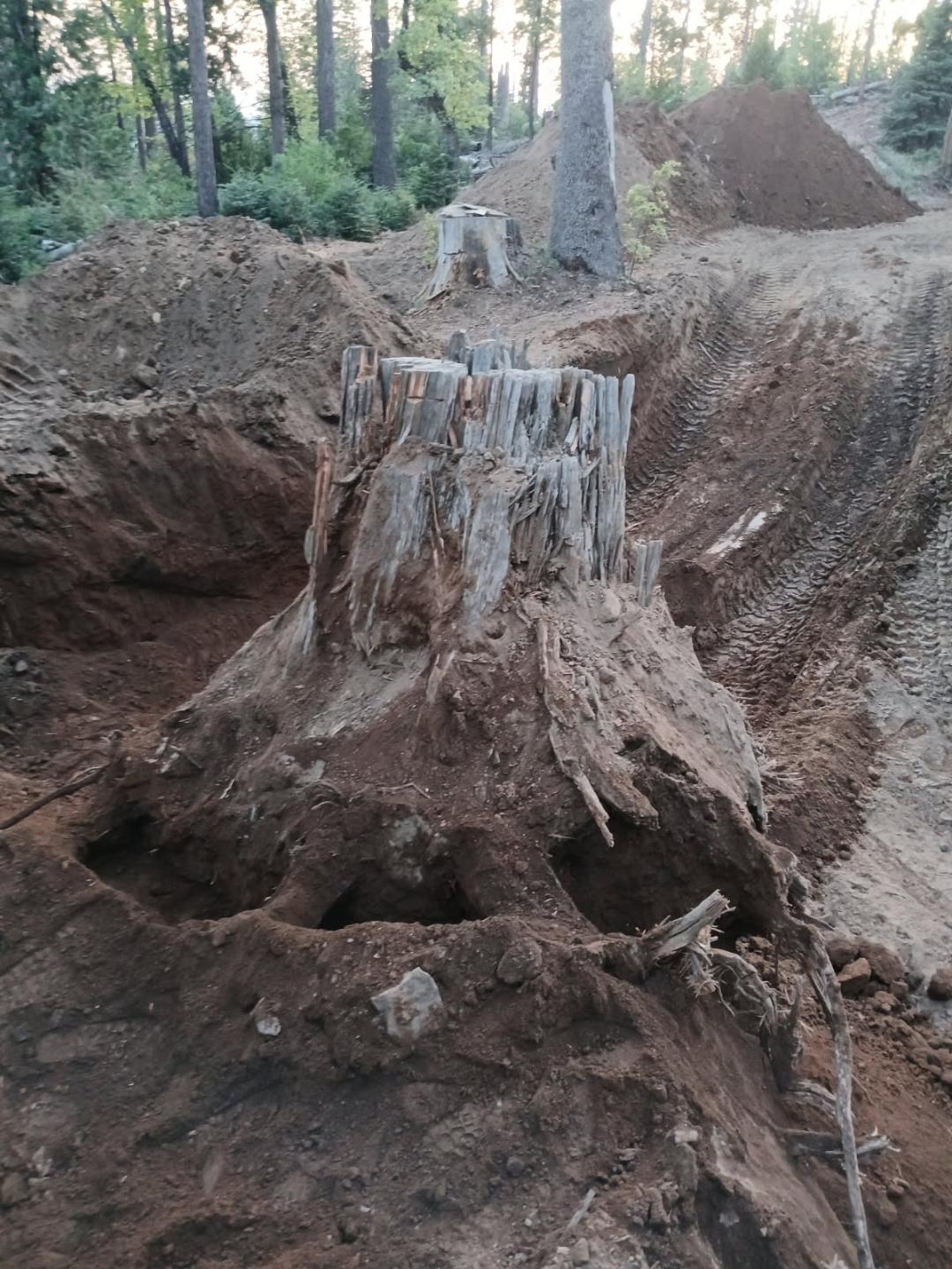

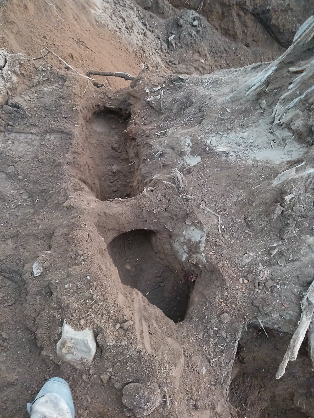

Digging out a stump. I think it’s ready to pull out now, it still wouldn’t budge after digging only two sides. It moves now.
Unexpected bonus, this stump is fat wood.

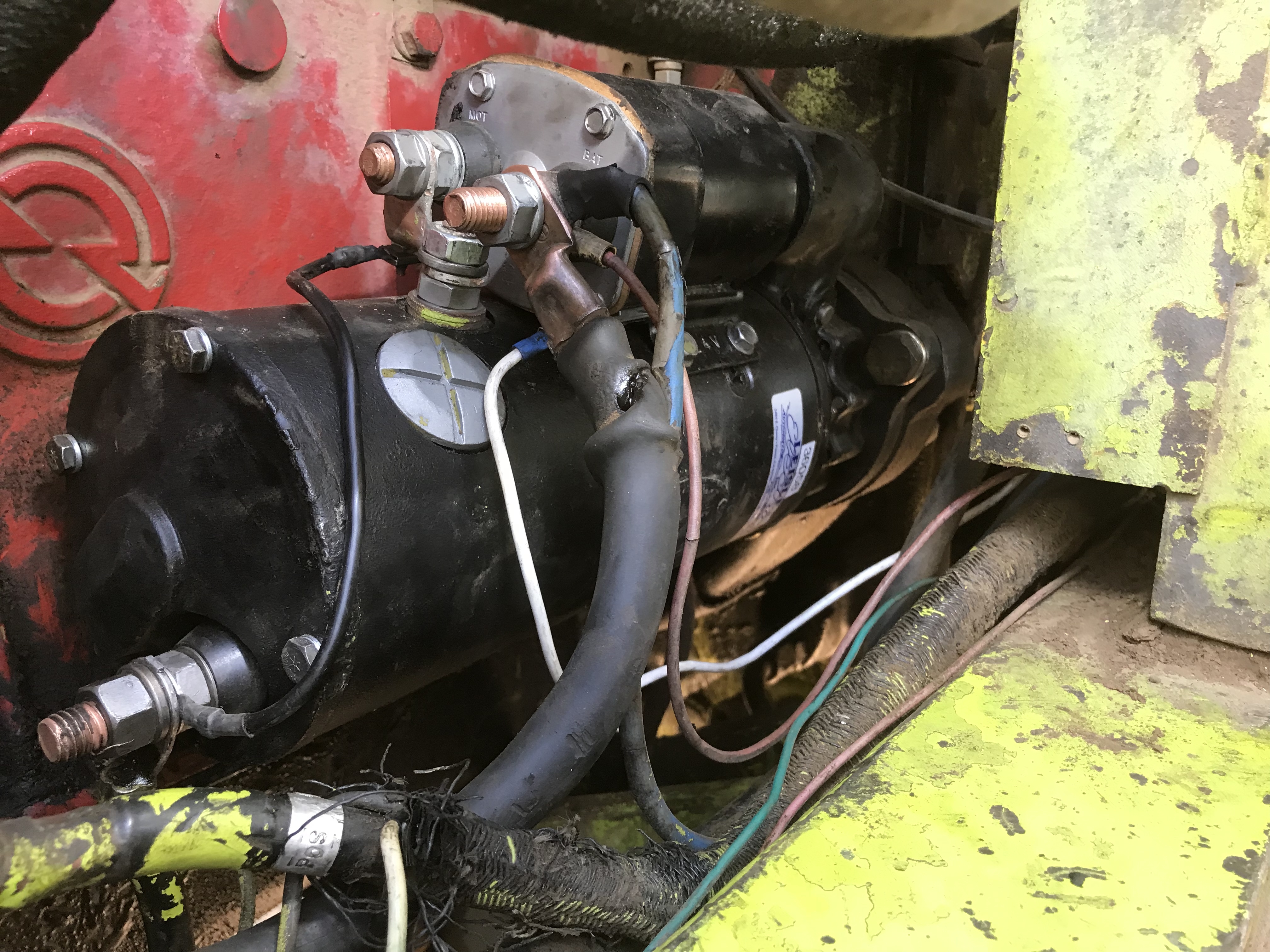

Got the original starter rebuilt, it spins noticeably faster. I don’t hear cranking, it’s just running all of a sudden. I’m hoping this’ll help with cold starts.
I haven’t had to run coolant from another vehicle through to warm the engine before it’d start, since getting the starter rebuilt. Seems it was just cranking too slow.
