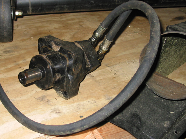

Here are some more - this is the motor I use for the slicer attachment

Hey Duane - the problem I believe is that the main PTO
circuit has Too much flow- it is also larger diameter hose
- The Aux circuit is the circuit used on the 2425 -
the backhoe again has more power than the machine has weight to hold back - basically if you are trying to pry something out that is really caught in there - the backhoe has the power - you need more machine weight - it will drag the machine around - and this is on the Aux circuit which is the same pump for lift / steering
It would be nice to have the dedicated circuit with a switch - I suppose you could plumb this off the Aux before the hoses enter the valve for the quick attach
That would be great - two Aux circuits - that would work - right?
- I want to do this anyway because that is how I plan to run the dump hopper for grass that I have not built yet - this way I don't tie up the quick attach Aux - as long as everything is not running at the same time - shoud be OK right? I would not be dumping the hopper while lifting something in the front or steering
don't really need it for the backhoe though - The clip bracket works fine for the amount of time I use it - which is not that often
