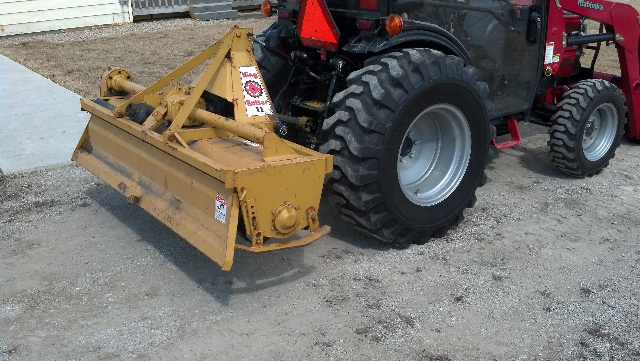

I had to wait a few years but I eventually found a 72" kk on craigslist for $200 and it needed $300 in parts. It was in good shape otherwise. Getting ready to use it for the first time as soon as the ground thaws/dries out.

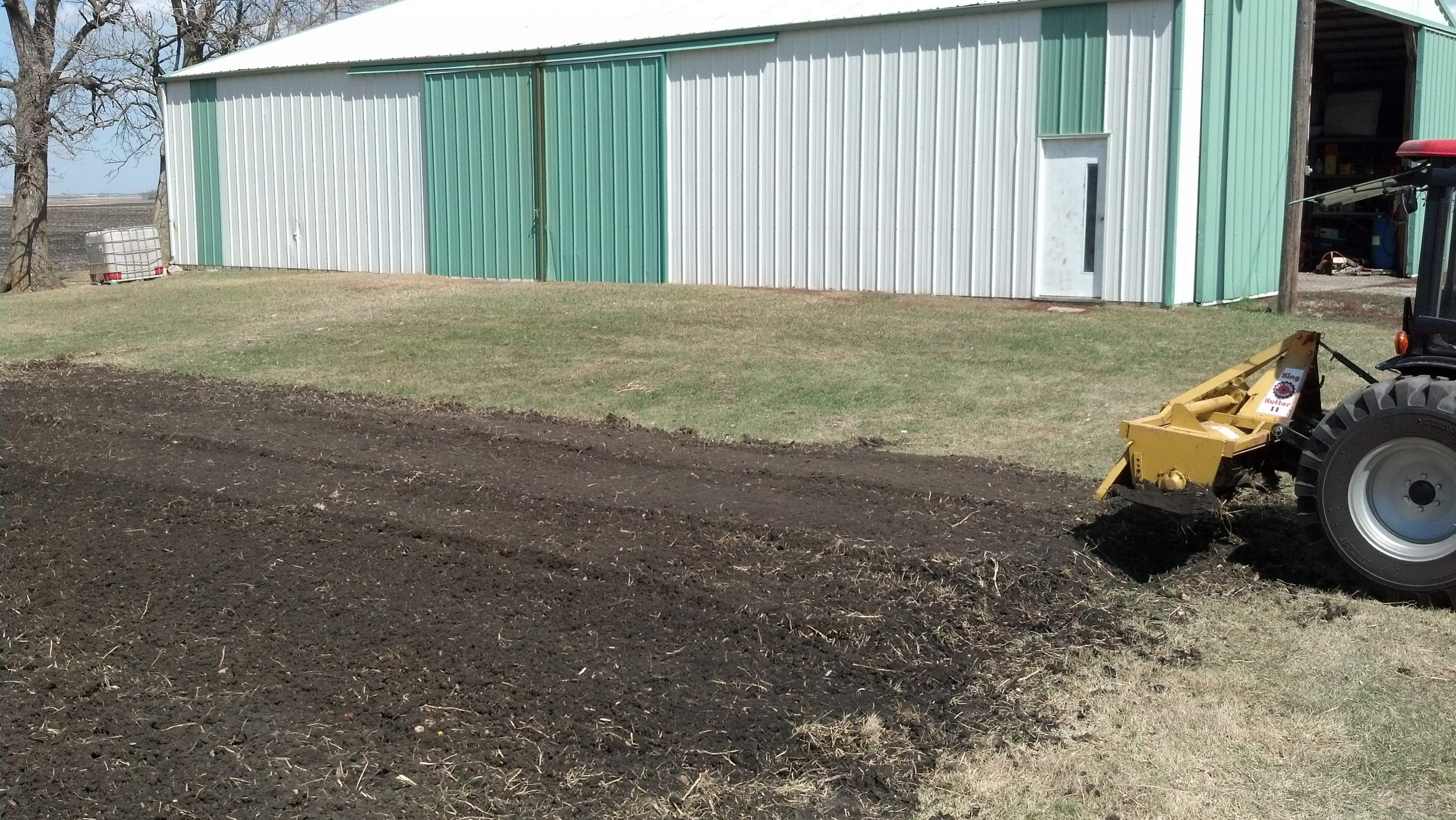

IMG_20140411_141203_412.jpg Update, It worked great. Love how well it tilled up the garden.
