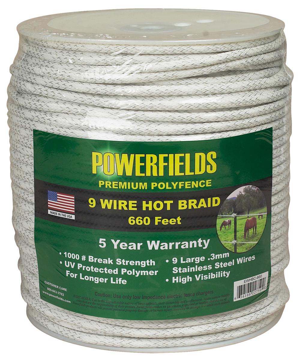

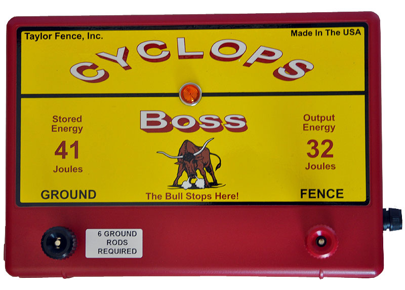

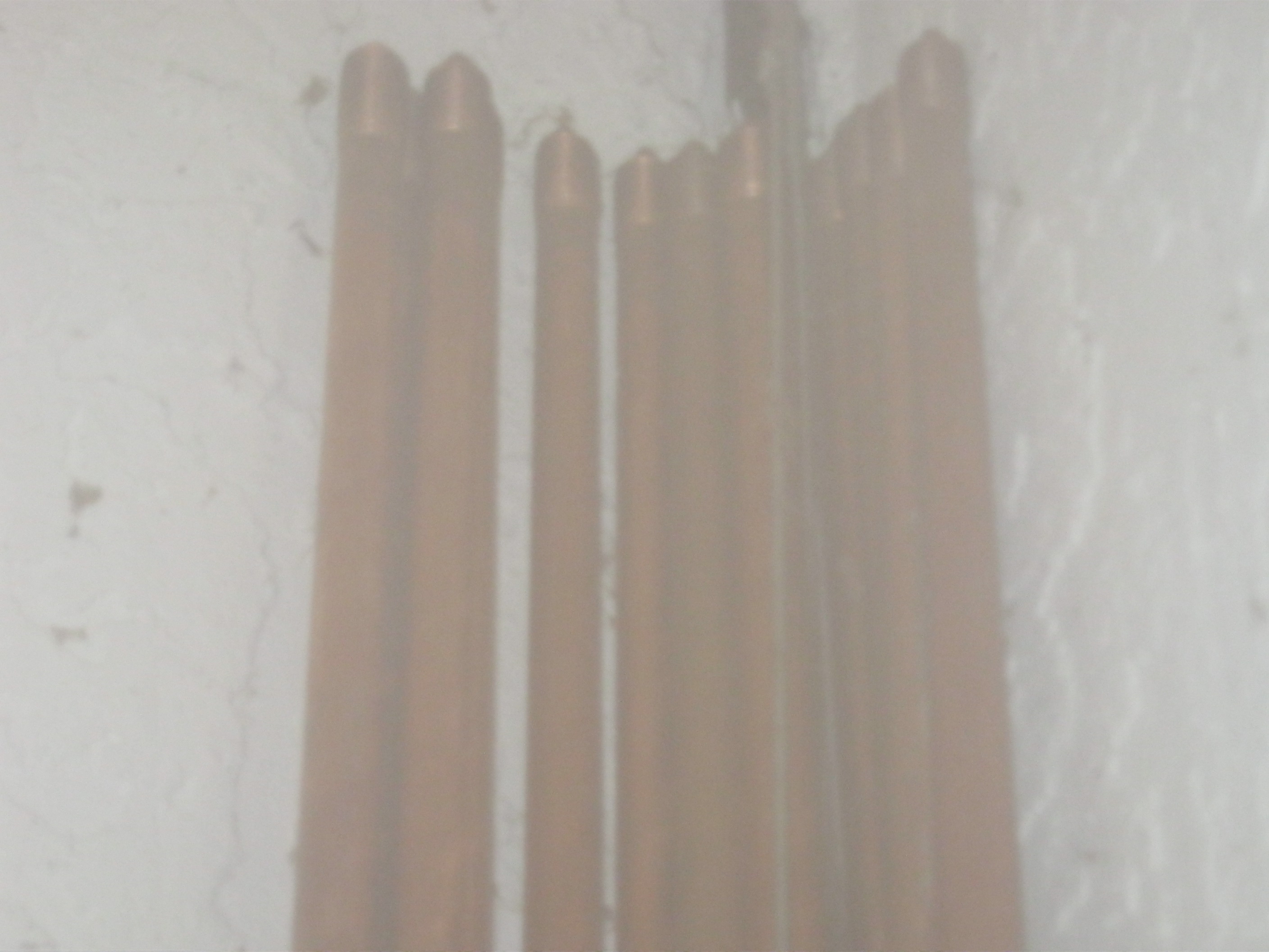

I use aluminum wire (12 g) 14 minimum for smaller areas to confine livestock. For horses I like to use 7MM rope . For lots of bang for the buck I like to use Parmak electric chargers with a minimin 50 mile rateing. On occasion Kencove has great prices in their clearance section. Chargers should use 3 ground rods /10 feet apart. Might sound like hogwash to some but I like to also install a lightning diverter (3 separate ground rods for LD also). Kencove has some videos explaining installation. Along with other good brands mentioned above the Taylorfence.net - AC Fence Chargers also makes some kickbutt units .
