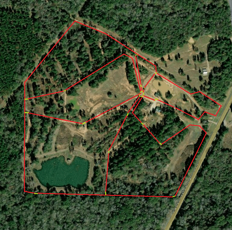

You might want to think about where you put water access, and having some one way gates. If you have centralized water, your cows will come to the water at least once or twice a day. If there are one way gates, say at your circle with water there, you can arrange it for the cows to move themselves, once they learn to push through the one way gates (prop it partially open to train them to push in). Rousting out a recalcitrant mother and calf out of a pasture gets old.
If you plan on feeding at the barn, consider concreting over the entire feeding space and then some. It will make keeping the area clean much easier. Also, consider designing things for feeding the largest bales that your tractor can unstuck and handle.

The shorter the distance they travel for feed and water the better weight gain.
The smaller the pasture the better the grass utilization, small pastures 2 to 5 acres with water especially with cow numbers.
   / Educate me on having cattle #124
That's very similar to what I was describing our friend has done with his place, only his is all rectangles and right angles, and he has about a 100' long alley between all of them with gates to a corner of each pasture and his barns. His water is all at the outside of the barn, so that stays open anytime the cows are in a pasture so they can walk over and drink as desired. And if he has to, he can just shut them in the immediate area of the barn, which is probably 75x75.

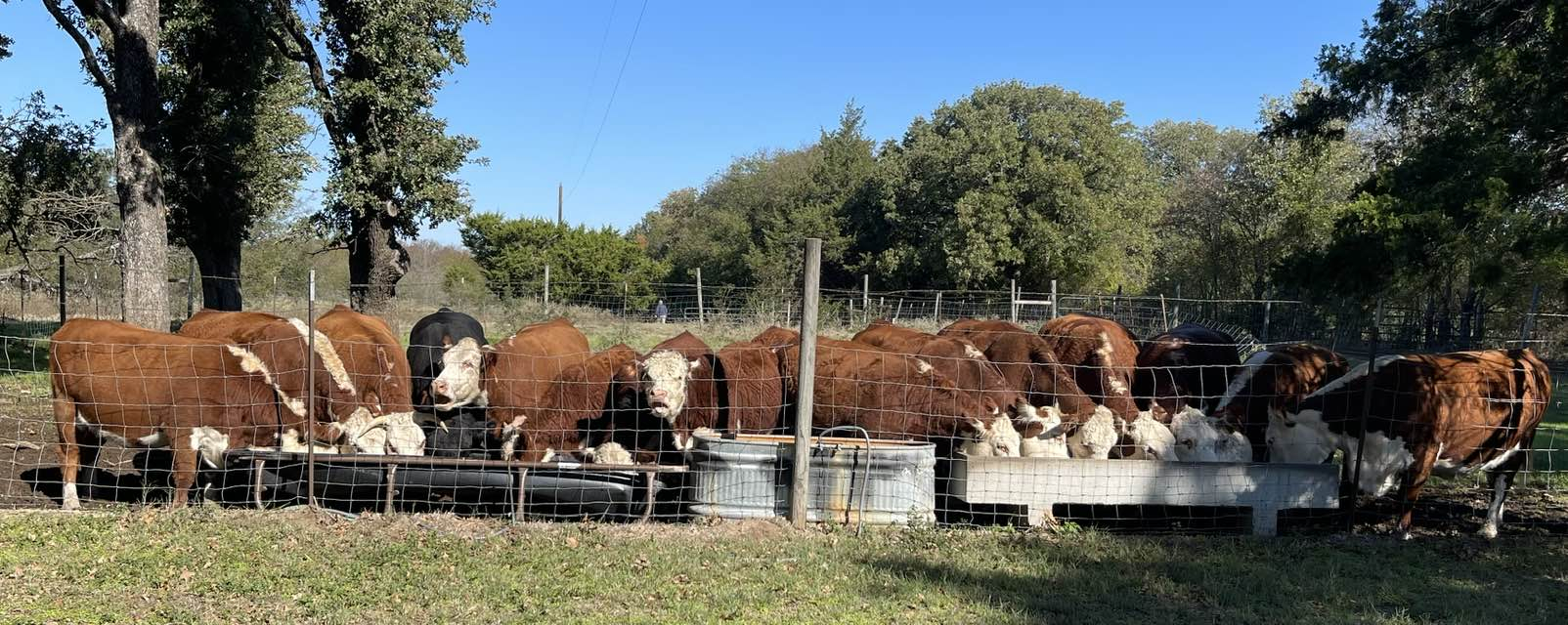

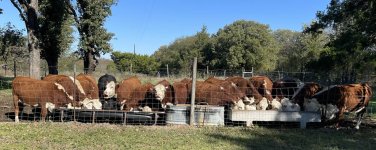

A friend of my brothers helped us with the cattle. He came over and showed us how to load them up in his trailer. Then we took them to his place where we worked them. He has a very nice set up to handle large numbers of cattle. They where all weighed and then given shots according to their weight. We put new ear tags in them and sorted them into several different groups. The six that we are keeping, the bulls, and the ones we are selling. They are all in good shape, maybe even a little fat. All the cows and heifers are pregnant with calves due around Feb to March. The heifers where 800 to 850 pounds. The bigger girls where 1,200 to 1,600 pounds. The angus weighed 1,650 pounds and he looks to be 3 years old. The plan for him is to put some weight on him and sell him as a breeder. We brought the six back to my brothers place, and I bought some minerals for them. He had a mineral feeder, but it was empty.
This is them at my brothers place after I gave them some Creep to get them into the pen. I moved the feeders to the fence so we didn't have to go in there with them. They are gentle and I'm not afraid of them doing anything, but they are also pushy at getting to the feed, and it's slippery with mud in there. This just made it a lot safer. Karen, slowly kept them fed while we got the panels in place to get them into the trailer.
   / Educate me on having cattle #126
One caution with the feeders up next to the fence they are liable to crowd around and get to pushing and shoving for the feed which will be rough on your fence. The cows are not likely to be very aggressive when being fed other then trying to get there greedy noses in the bag or bucket while you are trying to feed them.
I would be more careful with the bulls not because they are "meaner" per say even though they can be, but they are stronger and are more likely to injure you unintentionally. In a group they are not as aggressive as individually.
