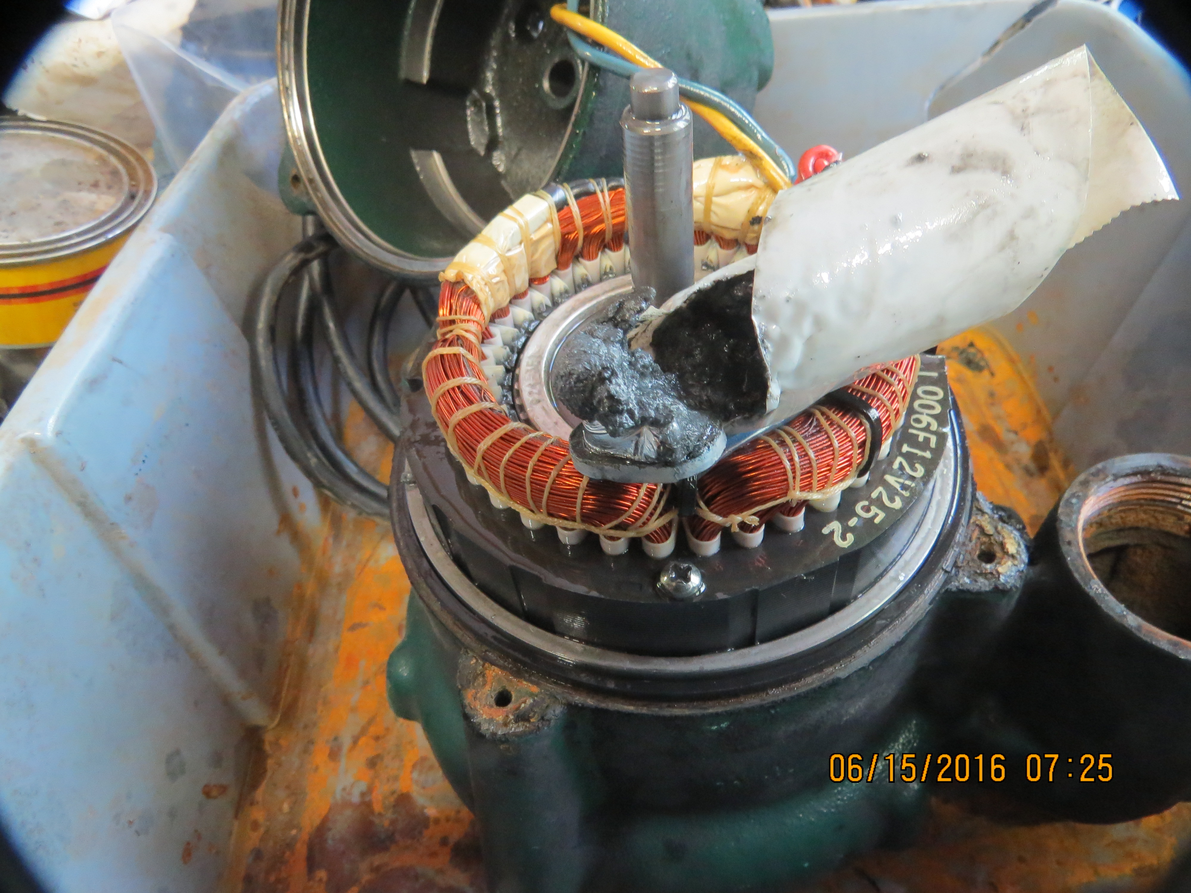

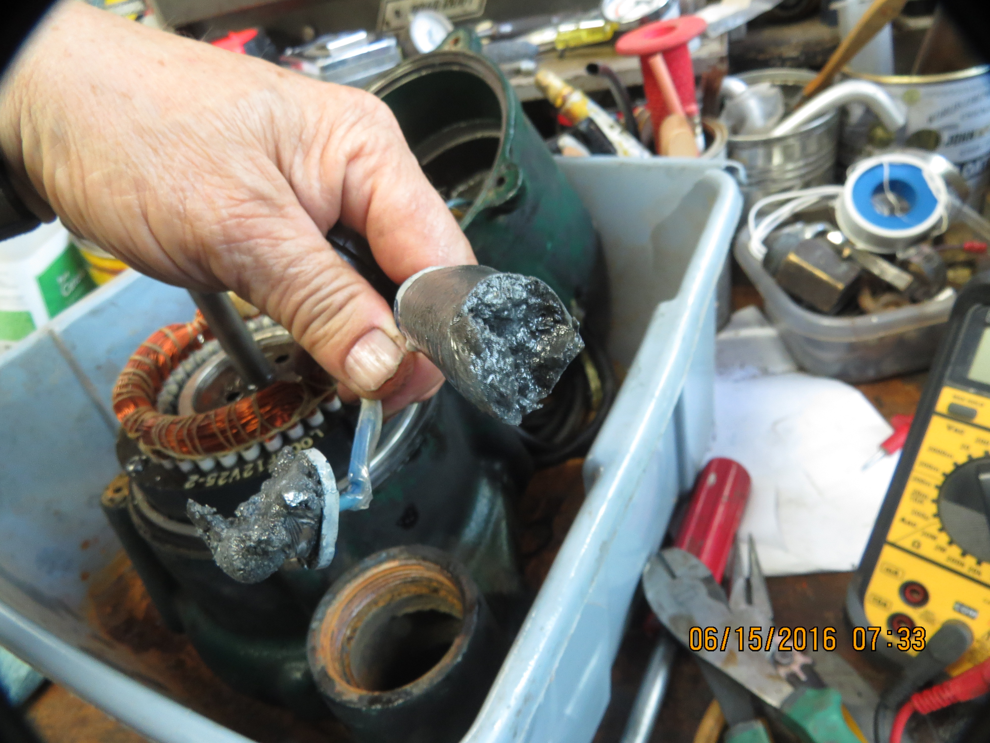

Maybe someone here has a clue. I pump effluent 500ft 12 ft uphill to my septic field. I have a duplex pump system with an alternating relay with a second pump alarm. The pipe line is 2". The pumps run around 5 min every 2-3 days. So each pump runs maybe 5 min a week say 5 hours per year.
They are .5 hp 230volt 1 ph pumps. The 12 foot head is well within the pump curves. There is a weep hole to drain the head on shut down. Some of the pumps have weep hole in the base. I have had 3-4 different manufacturers of pumps.
The problem I have is the failure of the pumps. fail to start. Resistance across the two power leads is ok 6-10 ohms. When I open one up usually the centrifugal switch has failed. Out of warrenty of course. Oh yeah 3 years is about average although one lasted 15 years. This is down a 9 foot confined space and I have been doing this for 20 years. Today I replaced one and banged the other around working on pipes and then it failed. I am getting too old for this.
Anybody have a clue?

   / effluent pump
Thats pretty much the pump I have. The ones I am putting in now are Meyers 4/10 hp. About the smallest made. The system is designed to pump 250 gallons at a time over the whole field. That's why it runs so infrequently. There are only two of us . I don't think thats why the centrifugal switches are failing.
They are not short cycling which I would expect to cause failure. Maybe the weep holes are plugged and the pumps are starting against a head pressure. That would cause the centrifugal switch contacts and or the starting coil to burn out.. I saw that once the contacts fused shut. Well I have two bad pumps right now so when I open them up I will post my findings

   / effluent pump
Exactly total submerged in the worst stuff. They are supposed to be otherwise they overheat. Although it is hard to see overheat in a 5 min run every 3 days. Methane, hydrogen sulfide and one other I can't remember. I posted here a few years ago about going down into the space. The best answer I got was if a candle burns you are ok. I did that , after I opened up and let it vent for a bit. Candle burned fine. To get rid of the smell and get some fresher air down there I put a shop vac hose down to a foot off the bottom and let it run . Works well. I don't breath throu my nose either. I think there are more fatalities by falling, knocking yourself out and drowning than lack of oxygen. Just a side comment. I would like to rail mount those pumps but that means I have to cut the manhole off, and replumb the bottom. ahh I am 70 I can change pumps a few more times . Does anyone know what that black stuff is that builds up on pipes, pumps and everything else? It is really hard to wash off.

   / effluent pump
Mine was originally spliced in a waterproof box high in the chamber. With pump failures I got tired or soldering and heat shrinking sleeves and the box was not tight anyway. So I drilled a 3" hole through the side of the chamber very high up and installed a 2" PVC conduit to a new box out side. Put outlets in it and plugged in the pumps. The box is not deep enough for straight in plugs so I cut them off and used right angles. Makes it easier to feed the linecords through the conduit as well. caulked all the feed through spaces. Two of the float switch line cords are still spliced in the chamber box, they have not failed in 20 years so leave alone. The third switch connection corroded at a bad splice and I ran it through the new conduit. I had condensation in the control box in the winter so I put a short heat tape around the inside. Took care of it.
I have yet to take the first failed pump apart. later this week. These pumps should really be rail mounted so they can be pulled out from the surface.
