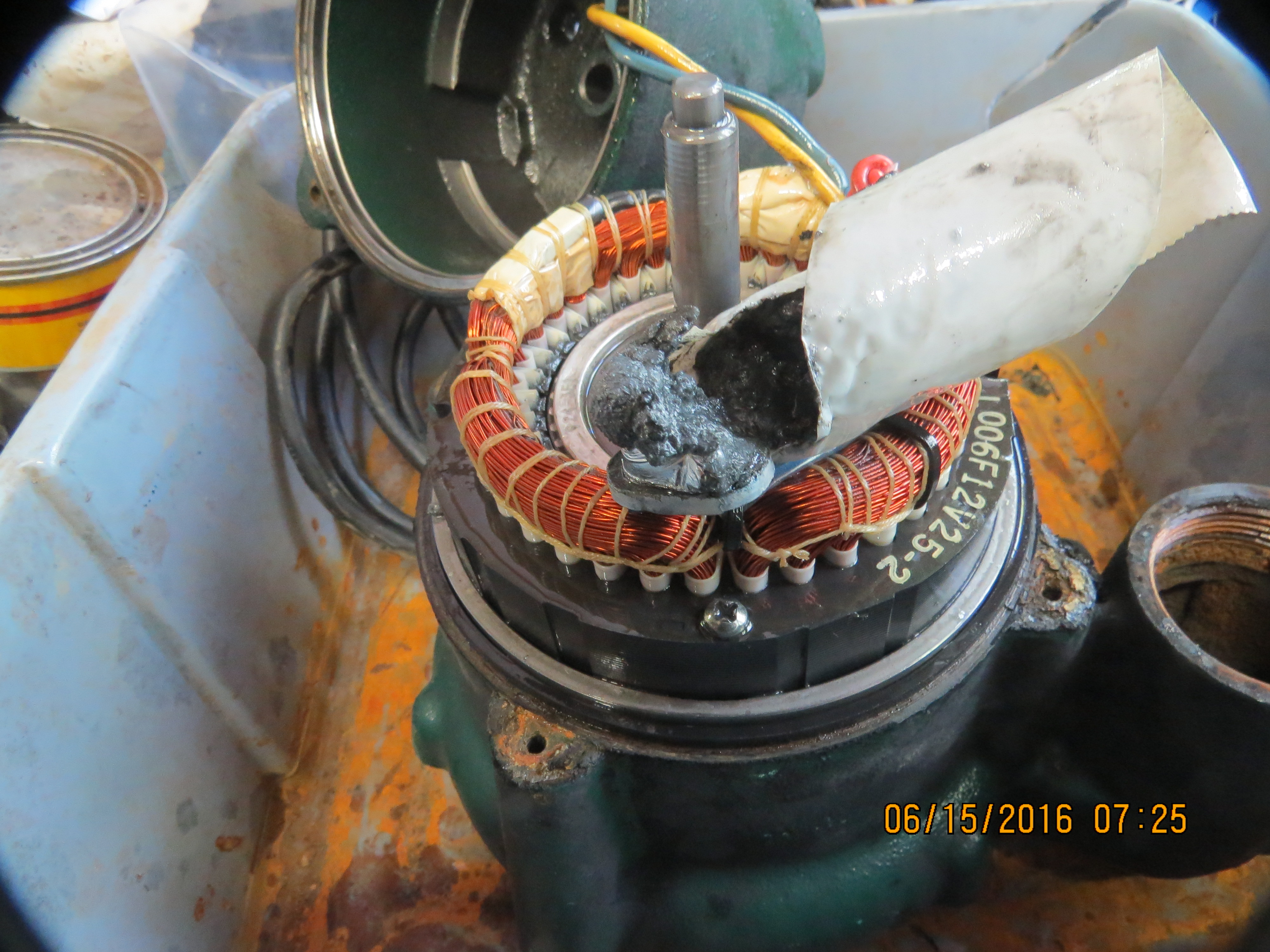

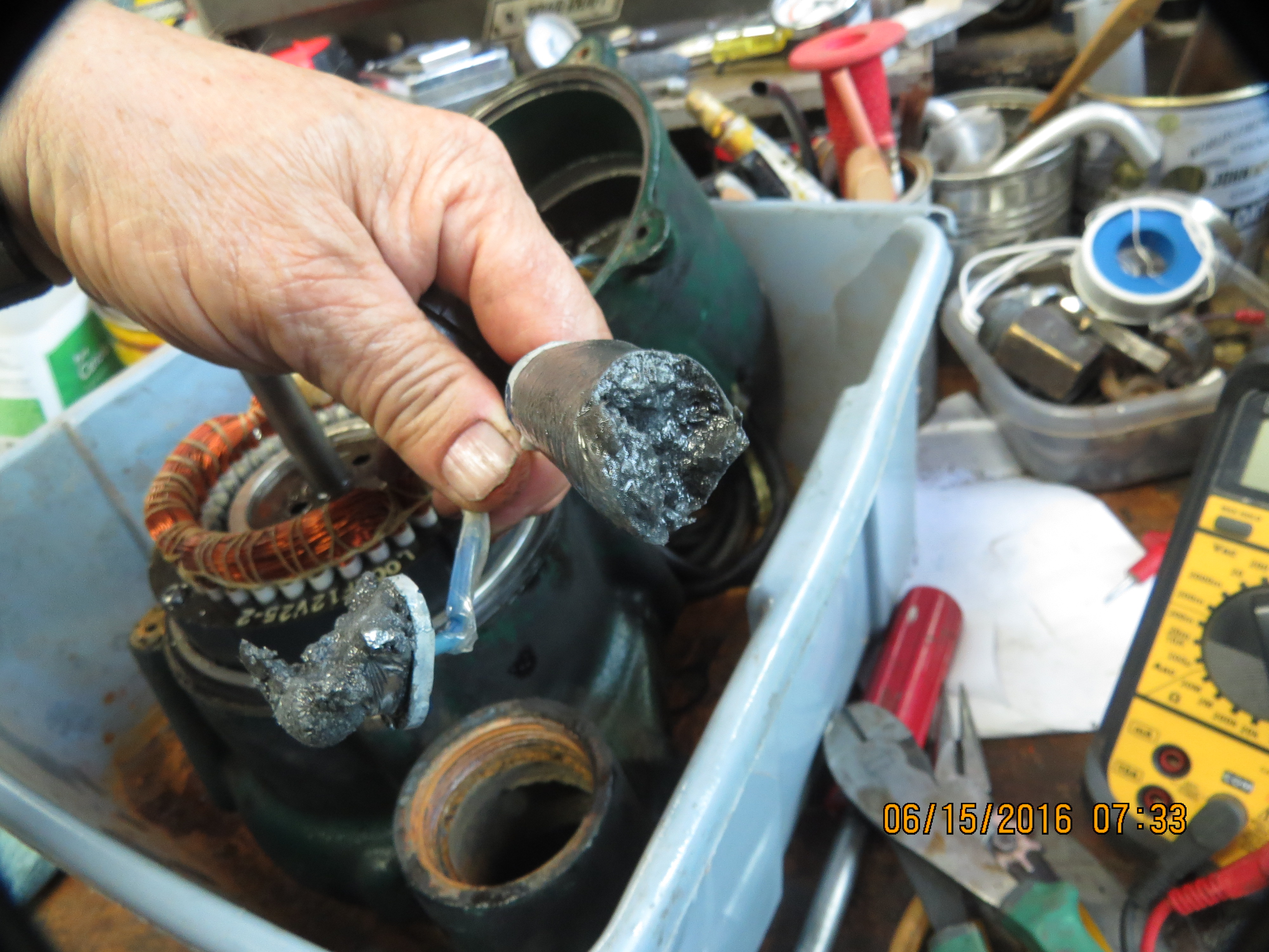

I opened up the Zoeller pump. Impellor turned freely ,Upper section with power feed through, clean. Drained oil from the next chamber , which had a lot of grey particles in it, not a good sign,
Second chamber popped right off.Clean of effluent however the starting capacitor, no centrifugal switch, was blown right in half . Hmm $500 pump, Grey grit distributed all thru bearings and close distance between stator and rotor, got to get capacitor and connect with oil tight connections, got to get clean oil and some how flush the motor case, and hmm how long would it last. Meyers are $260 scrap it. Now why did the capacitor blow. Heat not likely pump is immersed in water 100% of the time. Impeller jammed it was not. Load on the pump well could be but even if the weep hole did not drain the pipe , and this is for freeze prevention not unload the pump, it's hard to see a centrifugal pump like this failing under a 12ft column of water . It only 6 psi in a 2 inch pipe. Lets see if I can post a picture IMG_4014.JPGIMG_4019.JPG

Wow, I'm really suspicious of your power source to the pump now. I'm no electrical guru. Once you got out of the plumbing calcs, I'm out of my league....

Funny The capacitor was made in Mexico.
grainger $52 for capacitor plus shipping
light weigh mineral oil I am guessing $47/gal plus shipping
This is just for kicks I am not going to try and save the pump. I could do everything but get all the gunk out but who knows when it would fail again.
I will post again when I get the new meyers about a week and get out the other meyers that just failed.
I was just thinking, If I find a blown capacitor in the meyers then perhaps the pumps don't have enough start hp regardless of the curves . Read bigger pump more $$.

The mystery continues. I have hour meters on the pump circuits. In two years since I read the numbers last the pump that failed ran twice as many hours as the pump that did not fail. And it is a little bit bigger pump. But 24 hours over 2 years is not a lot. . I did notice the the check valve on the opposing side was leaking at the joint. That would do it.
I just spoke with a guy who is a sump motor expert. He said long start times are really hard on start capacitors. He thought the problem was clogged weep hole and or stuck check valve. He suggested taking out the check valve but that would only work with one pump. I don't want to do that so I guess the answer might be a yearly PM on the check valves and the weep hole. Maybe make the weep hole a little bigger.

All right 2 pumps with blown capacitors. $51 for one and $121 for the other. I guess they are submerged in oil so they are pricey. I found same value caps for $6 from Mcmaster carr. Plus some oring material as one swelled. Bad material from China I would guess. The caps are a physically little bigger but there is a ton of room under the hood. Plus no moving parts. One cap had electrical push on tabs in the oil so nothing special there. I strained the oil through a tee shirt filter. It probably not as clean as new and maybe the lower bearing will wear out sooner. But one of those pumps goes for $1000 now the other is $500.
So For $30 I will see if they run. If they do good for hot standby short term spares. The pump I am using now is a Meyers at $260 but it takes a week to get it.
I have one Meyers not running now and the new one just came . So when I open that one up I will post whats what.
