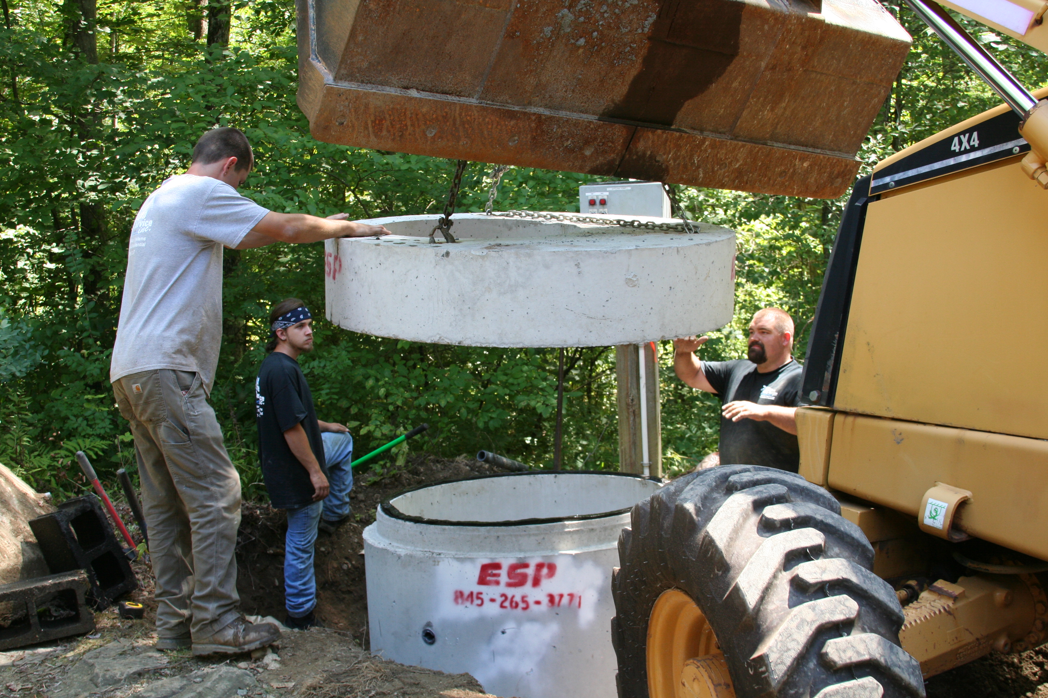

Here is the end of the story. Don't believe the pump curves especially for cheaper pumps. I am too old to keep going down into 9' deep pump chambers.
Hired a pump guy. Remove the top manhole adapter 1300# replace with 4' diam x 3 foot riser and lid . Install 2 rail mounted 1/2 hp high head pumps with integrated checkvalves. i,e pull the pump from the surface and everything comes out. 3 year warranty on the pumps. New float tower with 3 new floats.
Looks like 4k retail for parts and 4k for labor. I started thinking I could do this myself but then I thought why . Besides my wife gets a sticker on the alarm panel with the pump guys ph no. Something happens to me no issues. Easier to sell the place if it ever comes to that.
Pump guy also said he likes 1/4" weep holes as long as the pumps are big enough.

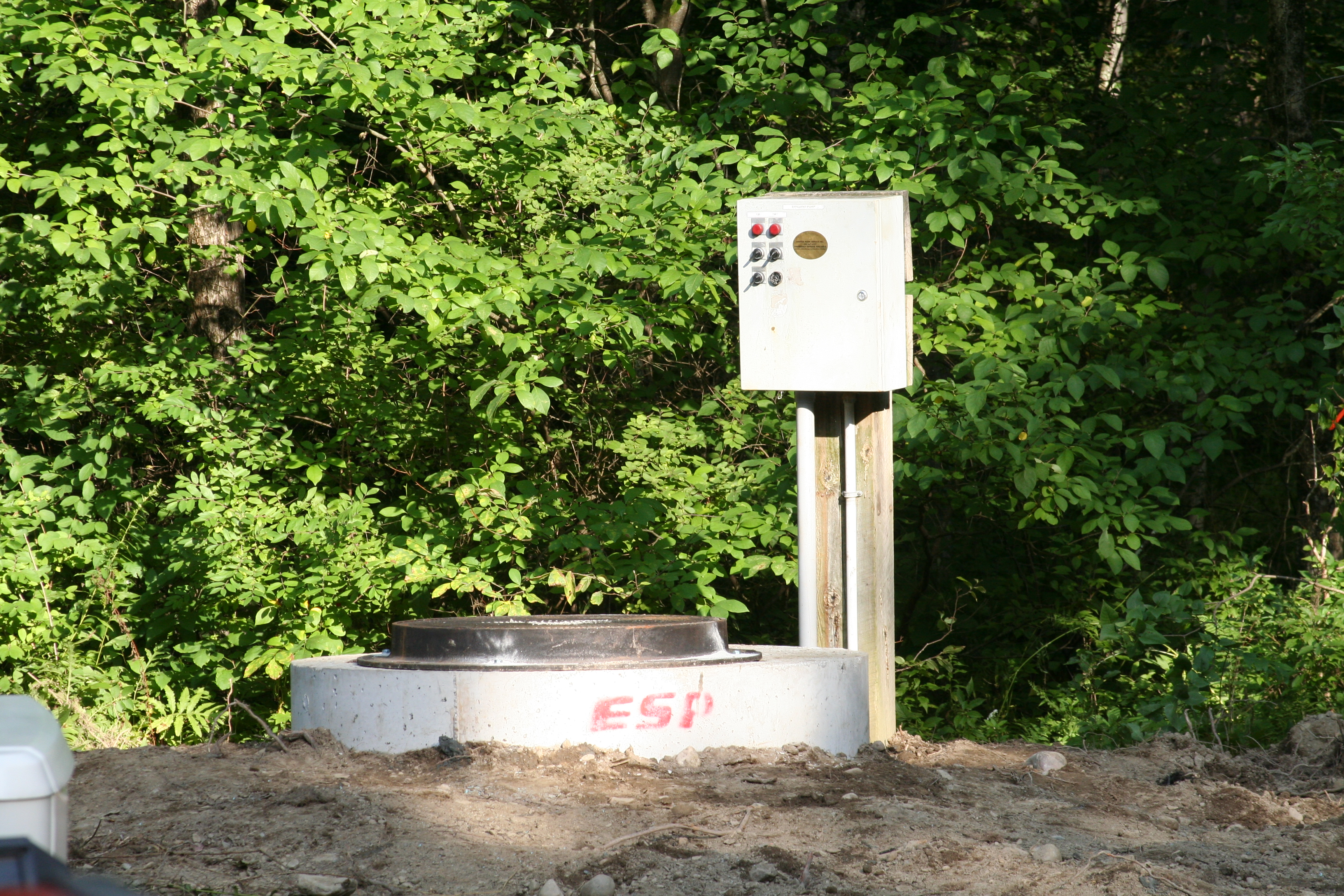

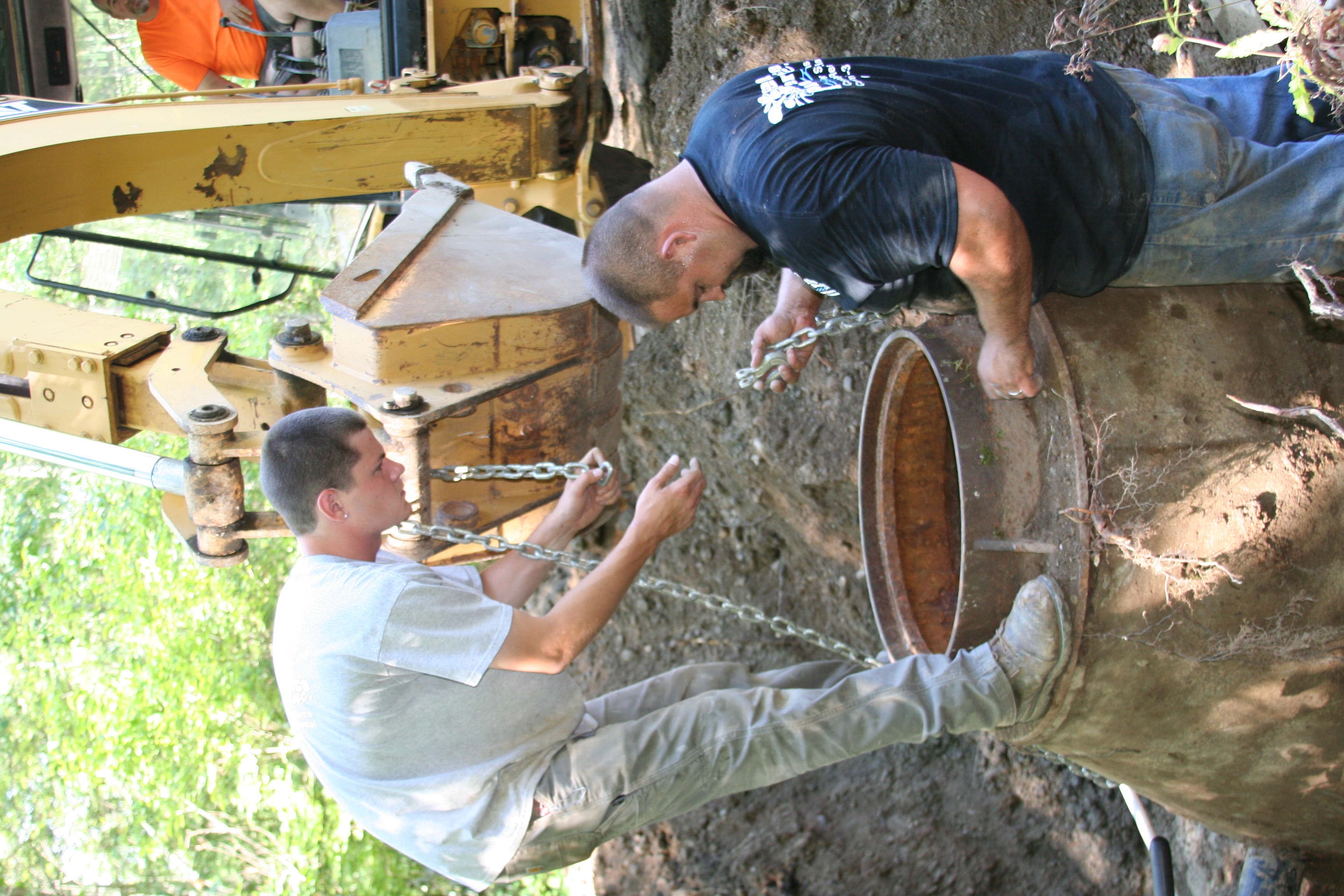

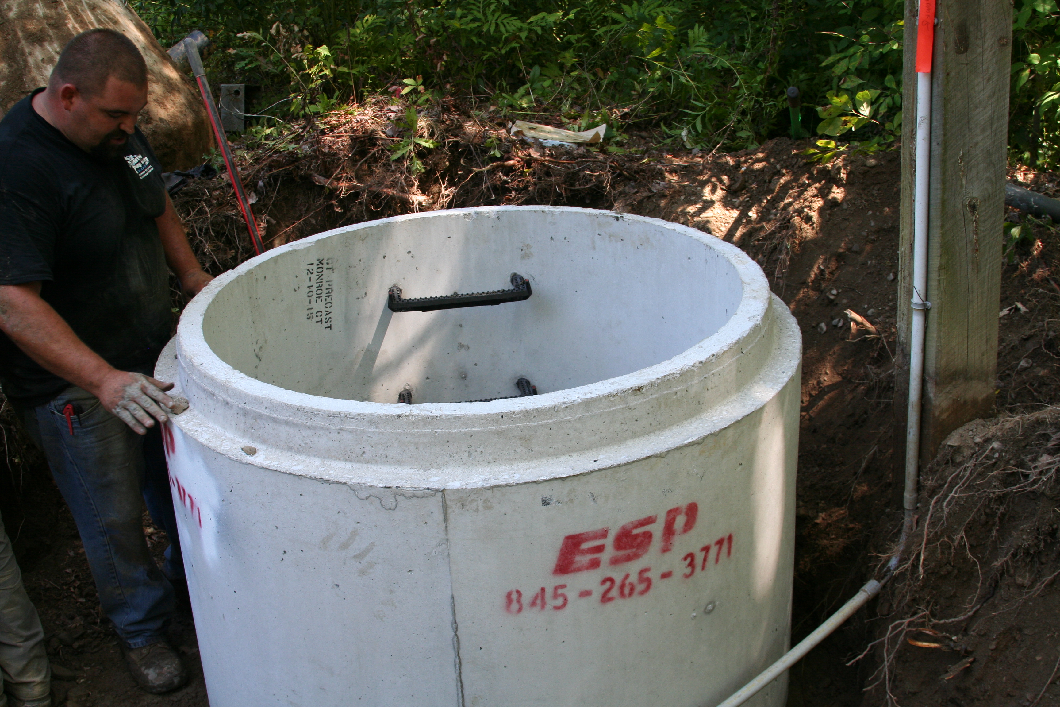

#27
pictures IMG_9267.JPGIMG_9271.JPGIMG_9280.JPG[/ATTACH]IMG_9277.JPG
Should have gotten a 2 ft riser . The top is 10 inches higher than before so the control box is a little low. sit to work on it . We had a lot of roots sneaking down the old manhole between the cast iron and the concrete. That joint was sort of hidden. We are going to leave the backfill as it is so we can see the joint and cut off roots before they fill up the chamber. probably 40 years my guess. Next project is to landscape the thing. Inkberries , I think, they are green all year and a bit dense.
