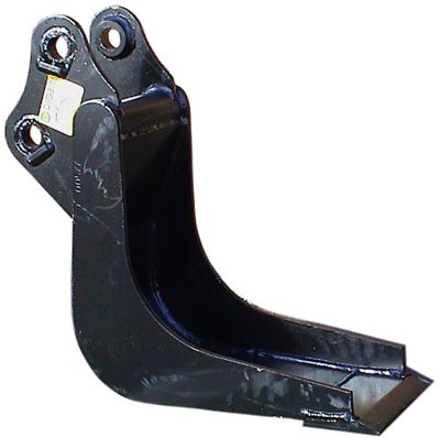

General consensus is that narrow BH buckets and compact dirt (clay) don't mix. The problem may be able to be solved with a self ejecting bucket.
Remarks on charlz "narrow bucket" thread (Built it Yourself), and my "build a slim trenching bucket?" thread (Kubota own/operate) indicate the likely possibility that when working in a high clay content soil the dirt sticks to a narrow trenching bucket and doesn't readily evacuate. This lead me on a search of "ejector buckets" and my thanks to pycoed (West Wales UK) for leading me to European designs.
US has little offerings for ejector buckets (that I could find). Some European backhoes seem to have a different bucket style and operation of the curl mechanism.

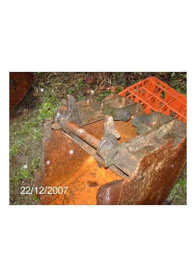

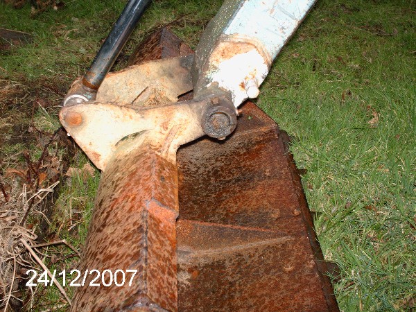

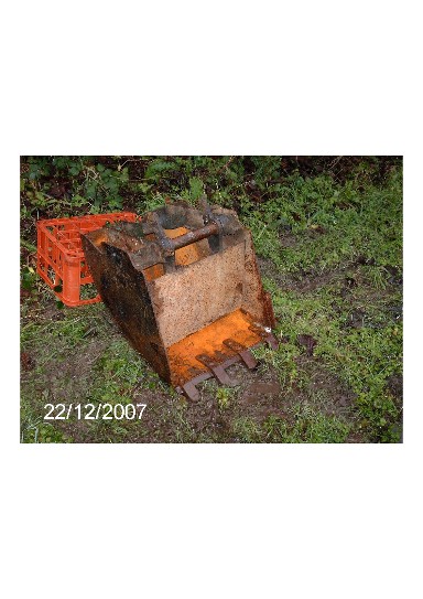

Here are some additional photos from John in "Wet Wales"
First two are his ejector bucket. Notice the actuating levers on the side of the ejector flap (seen best in second photo). I also notice that the bucket has a large opening in the back similar to what BX24 mentioned.
Here is the dipper stick. Note the bolts protruding from the sides to catch the ejector activating levers. (The bucket in these pictures is not the ejector bucket. BTW- his buckets do not have our typical scissors arm on the curl rod)
So I'm back to the drawing board for some modifications, maybe total redesign. Thanks again for all the good suggestions.
