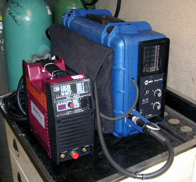

This little Thermal-arc 160 amp dc only 120/230 volt cost more for the box only then a Thermal-arc 185 ac/dc with everthing to weld, more then the Esab 161 too. I like quality over price when it comes to welding machines. Idid get a deal though! /forums/images/graemlins/grin.gif
