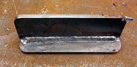

</font><font color="blue" class="small">( This is not a tig weld but a mig weld done with a Miller
passport. If anybody can post a picture of a better
weld made with a Chi-com wire feed, I will sell my Miller
and buy it!!! You get what you pay for and generally way less if you are looking for a bargin.
/forums/images/graemlins/grin.gif )</font>
It's a beautiful weld alright. I'm sure it is easier to get a cosmetically pleasing weld or a truly effective weld with a high dollar welder. But how much easier? Over $1000 worth?
Back when I was up to my neck in welding quality, I would have raised a flag about that weld. Depending on the thickness of the parent metal, it looks a bit cold from looking at the picture. I like to see the edges stitched in a little deeper. If it's just sheet metal and lightly stressed, it's a great weld. If it is applied to heavy metal and is heavily stressed, I would "have it sectioned and sent to the lab". /forums/images/graemlins/smile.gif
AK! Now you've got me using my old work jargon. I think I need to go rinse out my mouth... /forums/images/graemlins/smile.gif
   / el-cheapo- tig / arc welder at HF #44
So you like a little undercut??
To tell you the truth the passport is a 120/230 volt mig and that
is where the value is in that unit. Portable with a internal CO2
paint ball bottle for gas. I was just cheacking to see if it had
enough power to get into a spray-arc. The edges are wetted out good with no undercut. It was a low level spray and I would not
use that gas (C-3 stainless mix) or process for anything critical. It was a test and that is it. I use a hot short-arc for .250 with that machine but I really like using something that runs bigger wire with 90/10 spray-gas. A good quality gas shielded .045 flux-core for the thickness I weld is a better pick most of the time. This weld was done by my friend with the new/old improved esab 717. It was a horizontal fillet joint and he
turned it upright and went vertical on the hot plate with the exact same settings. /forums/images/graemlins/cool.gif
