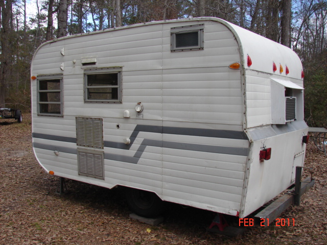

I know ya 'll like pix so here 's the camper in question in case it helps with the brake questions. Body measures 6' 8" wide, 11' long, 6 ' high. Add 3 ' for tongue. And as soon as I get passed the brake project I 'll start a new thread under project forum :thumbsup:
