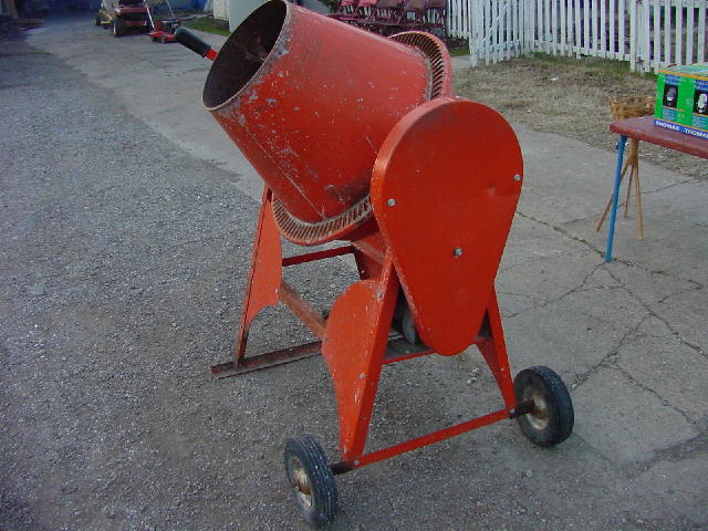

Yup. That's the town of Desert. Here's picture of the mixer. He claims it was used once by an old couple. It looks like that might be the truth.
