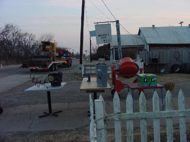

And here's even another. The good lookin' truck and tractor don't go with the deal./w3tcompact/icons/laugh.gif
He quoted me a hundred and fifty. I got the impression he was willing to negotiate.
