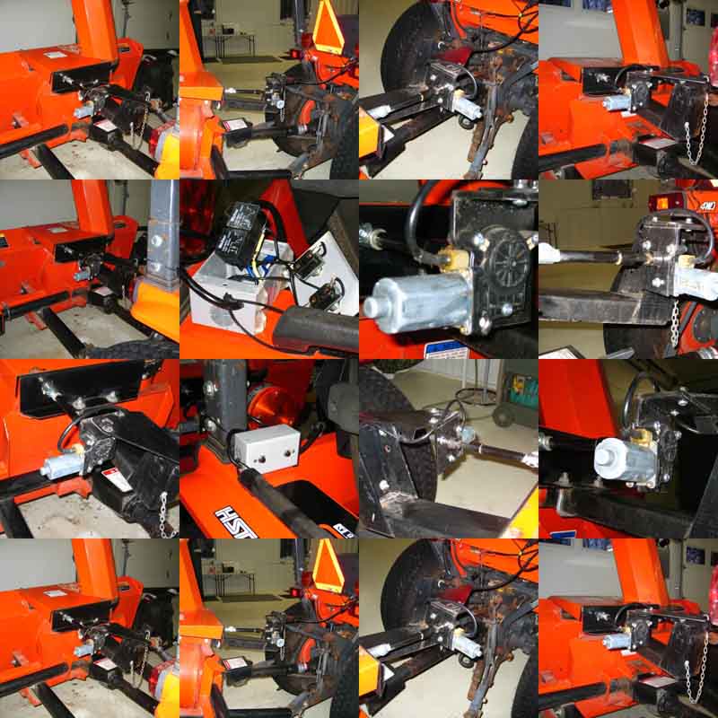

I also converted to electric because I got tired of punching out my tail lights if I left the handle in the wrong position on lifting my rear mount blower. I sawed off the crank handle and did a direct connection to a wiper motor (less than $20) using scrounged up hardware. I made a switch box for forward and reverse using a couple of momentary switches and some bosh relays. If anyone is interested I can take a couple of photos. It's now in it's second year of operation...big snow in Michigan yesterday so it got another good workout.
   / Electric Chute Rotator for 3 Pt Mounted Snowblower #23
Sure, would love to see some pics.
Allan

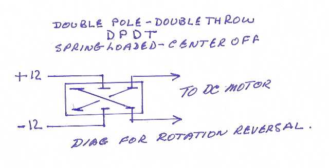

Here is the wireing for the reversing switch. (attached)
Basically it wants a DPDT (double throw double pole) with spring loaded- center off switch.
Can be a 'bat handle', 'rocker' or straight toggle switch.
The latter is probably the most rugged.

Here is a collage of shots I took. On further review, the motor is an electric window motor. I was luck and a 19mm 12 point socket fit the gear that was on the motor perfectly. I just made a simple bracket and ran a short extension back to the cut off crank handle. I show the quickly made switch box as well. I will re-do this some day to tidy things up. But you can see how I used the relays with the momentary switches. I believe in using the relays to keep the current through the switches low...coil activation current only. Not so pretty, but it does the job.

My rotator is a wheelchair drive motor, permanant magnet type which I'm sure draws more amps than a wiper or window motor.
I wired a spring loaded DPDT sw that was rated at 10 amps and have been running it for the second season without any problem.
Also the sw is an import 'rocker' type, not of the highest quality.
I like the rocker because even with gloves on it is convienent to use.
