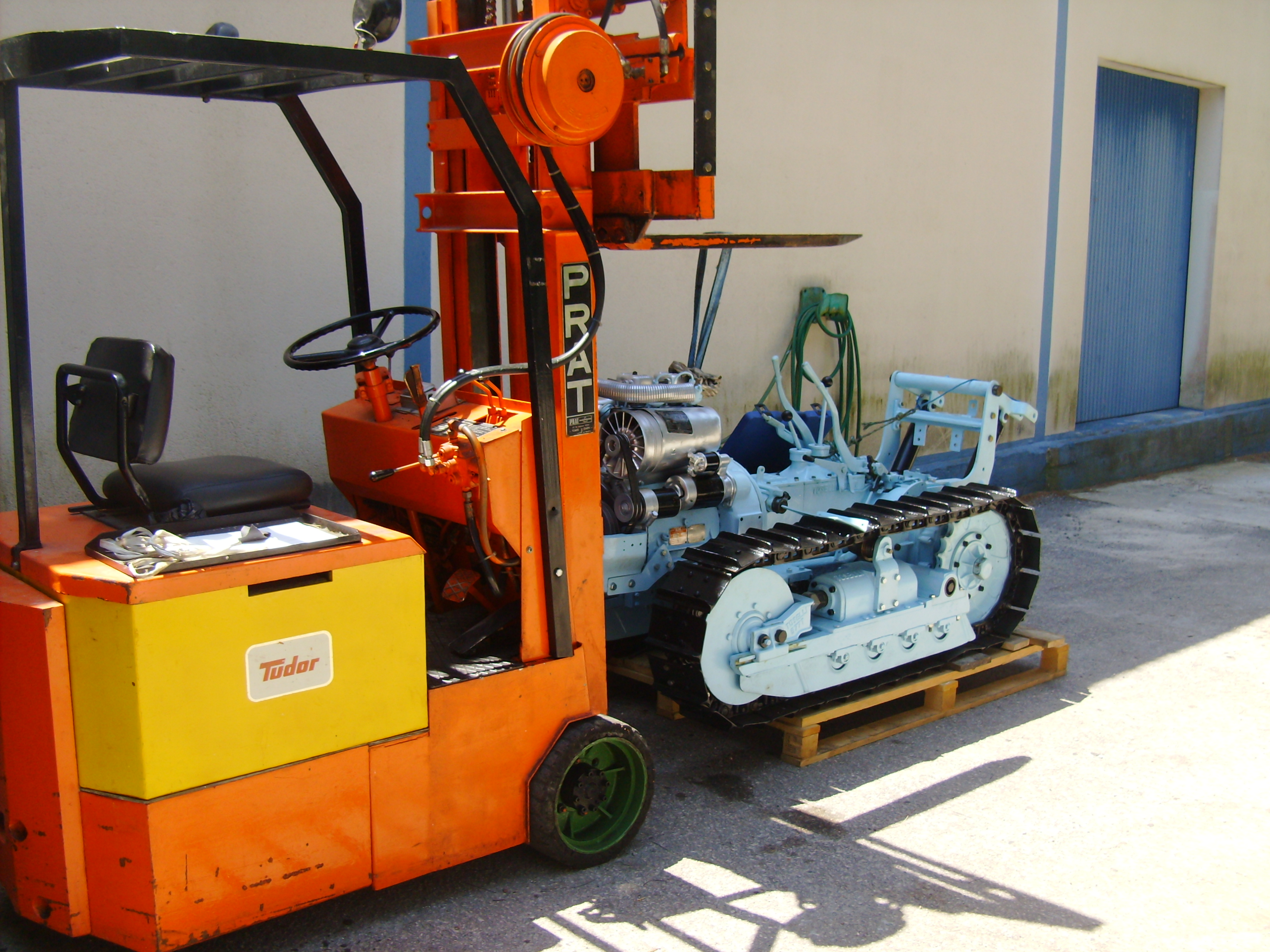

Yes, forklift batteries are definitely heavy! My electric forklift that can lift 3300 lbs has a 1700 lbs 24V battery. I've restored it in the past but I can't remember the HP of the motors. The one for the drive is a 3 speed big one.
The batteries are way too expensive to replace. The forklift doesn't really worth that much. Once the batteries die, I might just convert it to diesel. It doesn't get the use it used to get a couple years a ago.
