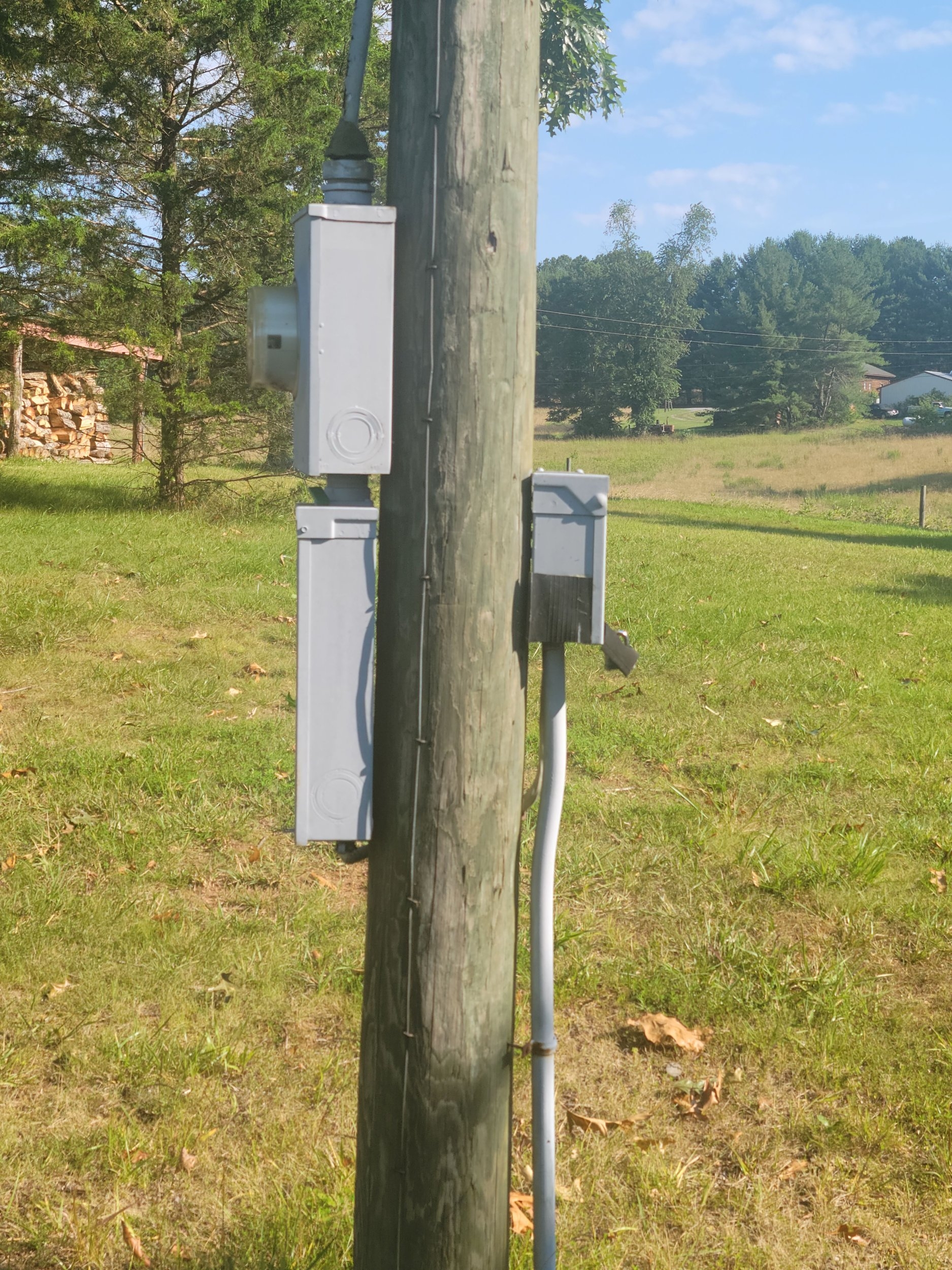

You should drive a ground rod nearby that sub panel and at a minimum ground the box to it and ideally add a ground bus and move the grounds to that bus.
Yes, by that pic it appears there is no ground conductor going to a ground rod (or two by new code)
   / Electric Fence Charger Died I believe from Lightening thru the Ground #12
It would be good to pull in a #10 copper ground wire. A #10 is good for up to a 60Amp breaker for a subpanel feeder. The picture shows 3 conductors in the feeder.
Best practice and code for new installations requires Line 1, Line 2, Neutral conductor and a ground condutor. It should be easy enough to pull a #10 ground wire in and connect it to the ground bar you plan on installing.
   / Electric Fence Charger Died I believe from Lightening thru the Ground #13
Good catch there. A bare #6 solid copper continuous conductor run to the ground rods and connected with acorn nuts to the ground rods. The ground conductor should not have any splices in it to meet code.
Install ground rods at least 6' apart.

I attached a picture of what is on the pole. The transformer is at the top of pole, then the meter, then a 200A breaker, then a cable around to a 60A breaker on the pole, then wiring underground to the panel in the shed. All of this was here when I bought the place. There were 2 additional breaker boxes on the pole for the mobile home that was once back there, which I have removed.
Based on comments. I will buy a ground bus bar to install in the box in the shed, move the ground wires to it, install 2 ground poles 6 feet apart, 2 clamps and #6 wire to connect the ground bus bar to the ground poles.
If what I plan to do is in any way incorrect, please let me know.

Looking at the panel inside building, i would consider this to fall under the old definition of a subpanel from years ago. In the past, subpanels were fed by 3 wires from main panel, and at the subpanel we drove 1 or 2 ground rods and attached that ground wire and the neutral to same neutral buss. Then attached all grounds and neutrals to same buss.
this method has not been allowed for some time. Nowdays you have to feed a subpanel with 4 wires from main panel, and keep neutral and ground separated in subpanel, with neutral buss isolated from ground.
there are millions upon millions of these panels still in use with no issues. I say drive a couple of ground rods and run a continuous #6 bare from neutral bus to both ground rods.
even when we do repairs to these older systems, electrical inspectors dont require us to repull 4 wire feeds. The panels just have to meet codes used at time panel was installed. Now if we replace panel, we have to upgrade to 4 wire runs between panels.
i also think charger just failed. Since i switched to Gallagher chargers, never had any more issues. I would think a lightning strike would have burnt up charger…a black smoldering mess of junk would have remained.

I took the charger apart and it showed no evidence of a hit.

The sub panel in the shed is at least 35 to 40 years old. Why I think it was lightening, we had a storm the night before. My neighbor also had his charger die on the same day as mine. Our fences do not touch.
