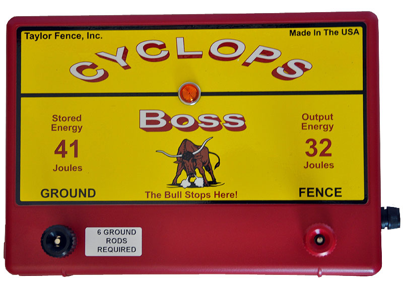

Don't p-e on fence when this bad boy's on guard ! Yikes ! :eek:
Boone
Boone
32 Joules? D*mn! That makes my 6 Joule (X6i Stafix) look like a toy! And they're cheaper too! :thumbsup:
I don't know if I could give up my remote control though. It comes in real handy.
Do you have one or just pointing it out?

Yes they even have on there site when you pop up ac chargers the unit you would like or need the annual projected power cost to run. I'am sure you also knowticed there ground rod(s) # recommendation depending on which unit .
Boone

No Sir just pointing it out.I just own/have/run a Parmak 50 miler : Electric Fence Charger SE-5 for Electric Fence . Thats outfit I bought mine from. Came accross them Cyclops models looking up chargers on net. Just like I didn;t know Zareba made a 200 miler(20 joule) Zarebaョ 200 Mile AC Low Impedance Fence Charger, Model EAC200M-Z
Least down here you never see-em at TSC. Largest one they (TSC) sells down here is a Zareba 100 miler. Believe it or not Harbor Freight sells a mini rinky dink solar charger to Search results for: 'fence charger'
know someone that bought one and gave em lots of trouble from get go.
Boone

32 Joules??? Sweet Mama!
With that much power I'm thinking you'd start to have problems where there previously was none. Such as ground wires, brace wires and posts being slightly energized from it (excuse my poor terminology) bleeding over.
Kind if like a really hot CB radio I had in high school that would bleed over onto the head sets at Burger King if I was in the parking lot. :)
/ Electric Fence Help #50
I haven't studied the specs, but suspect that the voltage is about the same as other fence chargers, 8000 V or so on a short, clean line. I think this charger is able to send more current with each pulse and that the pulse is wider than other chargers, thus, more power/jules. If so, then a problem would be exposed only because the voltage is able to remain higher further down the fence, thus exposing a narrow air gap that had not previously experienced that voltage level. The fence charger I have regularly fries grasshoppers/bugs and continues zapping them until they crisp enough to fall away from the fence line.
