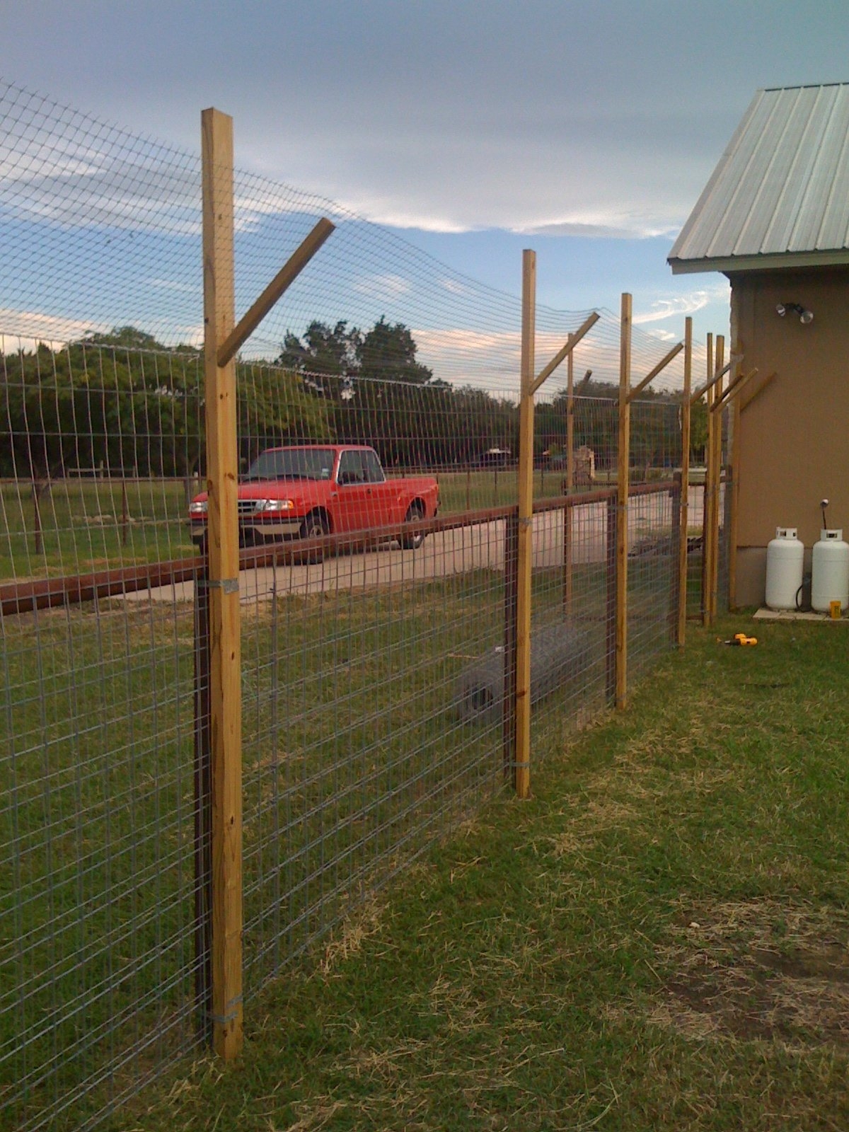

Here's a photo of what we built to keep our cats inside the backyard. It works great to keep the cats in, and has been mostly effective to keep other cats, raccoons, possums, etc. out of the backyard. I say mostly because occasionally smart raccoons and possums have made their way to the inside. The angled chickenwire on top is key to the effectiveness as cats don't like to climb upside down. While we never added a hotwire to the outside of the fence, it could have been added near the top as extra protection from the occasional climber trying to get inside.
The posts are 2x4x8 with 2x2 as the angled pieces. The fence is 5 foot 2x4 with chickenwire on top (the photo below shows a plastic mesh which was eventually replaced with metal chickenwire).
While the design does look like a fence around a prison, it works.
