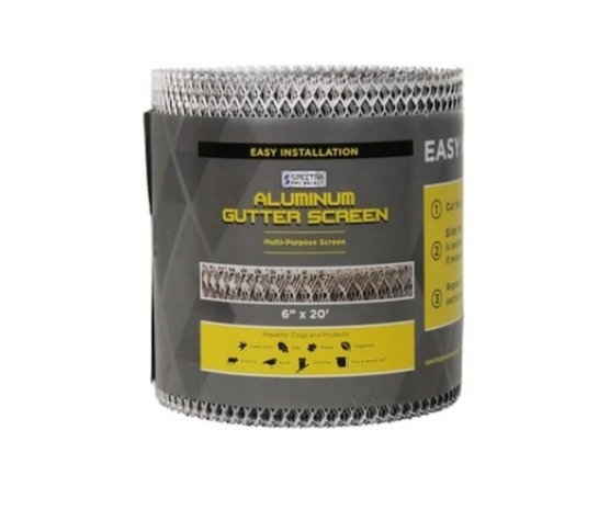

Thanks. I'm just now starting to rethink this and it might work if I fold some one inch welded wire netting over the top of the wood fence and attach it to the ground rods. Then I can run a hot wire about 6 inches above the fence.
Just the wire might stop them from walking along the top of the fence, or climbing the fence to jump over the existing cat fence netting. But having the welded wire on top of the fence should provide me with the ground to provide a shock when they touch the hot wire.
It's more work, but it might be doable.
I'd make it easy. Gutter screen wire would make it easy, like this 6" wide stuff. Simply roll along fence top and staple it on. It wouldn't look bad, bending edges down.
Overlap a bit as you go so it makes contact.
Wire that to charger black post...you do not need a ground (you could wire it also to a driven ground if you're concerned about lightning).
Then those plastic insulators with metal screw ends run up fence and along top every 10ft should be fine. Electric fence wire through them. This hot wire (we use both white round and 1/2" flat ribbon for horses) make sure it's at least 3"-4" away from fence everywhere. Too wide the cats may scoot under.
I'm retired electronic technician.
It will work.
It will work.View attachment 801736
This is the right approach. I'd take it one step further and use chicken wire or similar for the hot instead of fence wire. Basically one layer of some kind of metal mesh attached to the black terminal and another layer attached to the red terminal. Position the layers so there's no way to climb over without touching both at the same time. You need to insulated the hot layer from everything the grounded layer touches, I've done that by mounting the hot layer on PVC pipe.
I once made a chicken tractor out of chicken wire and electrified the chicken wire. The bottom layer of the tractor was 4" PVC pipe. Something probably could have easily dug under the PVC pipe, but anything that came up and touched the wire got shocked and went away.
This is safer for passers-by because if the black wire isn't attached to ground you can't get shocked just by touching the hot side.
