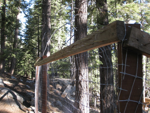

Thanks guys, some of you understand what we were up against. This bear wouldn't let us sleep for over a week. He knew when I was in the barn, and would get close enouge to see if I could make that big noise again. This bear,I'm guessing, could be responsable for some missing people in these mountains, hikers, nature lovers. He would circle the fence and strumb it to see what I could do. First time I left the barn at 3:45 he was back over the fence and tearing at the barn by 4:00am. This bear will not be a problem anymore. Thank God!
   / Electric Fence to stop Bear
#26
This fence slowed him down. Its 6' fence with large rocks at the bottom. you can see how he has pushed it in. The nail board across the top was a big plus. 16p nails shot with a nail gun.
