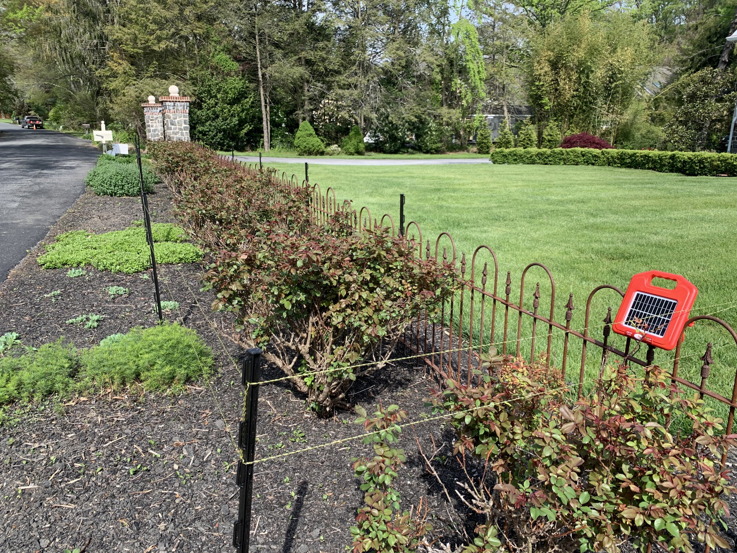

Bill, Heres how I set one of mine up.
The fence charger can be picked up and moved anywhere.
/ Electric Fence? #18
Thank! That’s exactly what I need. Low cost and can go away in the winter. What size battery is needed to drive that?
Its a built in battery pack-charged by the solar panel. Got them from Amazon.
