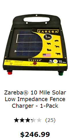

No neither one is clicking. I did take the battery out of the Zareba and put it back in. So, I know it is hooked up. But did not look at the other battery but guess I should. But again, neither one is clicking. Oh, it lights up the battery must be connected,.

I just brought it in the house and banged it around a little. (how I fix most stuff) Believe it or not, it is now showing voltage & shocks to the touch. But the shock is not real offensive to me. Just touching both terminals, not like standing on the ground touching it,. and a deer has four feet on the ground. Will put it back on the fence tomorrow and see what it does.

Is this the fencer that you have ?
If you are not getting much of a shock touching both terminals you might better just take it back.
It's not working.
Did you check the battery voltage while you had it out?
Not sure how that one is setup but the solar charger we had (granted that was 25 years ago now) clicked just like the plug in ones do.

Neither one of these click. The lights just flash. I don't think these are designed to click, like others I have seen. I never checked the battery voltage. The tractor supply one is working now , the light blinks and it does shock some, but not as hard as I Remember getting hit by electric fences over the years. It does light up the tester now.
/ Electric Fence? #52
If you are grabbing directly on to the terminals of the solar energizer that thing should light you up to the extent that you wont even want to walk by it. something is wrong with the energizer.
