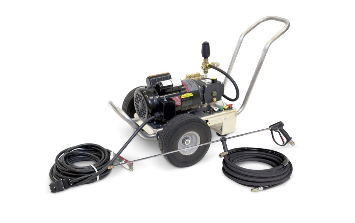

I still think (Even in the Hot water units) Karcher puts too much emphesis on packaging their machines in plastic. Hide all the working bits. Even if they are a quality machine, I would nave no interest in paying for that plastic crap.
   / Electric Power Washer Recommendation? #27
There is no plastic in the one that I linked to.

That's a machine. Simply built to do a job. Nothing about marketing or appearance. I like! :thumbsup: Similar to what I have.
