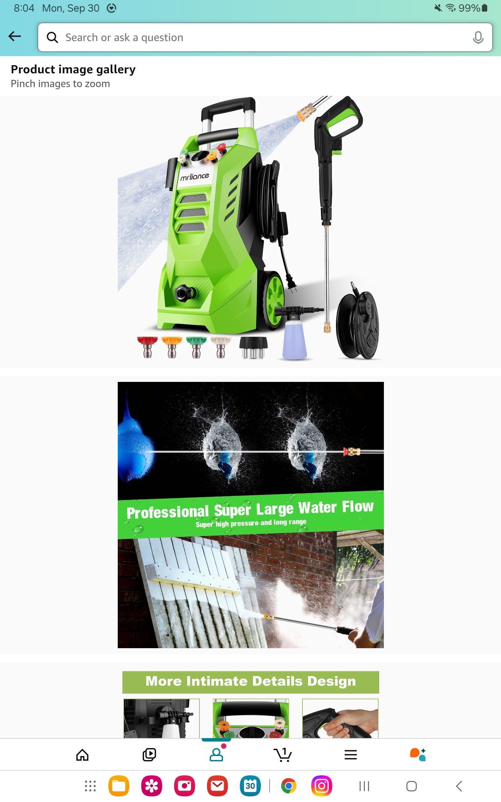

I purchased one for $115.00 on Amazon (Mr. Liance) for cleaning the dirt off the tractor and RZR. It works well for this.

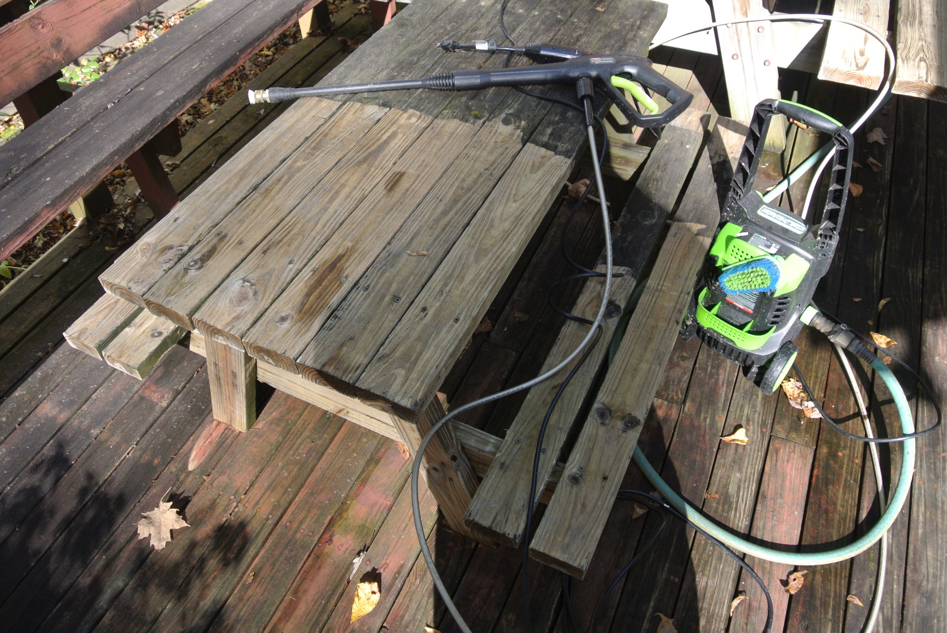

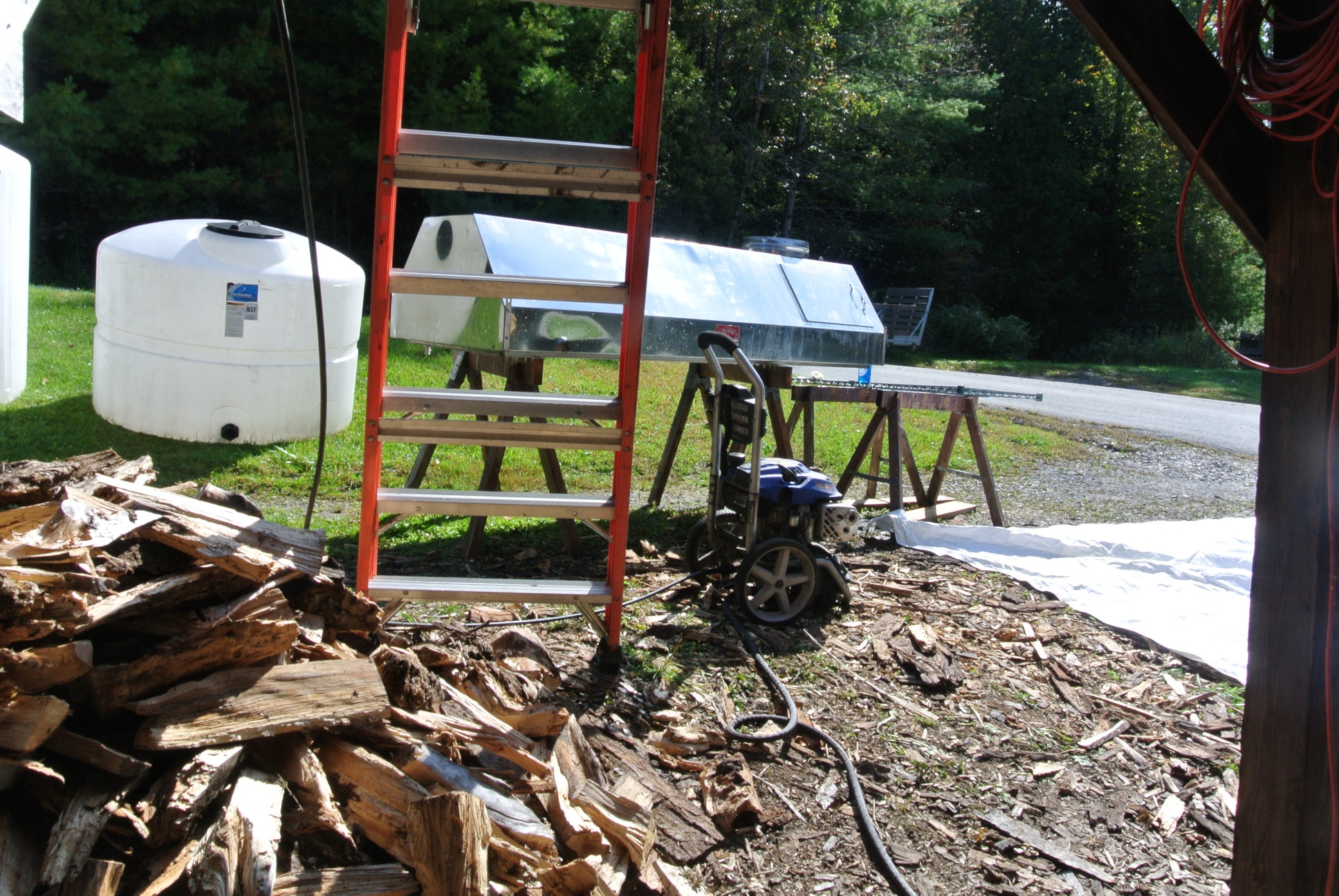

My son has a GreenWorks 1600 that we use around the house. It works okay for cleaning off tractor, mid-mount mower, cleaning PT deck, cars, etc. It may be lower power and slow, but it does a good job. It is fairly quiet for its size.
At the sugar house we have a Subaru that we got at Costco in 2015, 3100psi. That works really well for cleaning stainless evaporator and tanks, cleaning out poly tanks, and keeping trucks clean. The electric start was okay, but we lost the charger and have dealt with pull start since, and not a problem. It usually starts 2-3 pulls. We use non-ethanol gas as it sets for long periods without use. It is noisy and we double up on hearing protection when using.
n both cases we bought multiple size and spare tips, and the hose for the sugaring operation has been replaced due to wear/tear dragging it on concrete. The turbo nozzle is really handy for cleaning where you really do not want to tear the paint off. While both have soap capabilities, we have seldom used it.
For greasy jobs, we frequently pre-treat with SimpleGreen or occasionally Dawn, and it gets the job done.
