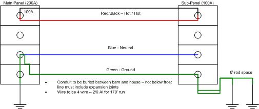

6sunset6 - OK - so let me spit back what I think you are saying... From the main panel in the house - I run 4 wire out to the barn... 2 hot, one neutral, one ground... but in the house since neutral and ground are "the same" - they are basically connecting to the big blocks you use to hook big wires onto the small bars...
Then - out in the barn - the ground will go to the "ground" bar - where there will also be a copper line running in from the 2 ground rods... and all grounding lines for barn circuits run there... then the neutral runs to a "floating" and insulated from the panel neutral bar... where the neutrals run...
Attached to the post is a diagram - is that right?
mudcat - Code Basics confuses me - one sounds like one thing - the other something different... meaning - 3 wire vs 4 wire between house and barn... The first 250-32(b)(2) reference (Grounded neutral conductors serving another building from a main building) sounds like what I'm talking about... but the other one does too...
podagrower - The 100 A breaker is on the main in the house - the sub also has a 100A main - nothing in the sub can draw more than 100A - so it will never draw more than 100A on the main in the house.
DWW68 - overlooked - now - not so much - added to the list of things to do... and it also explains why the existing conduit the previous guy put in is snapped right off at the house!

You got it . :)

Oh yeah the confusing part is grounded conductor the neutral and grounding conductor the bare or green one. :) :)

This is what I have understood the national code to say, if you run the three wires to your barn it is okay, but the ground and neutral are bonded in the barn box and ground rods are necessary. If this is the way you wire your barn you will want to avoid anything that may be attached to the house grounding system, telephone lines, cable TV lines, water lines, etc.

The way you described your wiring plan is the recommended way.
