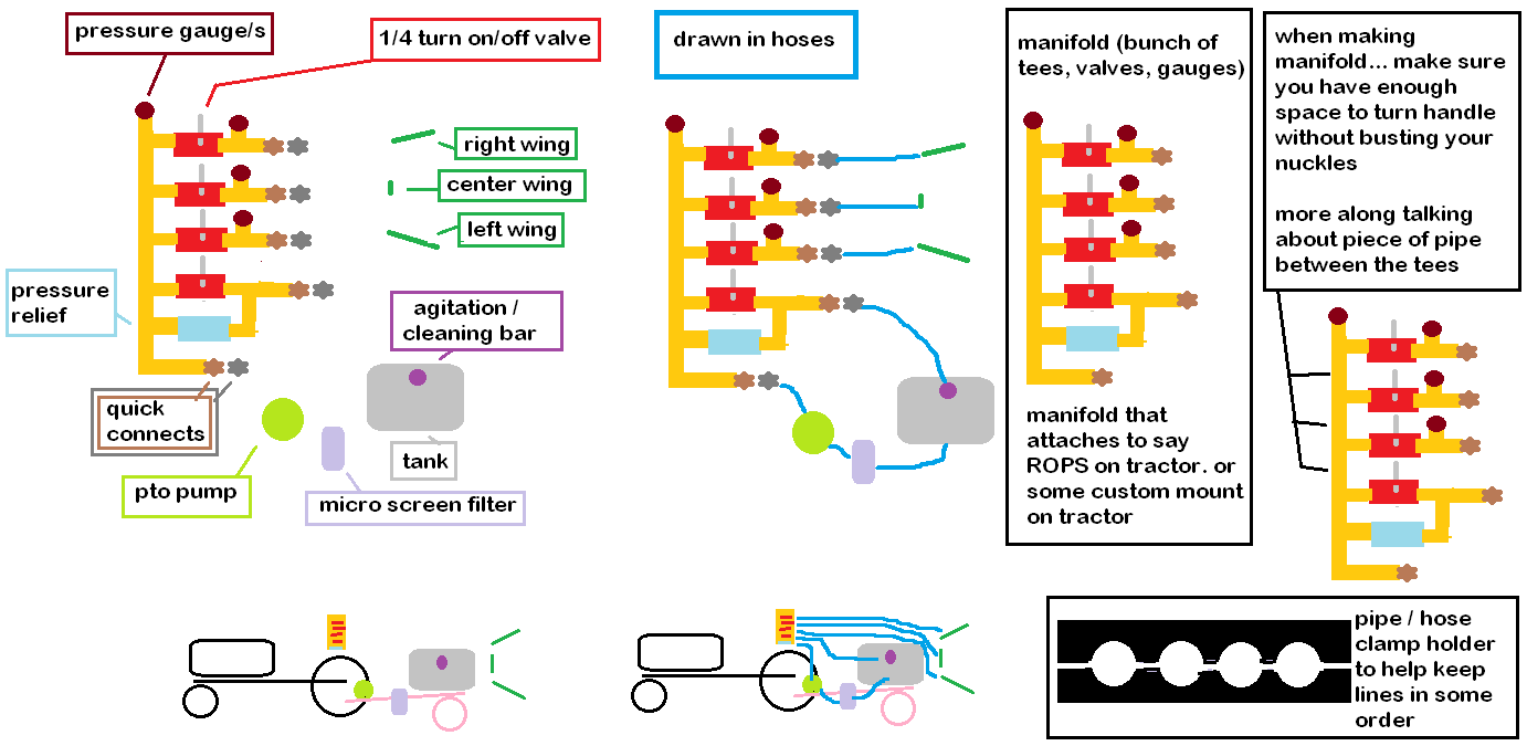

if you had an open-station (non-cab). with a PTO pump. that connects direct to pto snub on back of tractor. you could most likely get away with something costing less.
quick connect couplers (banjo coupler) you should be able to find 125PSI versions on the cheap made out of sch 80 pvc.
1/4 turn on/off ball valve. double check they are full port. (when you open them up there is no reduction inside)
manifold needs to be all "metal" any plastic for Tees, 90's, short nipples / pipes = cracking / busting due to simple vibration and a little tugging from hoses. black pipe just appeared first on list. aluminum might work, but unknown about corrosion of agriculture chemicals.
pressure gauges i just picked something. "the very top left guage" = main system pressure gauge. then each boom / wing has its own pressure gauge.
the manifold needing to be metal (pipes / tees / valves) in it. is due to most likely only a couple straps to hold the manifold in place. plastic would just bust out. having sch80 quick connects. *shrugs* you do not need them. but may make things easier, quick connects being plastic. there should be less force being placed on them. more so if you put a couple hanger pipe/hose clamps around them.
a different way of thinking about it... is adding 4 hydraulic rear remotes ((errr 4 water rear remotes)) on tractor.

are you wanting a completely package? or a full DIY project, buying individual valves, making own wire harness, making own switch area in / on tractor?
the links you noted are either ON or OFF there is no partially opening valve. if spray tank and booms all get going at an angle say going across a hill. the lower spray nozzles going to get more liquid, than the higher spray nozzles (within reason)
if all you want is easy on/off electrical. the couple links you noted in your post. from initial glance look like nice setups. wire harness, plugs for the harnesses, easy mount box that holds switches. looks like it comes within inline fuse and wiring to battery.
to note it: most places "dumb stuff down" when pumping lidquid / air there fittings and pipes and valves. and end result of the dumb'ing stuff down is statements of 8GPM. you can pump more through the fittings / valves but it will take some extra pressure from pump to push through the valves and fittings. more pressure normally means more friction. (end result fittings / valves heat up more "within reason")
if you keep with same size "INSIDE DIAMETER" of connection coming off pump and through valves and hoses. you should be ok. (without getting into niddy griddy math). if pump has 3/4" inside diameter, then keep everything 3/4" inside diameter on your fittings / valves / hoses / pipe. i do not really like giving a blanket statements like this. but *shrugs* KISS (keeping it simply stupid).
