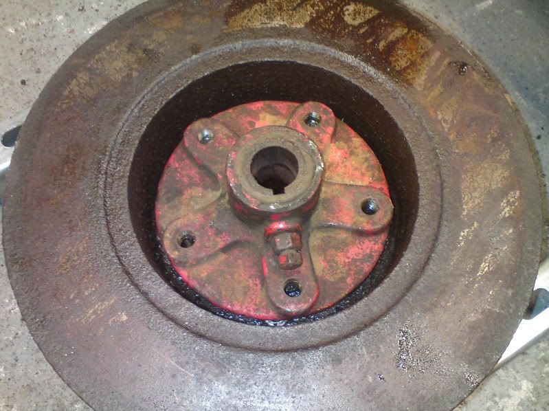

Still, I got it in the workshop and started to take stuff off it to open it up. It won't open yet as there is the hitch pin through the case that is rusted solid, I will deal with it later. It turns out to be a Unidrive 4 speed (3F-1R) with I think a LSD.:thumbsup: It will stop me having fiddle brakes though if it is a LSD.

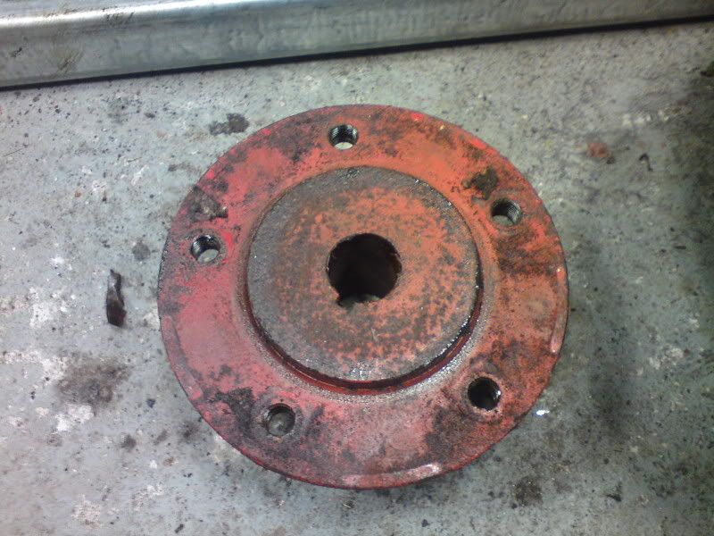

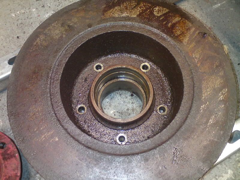

I wanted to change to Land Rover rims to make it easier to get rims for different tyre use, road and agri, so I thought about using a couple of old Discovery hubs.
It turns out that the locating spigot on the Wheelhorse hub exactly fits in the oil seal rebate on the LR hub.
:thumbsup:
The five bolt holes don't quite match but I can slot the WH hub holes and then make a spacer so that the WH hub can bolt down to the LR hub and still secure the brake disc.
That will be another week's job though.
I will try to drill out and heat the stuck hitch pin so that I can remove it and open the box. Can't risk not checking it is ok on the inside with all that water.
