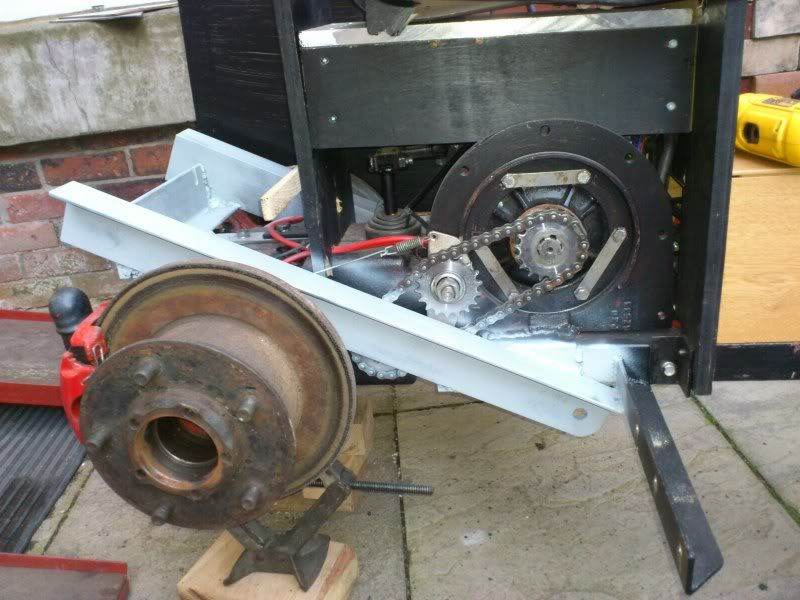

I will be running an 11" motor, direct drive to the rear wheel with a 5/8" duplex chain.
I am using wire centre lock wheels to get the classic sports car look.

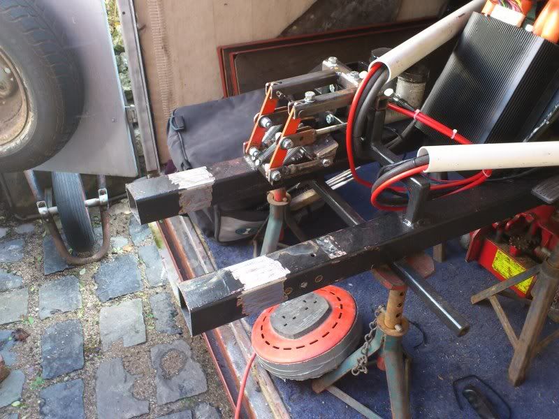

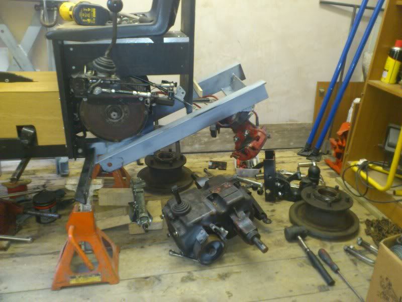

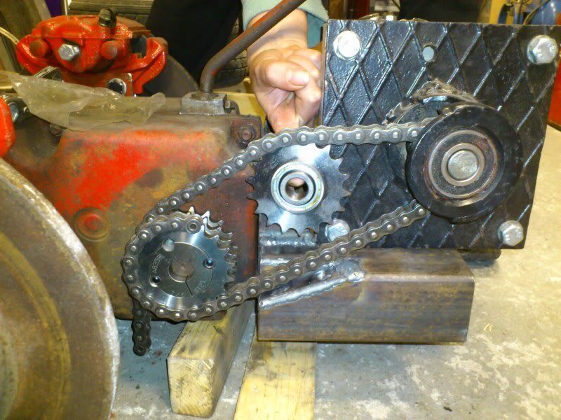

I haven't updated here for a while mainly due to ill health and not being able to keep track of too much at one time. I have time now as I have a ruptured Achillies Tendon and so I am immobile!:smiley_aafz:

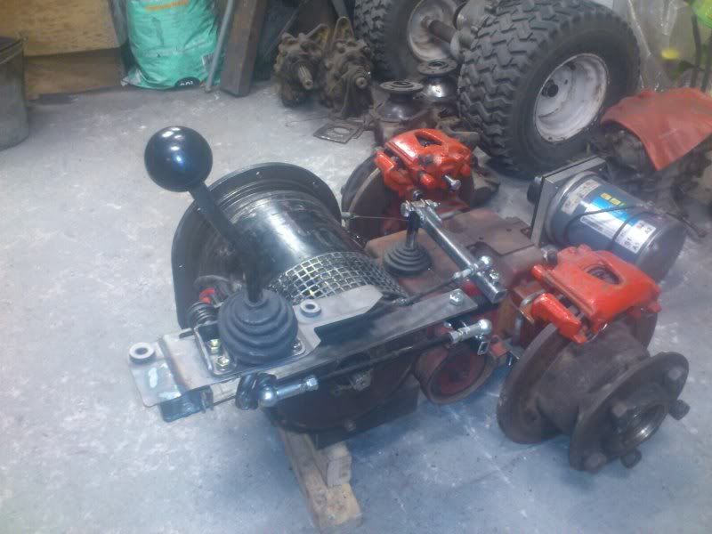

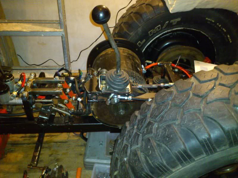

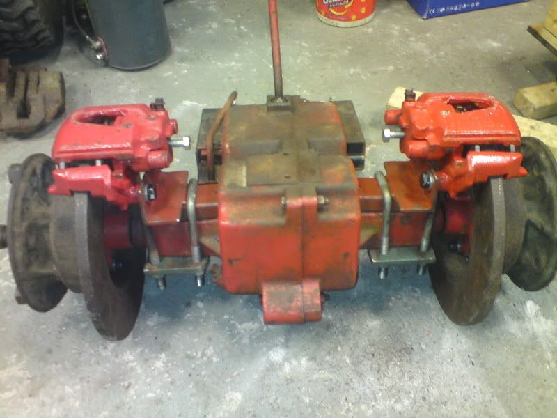

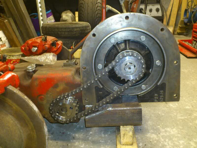

Anyway, the last photo was the broken diff in the first trans and a Wheelhorse 3F1R box ready to replace it.
I converted it to disc brakes.
And then looked at fitting the 7" Clubcar motor.
Then decided on a bigger 9" fork truck motor!

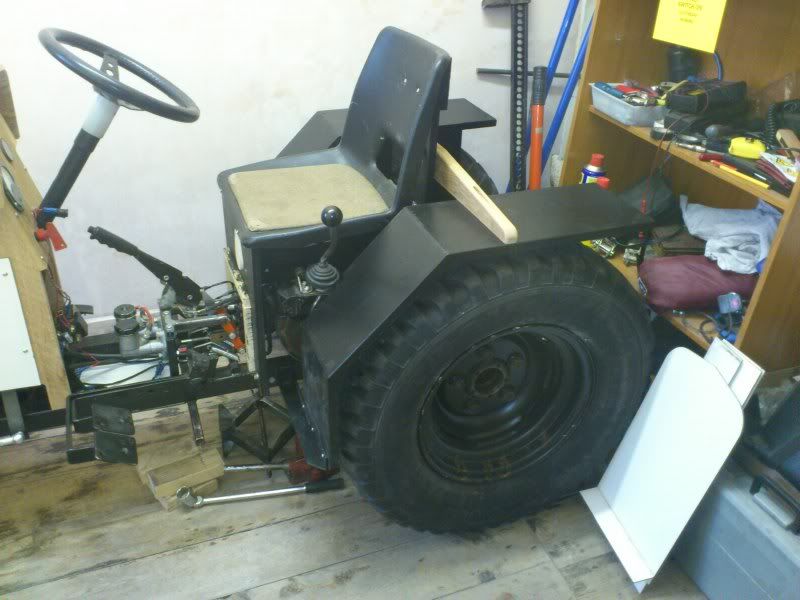

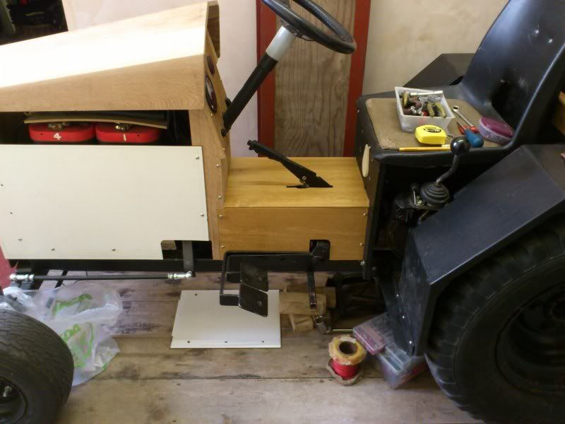

I relocated the gearshift from under my butt to my left side (being in the UK) and to a conventional H pattern instead of the sideways H pattern on the Wheelhorse.
I then cut off the rear of the tractor and grafted on the new frame and trans mounting.
I moved the tractor from its home in my trailer into the house and started to reassemble it all in the warm and dry.

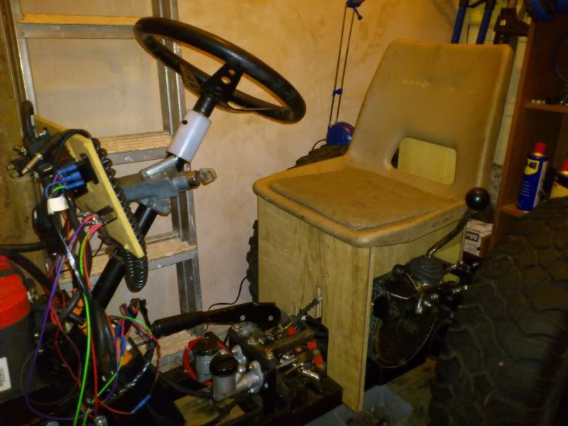

Added a temporary seat.
My partner then took it for a drive (video).

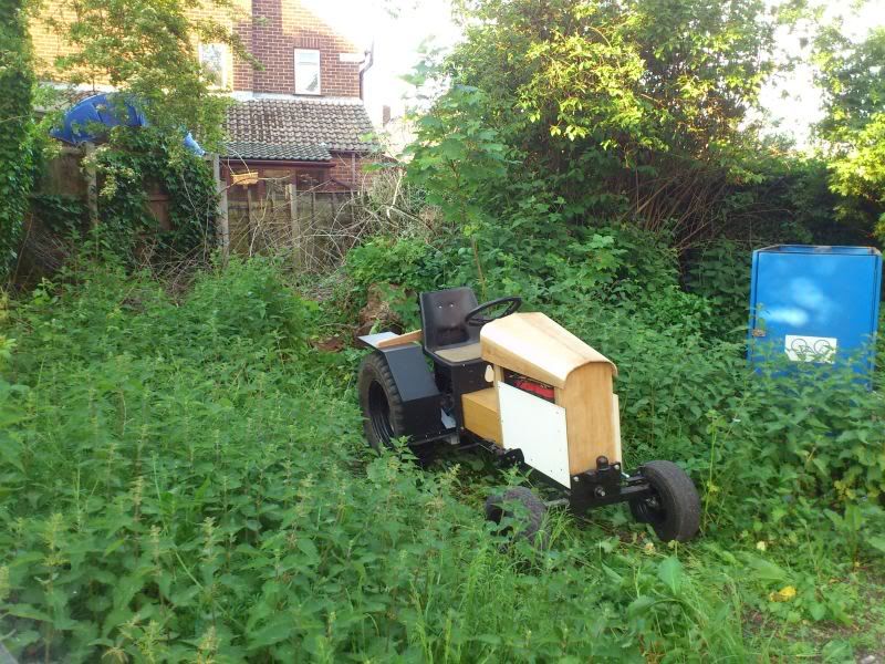

I then got a request to demonstrate it for some local organic farmers with a view to doing an electric conversion on their farm tractor!

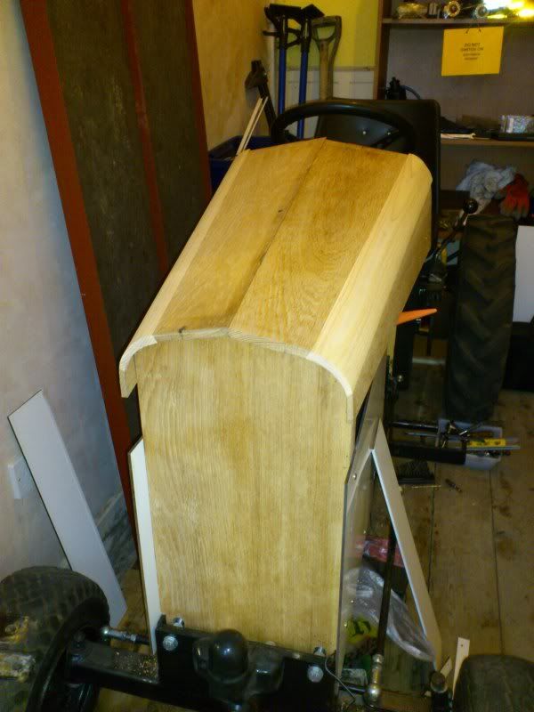

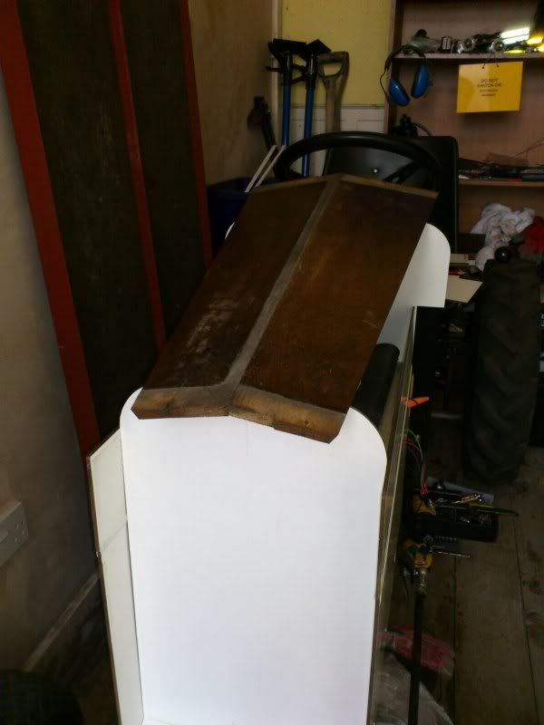

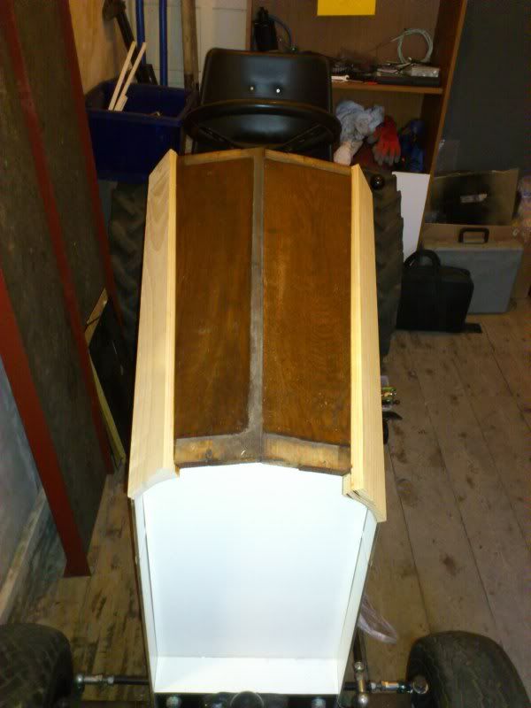

That meant I need to make it look a bit prettier so I started building some wooden body work in English oak and ash.
I ran out of timber for now so some bits are plastic.

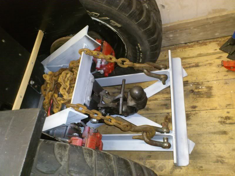

I then started on a ground anchor with a view to fitting a winch for timber hauling.
Chassis extension.
Anchor pinned to frame.

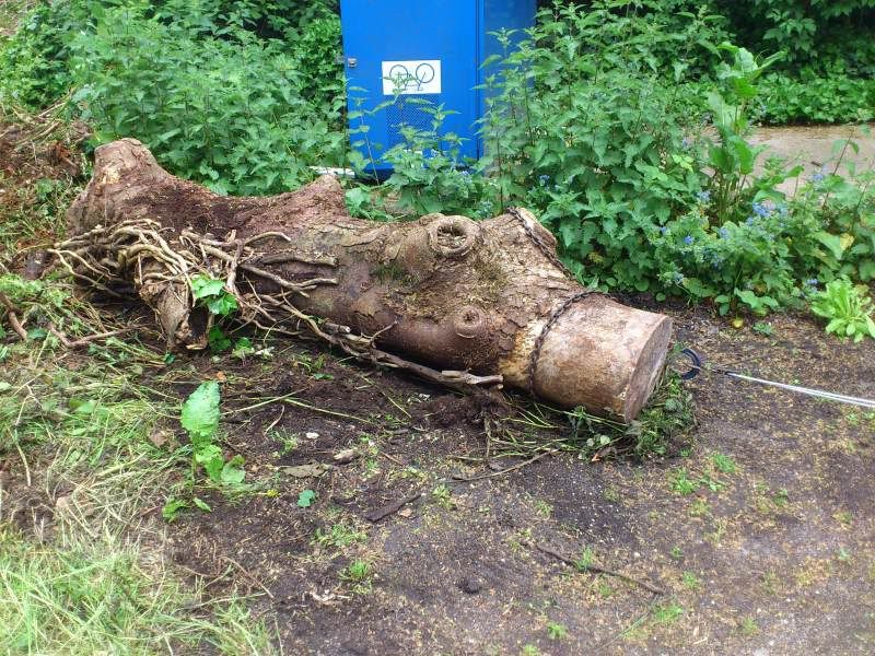

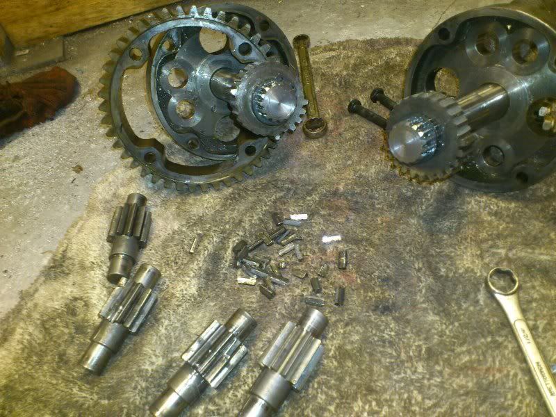

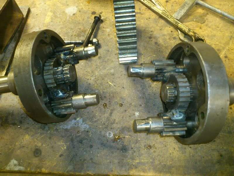

However, I got impatient and wanted to see how much current it would pull so I went out to pull a log.
I managed to record 360amps at 48V which gives around 23hp.
This was the log.
It was a bit heavier then I expected and even defeated my car and 1500kg winch so hardly surprising that the tractor suffered a bit.

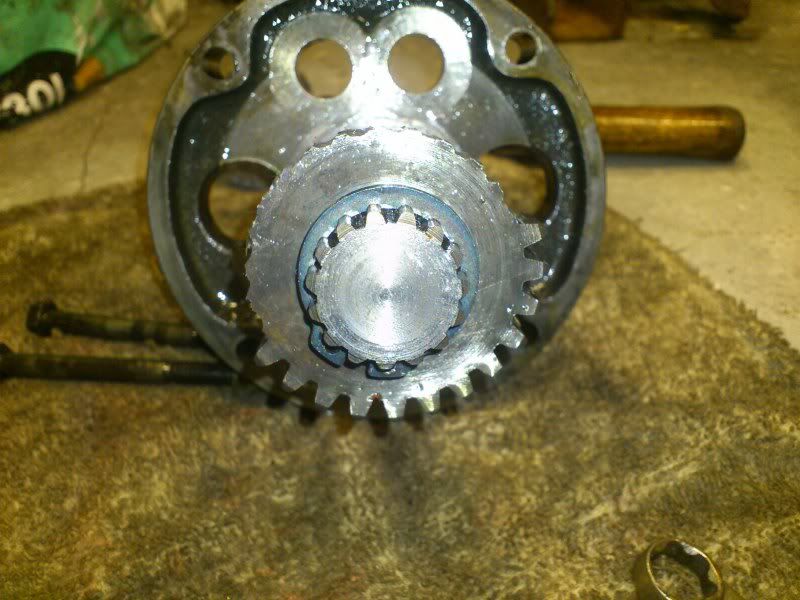

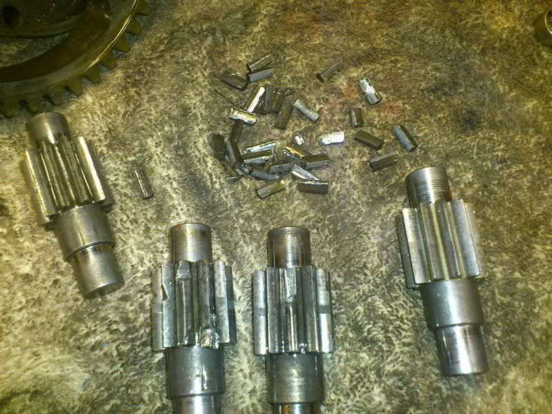

I got a clicking noise in the trans but hadn't lost drive. I decided to dismantle to check.
All looks fine in the gears.
Opened up the differential and....
Opps!:duh:
So for now I have welded the diff gears together.
That keeps the tractor mobile for the farm test.
However, I am aware that the small tractor transmissions are just not up to turning those 32" tyres so the current plan is to use a transfer box from a Lada Niva 4x4 and a Salisbury (Dana 60) axle from a Land Rover to build a much stronger trans and rear end. I will narrow the Salisbury to fit.

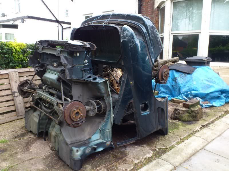

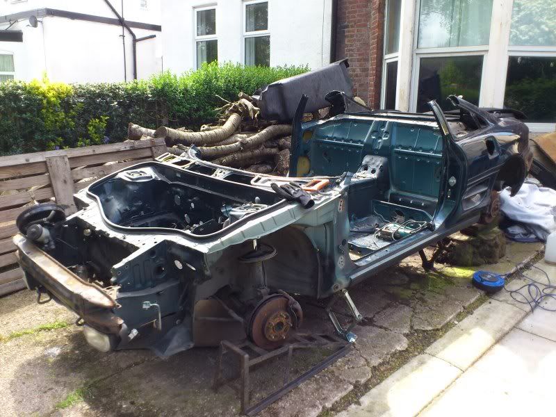

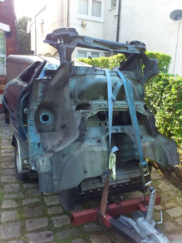

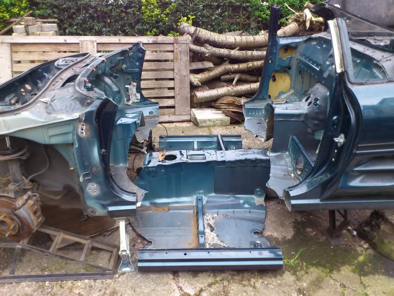

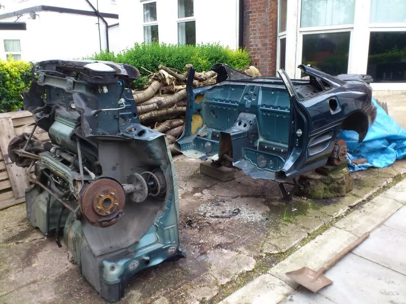

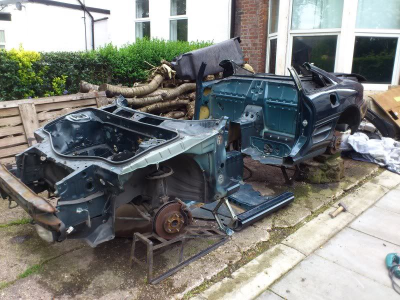

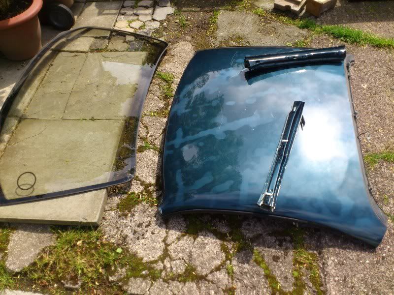

Just reading back and I feel I need to update on the MR2.
My partner and I decided to get it scraped and so set to stripping out all the saleable and salvageable parts before getting rid of the bodyshell.
I tried selling it as a rust free shell but the MR2 club members, Ebay buyers, seem not to be interested in putting money where they say it is worth.
We decided to have some fun with it instead.:D

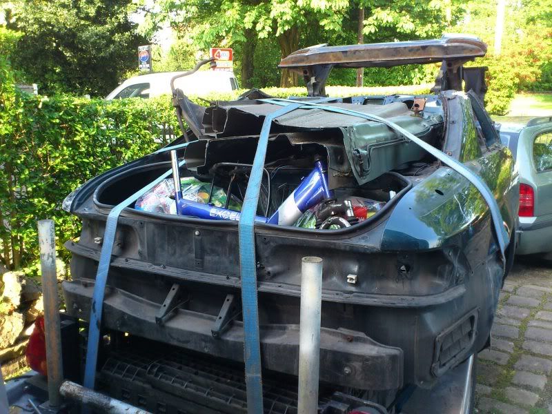

Then loaded it on my trailer for the scrap metal yard.
All gone and cashed in.:thumbsup:
