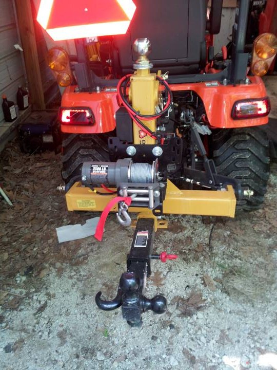

I have a Harbor Freight Badlands. I think its a 12,000lbs winch,, but would need to check.. Only used it a few times over the years but its done fine. Mounted on a cradle & I welded in a 2" receiver to the front of the trailer. Heavy & sucks to schlep out of the barn. But it stays out of the weather in the barn.
My crappy welds held when I locked up the brakes to test things & tried witching the tractor on. Made it half way up before the winch ran out of oomph. Tractor & flail weigh in the neighborhood of 8k lbs.
Harbor freight cradle is only rated to 9k if I recall I pretzled it mounting it with chains improperly before welding in the hitch. It's light weight, but may have held up if used properly. Have a new better cradle with adjustable handles off Amazon now.View attachment 714154

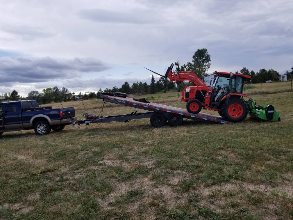

Why would you go to the trouble of mounting a hand crank winch on a trailer if you can put an electric one on? That would be a true pain to winch something on a 16' to 24' trailer with a slow hand crank winch. To each is own I guess.
Mine is a 12K but my trailer is a 24' and my tractor dry by itself weighs 8000 lbs.

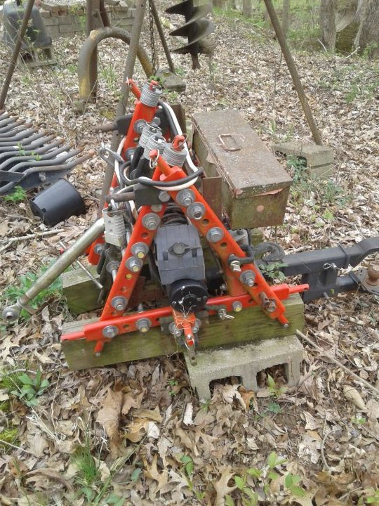

Putting winch on a 3pt will allow you to use tractor to load the trailer or winch tractor on trailer
Light duty winch on trailer mover
Heavy duty winch with trailer mover parts added. Can't weld - used 14 or so drawbars.
