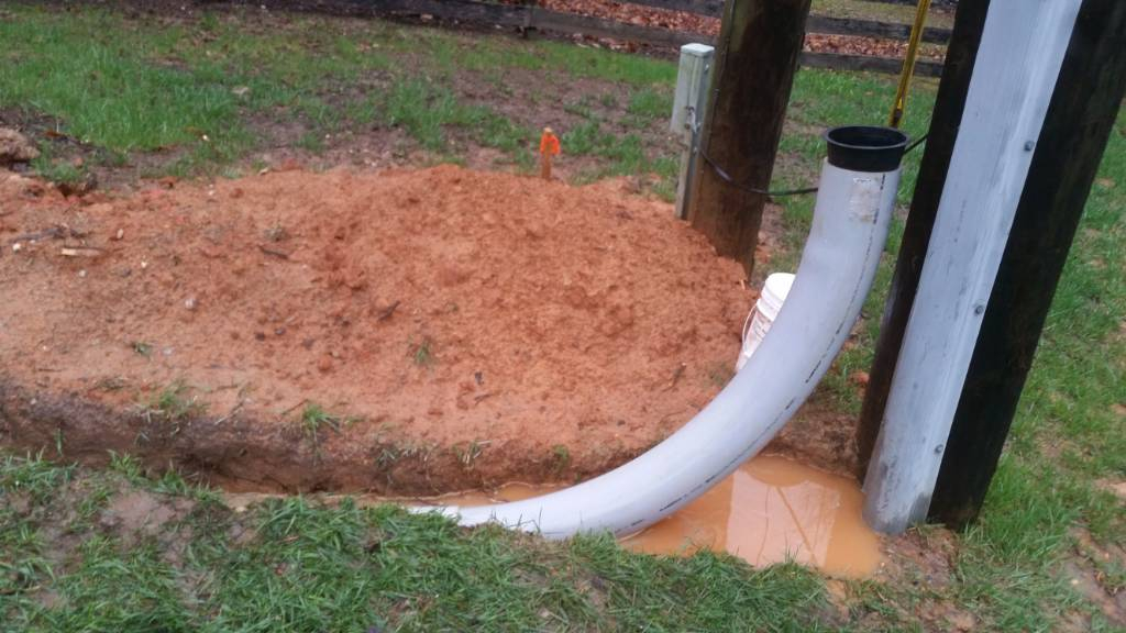

3 phase for residential???
Its the second line for my shop at my house, we can get a second metered line at no cost. The 3phase was available so I spc'd it. House is single phase.
If 3phase is on the pole on your property here its an option. I really like dealing with NOVEC.
   / Electric transformer in front of house (on ground) #48
REMC just replaced all the lines and poles around here. Was hoping they would bury, but was told they couldn't as it would be too costly... Yet power goes out every planting and harvest season due to farmers hitting poles.. 🤦
I don't believe any REMC's service lines are buried. My line is buried about 600 ft. to the REMC pole at the road.
   / Electric transformer in front of house (on ground) #49
Yup. We even have two meters; one for three phase, one for "single" phase. Three transformers sitting on two poles to make it happen.
Why?
We have a deep well, some distance from the power poles, and power losses scale as current squared times resistance. Three phase has lower power losses, yielding more water pumped per watt. Going to three phase halves the power loss for us compared to single phase.

As somebody noted, all utilities seem to be different. Mine would go something like 150' from the road for no special charge if you went overhead. They'd add one pole if necessary. Beyond that there was a charge. If you went underground, you had to do it or have it done at your expense, but they would set the equipment at no charge.
In this area with a co op the first 1000ft were dirt cheap, either overhead or underground.
Anything beyond 1000 ft is much more expensive.
I think my 2600 ft underground with 2 in pipe and two coupling boxes....about $14K....I think
