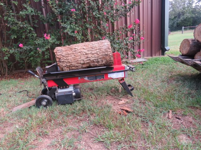

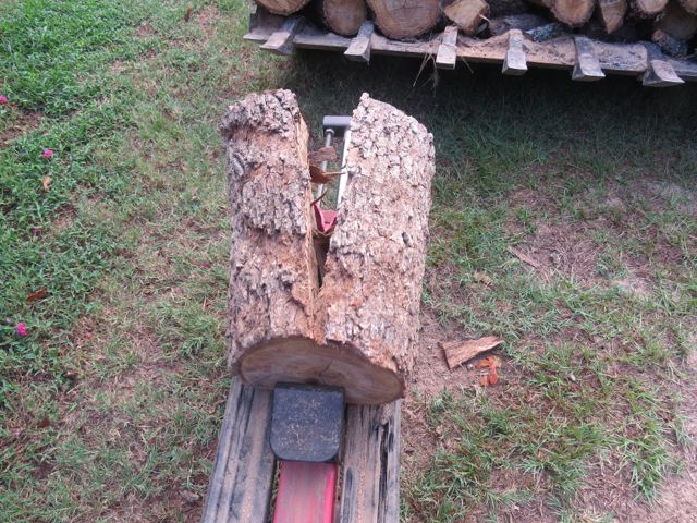

I have this electric log splitter from Harbor freight. It's working out great.
5 ton Log Splitter
It works like the youtube above. Sometimes I put a really large log on (a lot larger than the recommended 10" diameter ) and have to first run the chain saw to make a 1" deep cut on the end to help the wedge get a splitting start especially if the wood is not seasoned. The log below is a recommended diameter and required no starter cut and was not completely dried.
I added a foot control - a wire wrapped around the hand lever and connected to a foot board.
A before, during and after pics.
