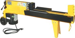

I use a 5 ton splitter bought from Princess Auto in Canada in March 2007 for $288 cdn. They still sell it at $400 cdn:
5 Ton Electric Log Splitter | Princess Auto
I split 5 to 6 full cords per year and loaned it to a neighbour (who now has his own) to split 5 or 6 cords two years. It is made in India. The splitter has required no oil or maintenance and has had no trouble. My wood is mainly fairly small birch, pine, fir and poplar so I do not need a high capability splitter.
The splitter works great, but I split at least 80% of the wood using a Fiskars X27 splitting ax. It's faster and more fun, and the ax is my only option when splitting at my preferred location which is too far from the woodshed for 120v power. Where the splitter really shines is for small, knotty rounds (I like to split even 2" diameter once), and those with a twisted grain. It is also good for large rounds rather than using splitting wedges.
I may build another shed at my preferred splitting area. It will save my moving and re-stacking 5 to 6 cords of wood in the spring. If I do that, I plan to get a 240v splitter which will work at that location.
I much prefer an electric splitter because it is quieter. Also, they only run when you're actually splitting wood--and I take lots of breaks.
txdon, I like your foot pedal idea. I will look into doing that.
