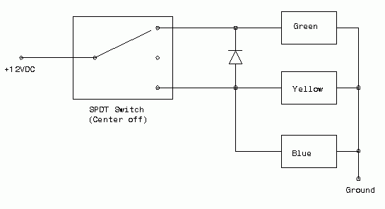

Ok...heres the deal...working on a diverter setup. I kinda have to use a SPDT switch cause its the only factory switch I could find...working on a DPDT switch which would do away with the need for this post, but having a "Factory Looking Install" Trumps the switch issue..LOL
Here's what needs to happen....
When No Power is applied to the block, the Green Hyd Circuit is "Live" (Off Position on switch)
When I want to use either the Yellow or Blue Hyd Circuit, I need to also energize the green which shuts that port down.
How?...I Realize the diagram is unfinished...

you, my friend, have drawn a SPDT switch, but described a combination of things that can't happen with your diagram.
if you truly have a SPDT switch, you have 12 volts feeding the center terminal and on the down throw in your diagram, you energize green and yellow. this is not really the "off" position but rather throw "A". on throw "B", or up in your diagram, you energize blue.
here's the part i don't understand:
"When I want to use either the Yellow or Blue Hyd Circuit, I need to also energize the green which shuts that port down."
Why is this? Is there a latching relay in the circuit somewhere or some other reason you have to energize and re-energize green to shut it down? The way it's drawn and with the switch you describe, once the switch is moved from position "A" to "B", anything hooked to "A" is no longer energized.
The answer would determine what you need to do. A complete diagram using regular circuit schematics whould be helpful.

/ Electrical Circuit Help Needed #8
Dave,
From your description, I can see how Schmart's came up with his schematic. But then if that is what you want, you might as well just hardwire +12V to the green since it's always on. I think that's what's confusing us. We're not sure what you want.
1) Are the green, yellow, and blue boxes supposed to represent solenoid valves?
2) Does this SPST switch have a center-off position by chance?
Here's my guess at what you want:
Switch thrown to position A:
Only green is energized.
Switch thrown to position B:
Yellow and Blue are energized as well as Green.
Switch in the center:
Nothing energized.
If that is what you want, the attached schematic would work for you.
If not, please clarify.
You can buy diodes at Radio Shack. Just make sure the forward current rating (usually written I/f (the f is a subscript)) is high enough to carry the amperage drawn by your solenoid valves. I have no idea what that value is, maybe 1 amp? Higher is ok and safer. This one handles 6 amps and should be more than adequate at $2.49 Radio Shack Catalog #: 276-1661.
If you want to install the diodes suggested by 3RRL's post to protect your switch from arcing, use the $0.99 Radio Shack Catalog #: 276-1102 (1N4003), connecting one across each of the solenoids with the banded end NOT on the side connected to ground.
PS: I think where you have -12vDC in your diagram you probably meant 0vDC (unless you have a 24 volt system).

Sorry to confuse you guys...I appreciate the help thus far! Lemme see if I can answer some questions so we're on the same page.
What I'm trying to do is to wire up the 3 bank Hydraulic Diverter from Surplus Center.....Port 1 (Green in my drawing) on that block is prioritized...meaning with no 12v power to it, oil will flow thru it. So when I use either of the other ports (yellow or blue) I would need to energize the green port which shuts flow off to it and diverts it to either the yellow & blue ports.
Yes
Yes, its a Center off Switch... On-Off-On to be exact
Only green is energized. - No, I would need Green & Yellow Energized
Yellow and Blue are energized as well as Green. No, I would need Green & Blue Energized
Nothing energized. Correct
/ Electrical Circuit Help Needed #11
ok, so if we understand this right:
switch is off, green is on (due to priority, it is on when no voltage applied).
switch in position "a", green is energized shutting it off and yellow is energized turning it on.
switch in position "b", green is energized shutting it off and blue is energized turning it on.
if that is what you need, larry's diagram is essentially correct. i wouldn't think you would need the diodes, though, unless your switch is seriously undersized for the solenoid current draws.
#12
You got the operation of the switch exactly correct.
Switch is rated for 20 Amps @ 12v and each solenoid draws 1.5 Amps according to SC...so even running 2 at a time thru the switch shouldnt be an issue.
