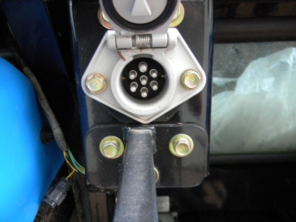

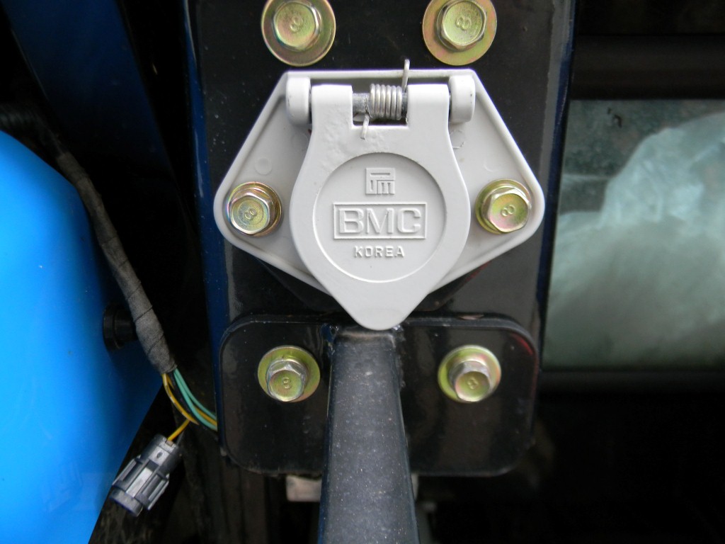

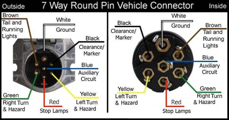

The plug on the back of my tractor is a 7 pin SAE J560. It has 7 round pin connectors with the top pin larger than the rest. Attached are pics and wiring diagrams if yours is the same. Vehicles usually have a 7 flat pin connector or standard RV plug shown in the last pic and attached pdf.

Yes, I'll try to get a picture of the tractor end, maybe even measure it.
Not very often, but just once in a while I would like to move a trailer (with a 7 pin flat blade plug on it) with my tractor and it would be kinda NICE to be able to plug it into the tractor.
That rectangular socket on the tractor has bugged me since day zero (the day BEFORE I bought it).
As I said, on the back of the 7 pin socket of my Durango there is a plug that looked similar and given the Daimler/ChryCo/MB conglom muddle I thought for the moment that I might have stumbled on the secret "adapter".
A minute later hope was gone (-;

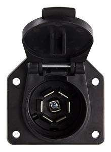

Etrailer has a 7 pin round to 7 pin flat adapter. If your tractor plug is like mine this adapter will at least let you tow your trailer and have working lights. You won't have trailer brakes due to no brake controller on the tractor.
Pollak Trailer Connector Adapter - Vehicle End - 7-Pole Round to 7-Way Blade Pollak Wiring PK12-724
Thanks, but nothing like that.
It is rectangular and has flat blade type connectors arranged in two columns (4 or 5 rows).
sort of thing.

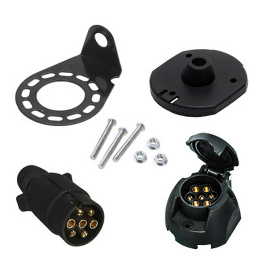

It's indeed a European standard 7 pin trailer plug. We also have a 13 pin. Not sure why they would use that socket in the US market though.
EDIT: Just read Reg's posts again and this probably not it but I'll still leave it as comparison.
