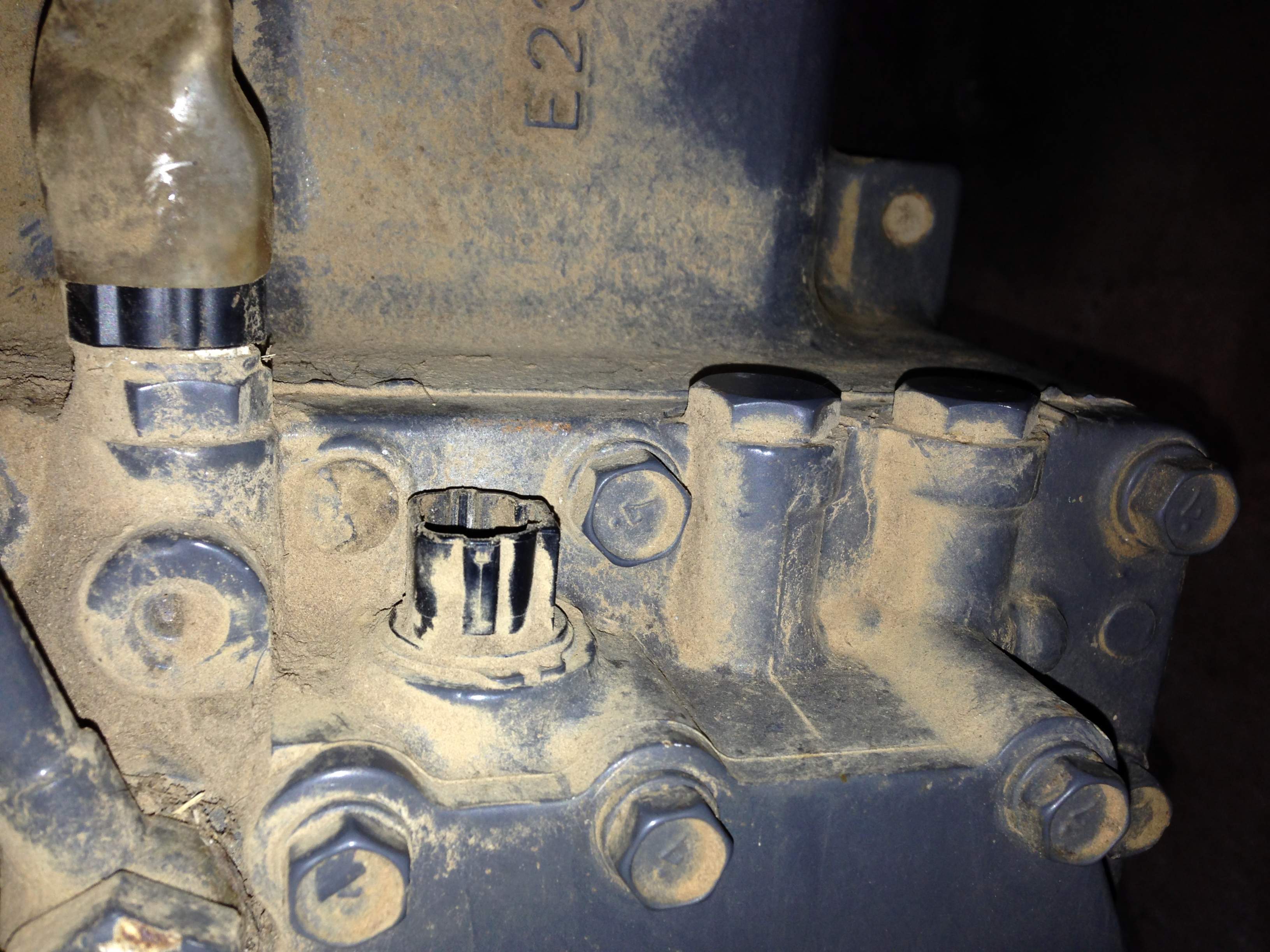

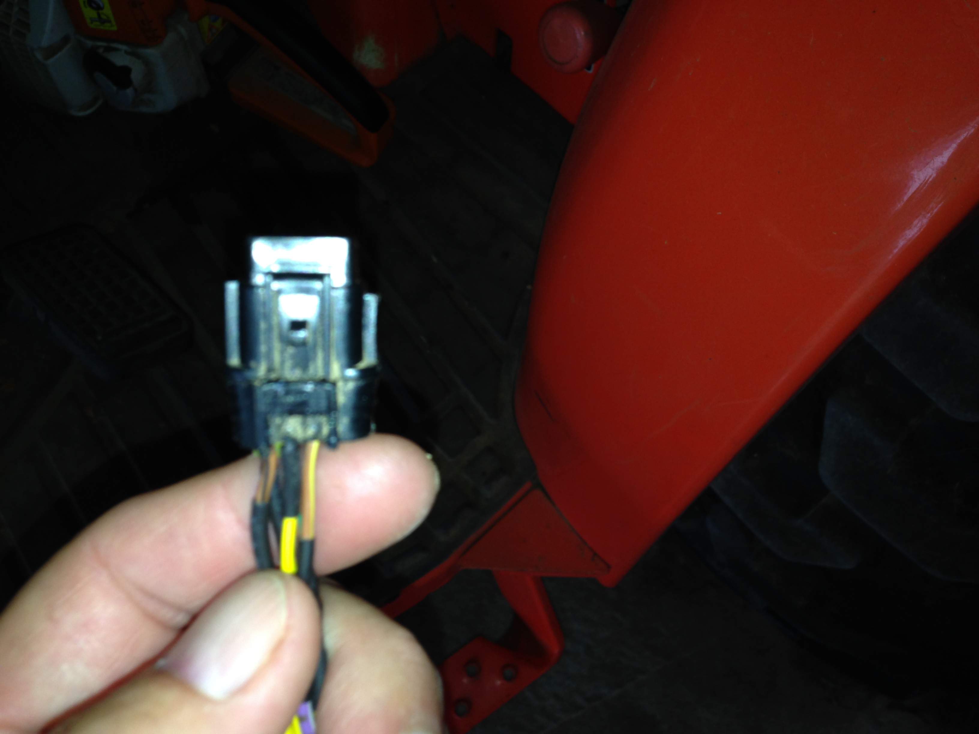

Does anyone know what type of electrical connectors or on Kubota L 3430, I cannot see paying a 1000 bucks for a complete harness when all I need is one 6 pin connector on the transmission, any help is appreciated.

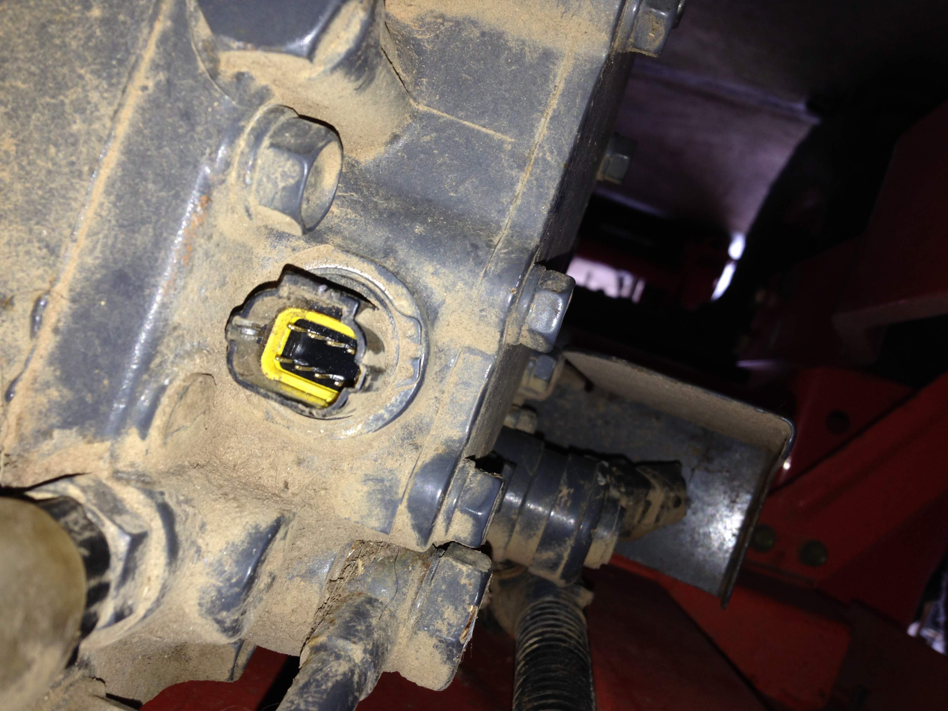

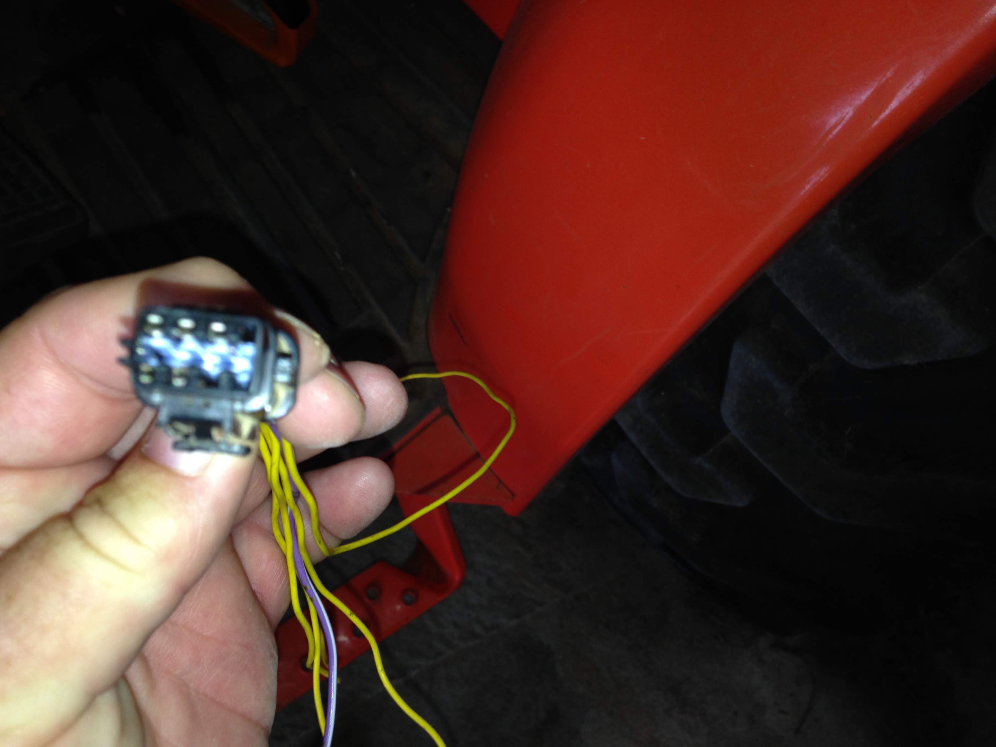

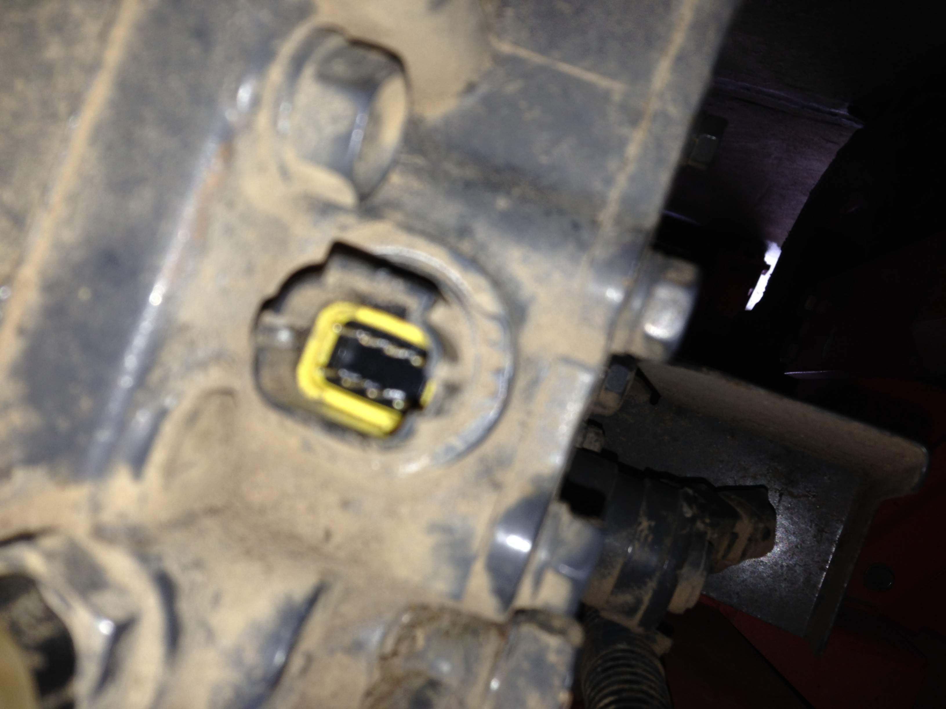

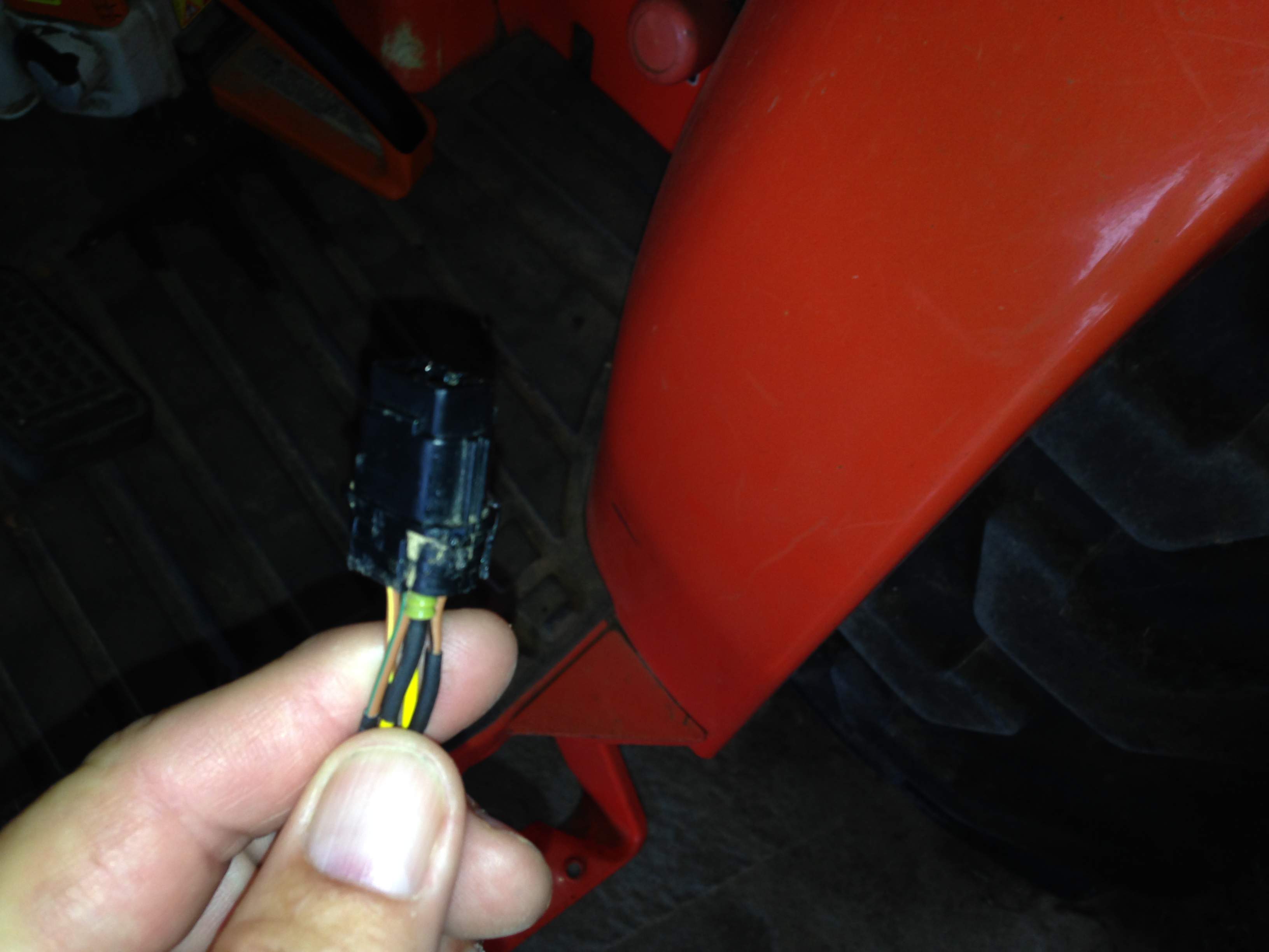

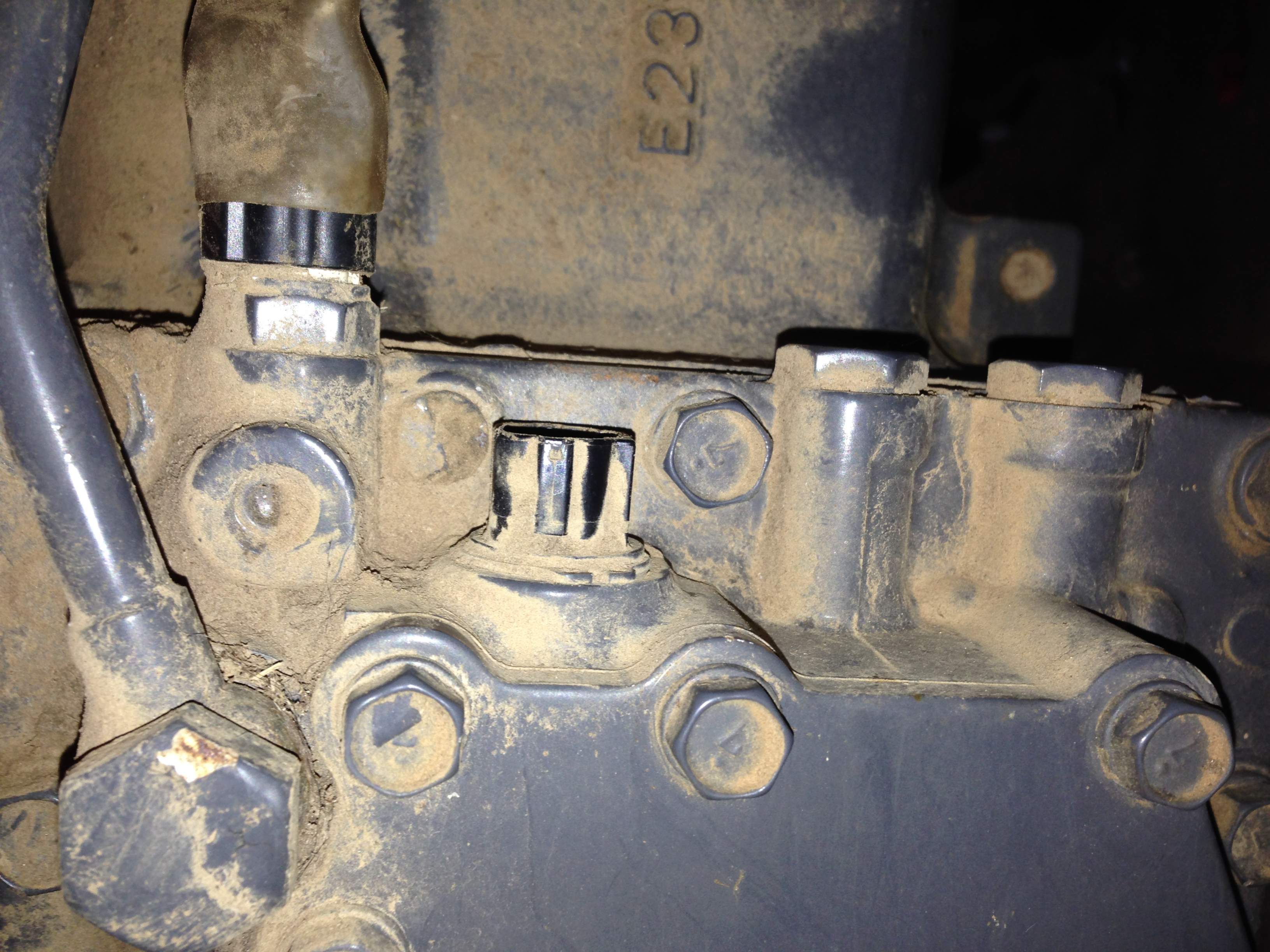

   / electrical connectors

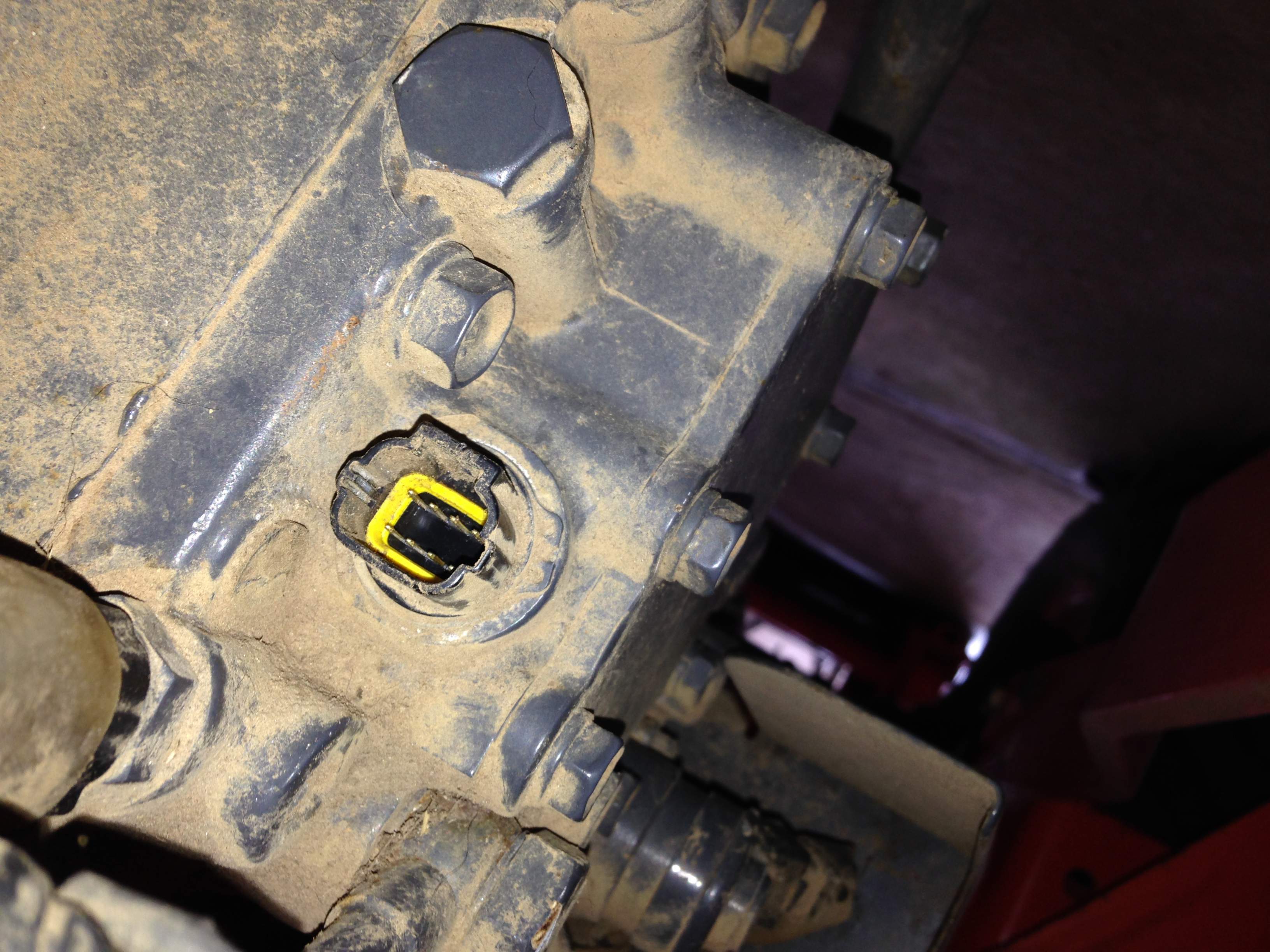

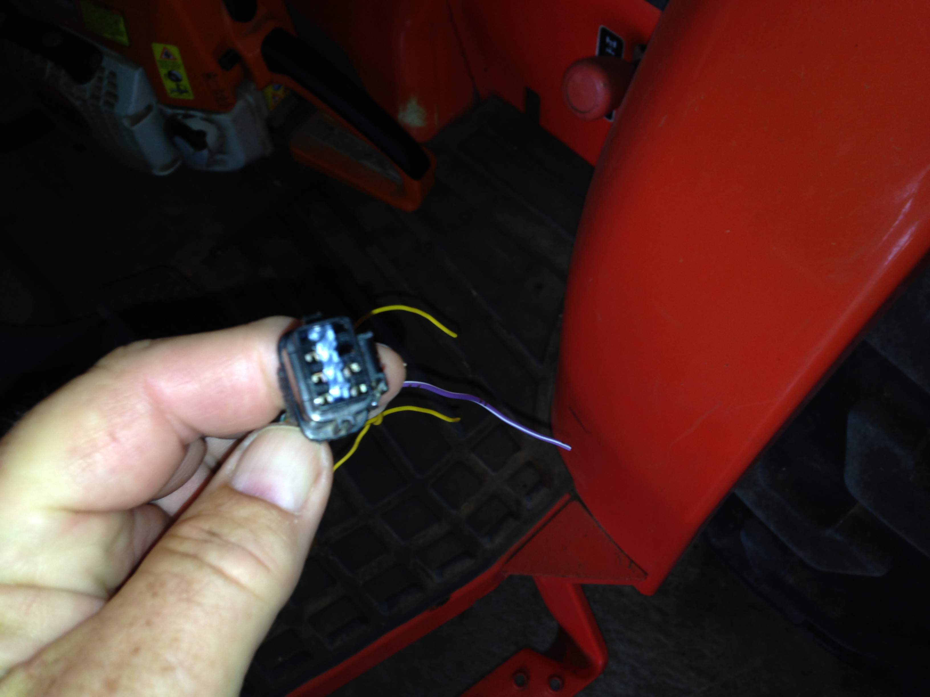

I dont have a problem rewiring the tractor, I have already made a couple of repairs, unfortunately the male plug for this is snap ringed into the transmission and the female (chewed part) is missing one of the female pins, I have already bought several plugs from the sources you guys mentioned, and none fit, very close but not it. Most of what I have found leads me to believe they are Toyota automotive connectors, I just need to find the right pin to replace the missing one.
I have included some pics. IMG_0947.jpgIMG_0948.jpgIMG_0950.jpgIMG_0951.jpgIMG_0952.jpgIMG_0953.jpgIMG_0954.jpgIMG_0955.jpgIMG_0956.jpg

the pics are way to unclear to tell anything.. but if you thought it was a auto connectior.. i'd stroll thru a junkyard at lunch...
otherwise.. i'd figure out how to go pin to pin directly with a home made wire job not usinghte conenctor. or usingthe connector with 1 pin moded.
   / electrical connectors #10
I do not want to make a suggestion that will lead you down a black hole.
But WORST case senerio:
I do see a snap ring at the base of the connector on the tractor and a plate that can be removed on the side.
If you truley cannot get the replacement parts, there is a possible workaround.
Without knowing what is inside it is hard to guess further.
Can you ger a parts view of the innards?
