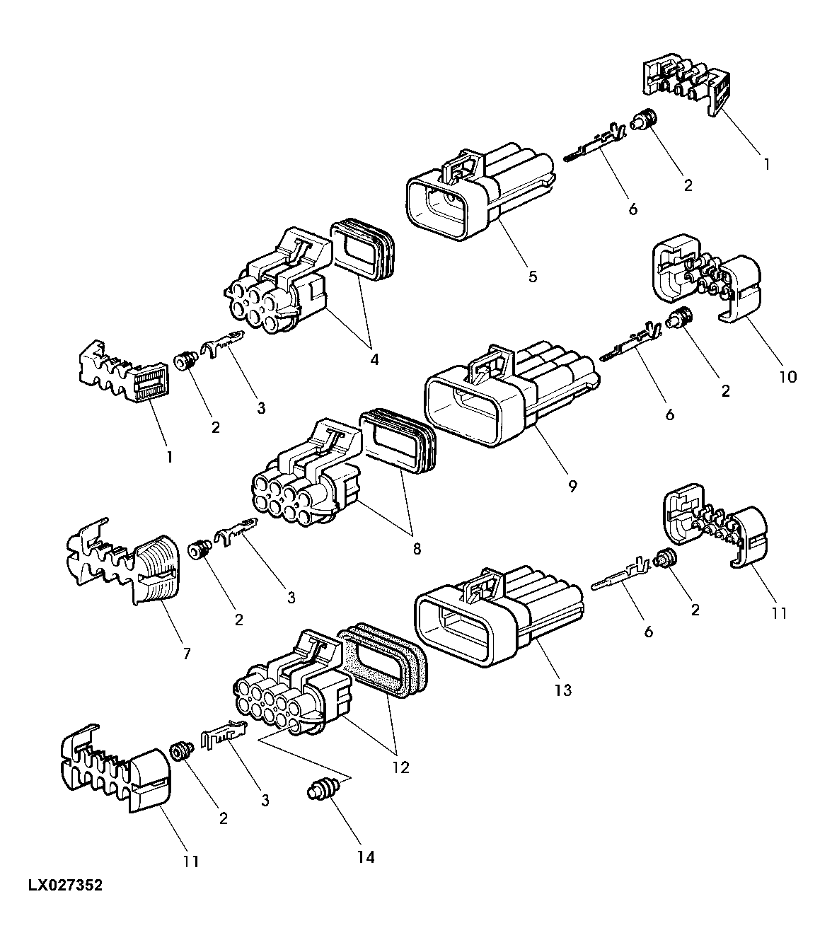

Well it really is an 8 pin , though it only uses 6, I mistakenly call it a 6 when it is an 8 pin so you might have found it, i'll let you know.
Thanks
Smittyed, I looked at your photos and I can't see anything wrong with your connectors, either on the tractor or the mating connector in your hand. Why is it that you need a replacement? Is a pin messed up on the connector with the yellow wires? Is it possible all you need is a pin to insert or maybe a repair to that connector body? I'm just not clear on what the issue is. You've had some great suggestions. I'm sure you can find this weatherproof connector if you keep looking. I doubt it is proprietary to Kubota. They don't want the expense of using a one-off connector when thousands exist in the marketplace.

jinman,The male in my hand is the chewed part, mostly wires at the back of the plug, the problem is that the pins in the male plug are the female pins and one of those is gone, these plugs fit very tight and I'm trying to find a plug with the same size female pins to repair it or replace it. I've already bought several connectors online and all are too large for the plug, (24ga. wire I think). This plug is the sending connection to the PCU for the condition and position of the transmission, so without this NO tractor. I have tried to get help from Kubota and they can only suggest complete harness, frustrating.

If all you need are the female terminals to install in the connector body you have your
GM dealer should have several boxes of just terminals (box with multiple compartments) you might be able to match up what you need.
   / electrical connectors #28
John Deere dealer might be able to match up what you need. Does key 2, 3, 7, & 8 in the drawing looks similar?
