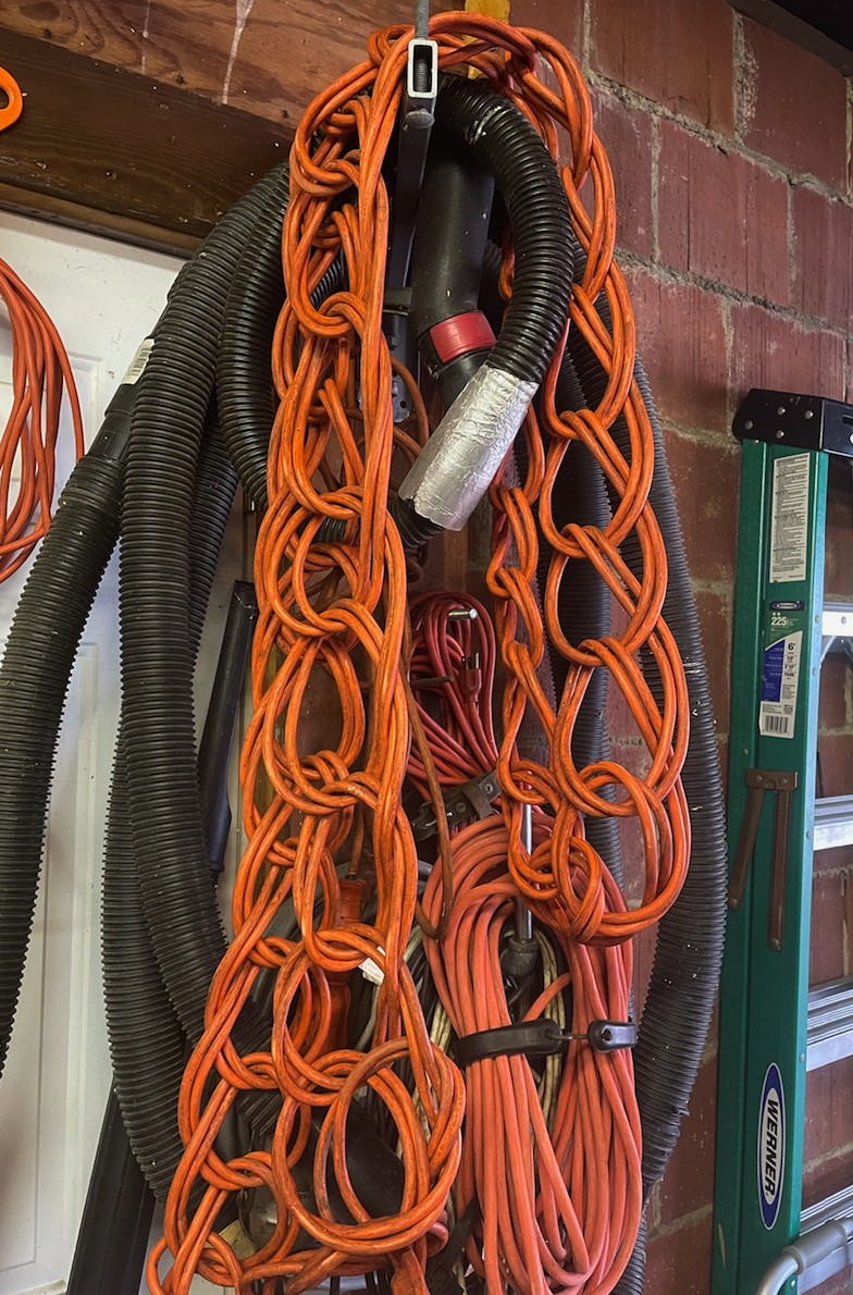

Yesterday I went down to my MIL's to pressure wash her vinyl siding garage and carport. My FIL has been gone now for close to 2 years. Looking for some tools in his garage to help with his old pressure washer, I came across this one electrical cord. I have to admit, I thought is was kind of odd looking, but knowing my FIL, there was a specific reason why he did this and not just because it looks interesting. Anyone store cord like this, and why? He spent 30 years as a power lineman, and he always had his reasons.
I've seen that method several times in my life. I don't care for it. Probably because it takes more work and time, and if you've ever tried to undo one in very cold temps, you'll curse.
I roll mine up by making loops onto my hand with a twist, which greatly reduces tangling, or the elbow method if I'm in a hurry, which tends to put a twist in the wire and is harder to unwind.
I keep a loop of rope on my extension cords, and just use that to loop around the bundle and hang it by when I'm done.
That being said, your FIL seems like someone that took pride in their work and tools. (y)

I roll all my long 100’ cords by daisy chaining them. Really easy to do, never tangles. Just comes second nature after years in the const trades. On smaller 25’ cords, i just roll them up. In my shop i have auto retracting cord reels on opposite sides of shop. Also self roll air hoses right next to the power cords.
all my long 100’ 12 g cords are all weather rated. Expensive, but dont freeze up in sub zero temps.

I like this method also. Google crochet knot if you don't know how to do it. Lol.
   / Electrical cord storage #28
It does seem like a user of this method would mark the middle.
I was an industrial electrician, and occasionally someone would do this, but rarely was an outlet very far away - shorter cords made more sense.
I have seen 'roadies' do this with band gear.
I elbow wind - even my long cords - and half hitch high, go backwards, and wind down some like a noose and then lock in the other end in the fitting. Works, throwable, etc. The 'back' is random enough that they don't show wear/kink.

I don't personally use this method, but I've seen cords stored this way, yes.

I used to store all of my 50 foot and longer extension cords by chain tying them.
I got tired of having to redo them anytime anyone borrowed one, so I stopped doing it.
Not they're just coiled up into one loop coil and usually hung up on the corner of a shelf in my shop.

I hate dealing with long extension cords or ropes that are coiled. The problem with coiling or "elbow wrapping" is that you put a twist in each wrap as you coil it. Since people seldom undo that twist when uncoiling, it tends to twist up and tangle as pull an end out of the coil.
I tried the "daisy chain" method but it was a bit time consuming, and left some of my cords kinked up.
I ended up adopting a technique from my rock climbing days known as "flaking" the rope. The finished product looks like a coil, but avoids putting repeated twists in a rope or cord. I do this on anything longer than 50' or so. I'd try to describe it, but I'm sure I'd botch the description. There are numerous YouTube and other descriptions you can find by googling "Flaking rope" or "flaking climbing rope". If I get a chance, I'll make a video of it.
(NOTE: there seem to be a couple of different meanings of "flaking a rope": one definition ends up looking almost like a coil of rope. The other involves just laying the rope on the ground in such a manner that it will not tangle as you pay it back out. I'm talking about the coil-like method.)

I do the climbing / mariner thing where you twist the coil in hand for every loop of the coil, so that there are no twists in the cord or rope.
I was told that the daisy chain method is storing cords was actually hard on the cord due to the tighter loops. I have no data and mentally filed it under the "might be true, might not be". Personally, I have never lost an extension cord due to a wire failure- cuts in the outer insulation, serial replacement of the ends, but never due to an internal wire break. YMMV...
