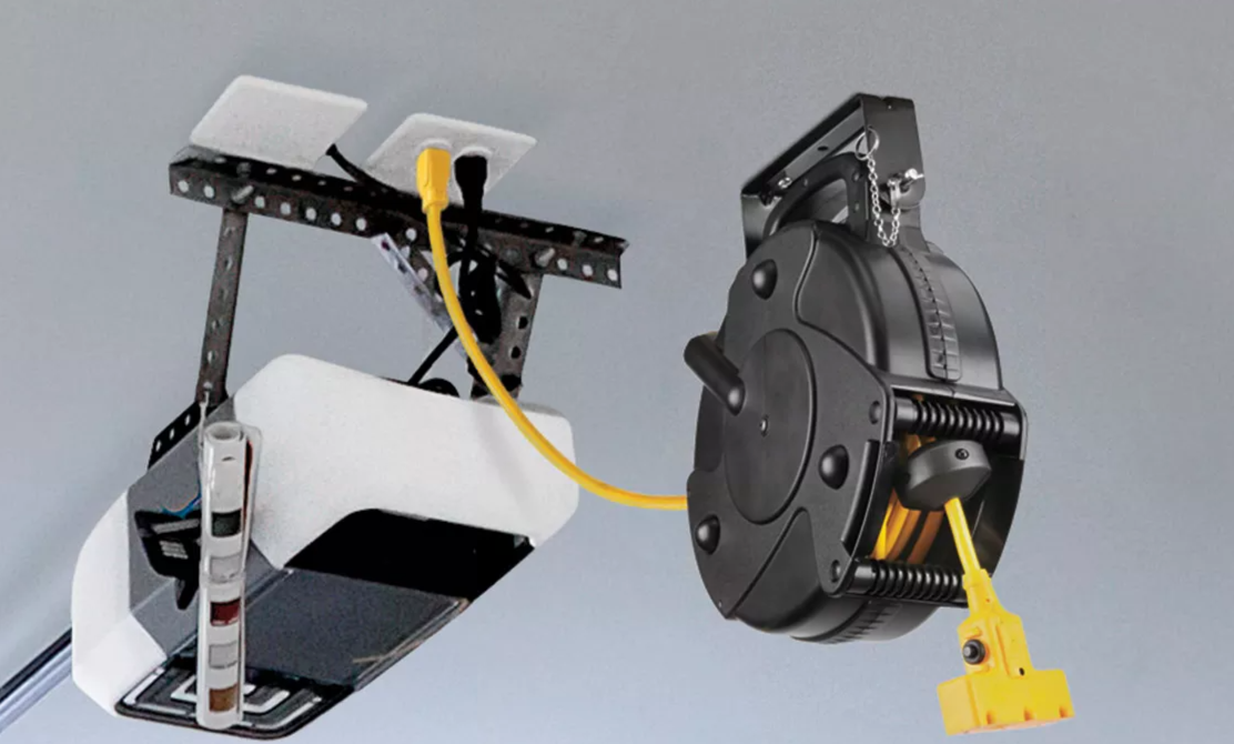

I have two of these 20A , 40' retractable cord reels hanging from the rafters of a 24' x 40' barn:
They can be set to hang at any height and between the two, I can reach anywhere in the building.
   / Locking (electrical) outlets/plugs.... #8
Yep. There’s always an outlet with your garage door opener in the ceiling and its a perfect spot to hang a retractable cord from.
It’s installed in 15 minutes and it’s cheap, like me 😁

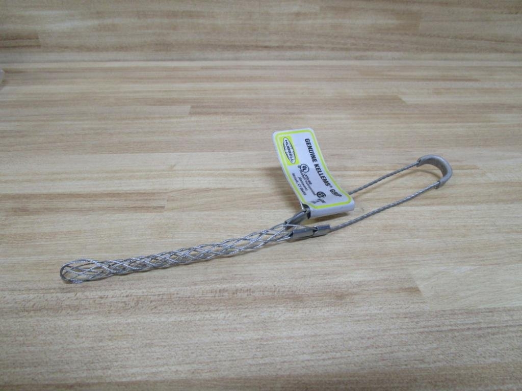

I like to run SJ or SJO 12/2 with a from from a ceiling box with a strain relief.
Such as these; buss drop support grips
