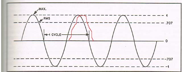

Basic alternating current 101.
the generators produces a wave that goes positive and negative at 60cycles per second. The peak voltage is higher than the RMS voltage. Useful voltage is measured as .707 of peak this is RMS and where you would normally have your 120v.
If the two generator heads are out of phase by just a few degrees this will cause the period of peak voltage to last longer and thus the RMS will also increase. I ain't a whiz at drawing but in my picture the second generator is the red line and you can see how the peak voltage would last longer and thus cause the RMS to be higher. In three phase current the three peaks would be spaced exactly 120 degrees apart and thus cause the RMS to be considerably higher. You have the two heads slightly out of phase. Believe it or not if they were not geared together but running via separate engines the would synchronize their self.
Not arguing, just interested in this last sentence, I know that the small Honda gensets such as the 2000 and 3000 inverter units tie the outputs together when you chain them together. Always thought that odd is this the same priciple?

No, the peak would not last longer. Across a common load, the voltages would add vectorially. This is why I brought up the 208 volt 3 phase comment as an example.
In parallel, yes. In series, no. Diesel generators that are put on-line for additional increases in power are often done this way. However, you had better make sure that they are almost in phase when they are combined.
