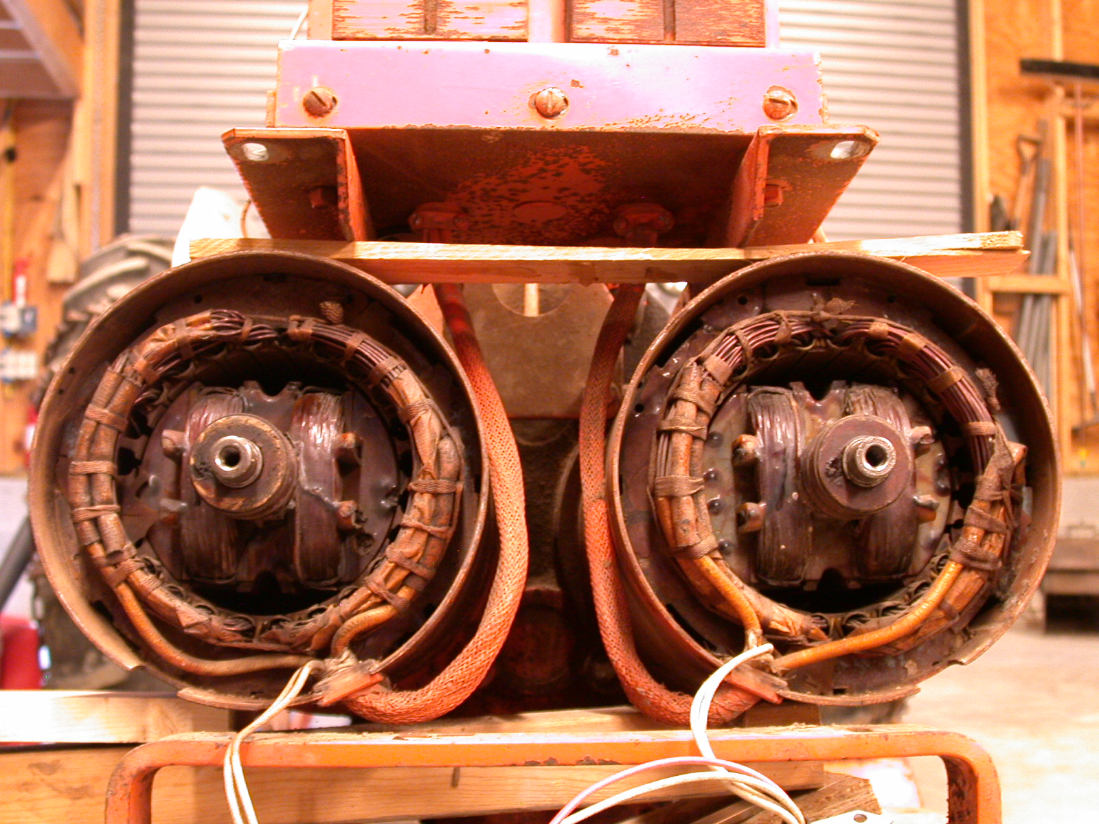

Took some time tonight and added pictures of both units brush end showing the armature locations. Second picture shows the sealed voltage regulator.

dangier_VA.. When you get the gear back together and try it take readings from the individual units .. It almost sounds like one unit is trying to pick up the whole load.. I'll give Generac a call next week and see if they have any information on this unit,,

The heads are in series therefore they should be in phase (zero deg) to produce maximum voltage. 180 deg appart will produce zero voltage.

Attached is a crude diagram of my unit. I had said it was in parallel since each coil furnishes a leg to the breaker. Looking at the diagram it could run each way.
Still trying to wrap my head around the following statement:
"The heads are in series therefore they should be in phase (zero deg) to produce maximum voltage. 180 deg appart will produce zero voltage."
From my simple understanding, heads in 0 degrees would produce a single sine wave but double amperage, and heads at 180 degrees would produce a double sine wave and half of the amperage. Does this make sense. Which is better?

I am not a good source beyond theory, but it looks like a split phase transformer setup which in my limited expierence fits your set-up. Each phase is 115, and puts out 230 when added together. I think your good with the set up, the regulaters may not keep your voltage tight because of their age, or configuration. Probably not a good source for sensitive electronics. Get a tech's opinion first...

dangier_VA.. Talked with Generac today... and as I thought it is an old unit and not in there computer setup.. I told they guy your questions, #1 voltage being high 127 and 129.... He admitted yes but not that bad.. #2 that you had a bearing issue and were worried if you skipped a tooth putting it back in,, He said not to worry about skipping ..
Other comments he had were that if you had a bearing issue in one of the heads this could cause a voltage problem.. because of the rotor not running in a perfect circle. ?? another thing he said was allot of the older pto gen sets ran at 58 to 59 hertz. and that kinda makes since with the ups issue you had too.. Ups's don't like high volts but don't mind a little less hz.. He said to try setting your rpm more for the voltage but keeping the hz within limits..
Hope this helps..
/ Electrical Engineering Question

My educated guess is that they are identical heads wired in series but the phases have to be correct which I'm assuming you didn't fiddle with (wiring that is). The voltage imbalance is neglectable as each head may not be perfectly wound possibly causing more or less voltage on one or the other or (and this is a guess) that your resistive load is across the 240 volt. If you could put the same load on each generating head you could see if you get the same loaded voltage from each head with the identical load. Frequency within reason (a few hertz) is irrelavent to most household devices with some electronics being the exception. Good luck and thanks for all the info. I stand to be corrected if I stated something wrong.
