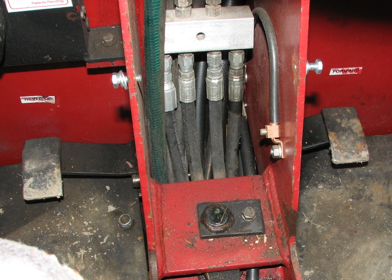

Not sure it is doing anything but I ran a big ground cable through the tunnel to connect the two halves.

I think mine would handle the ground for the gauges :)

Ken, you are able to turn the wheel on that tractor with that cable?
dcyrilic... Paranorman is its current title. Family "claymation". Not the normal kind of movie i do but I wanted the experience of doing animation instead of live action, and I get to live in the PNW for two years. August 11 I think is our release date (of 2012)
