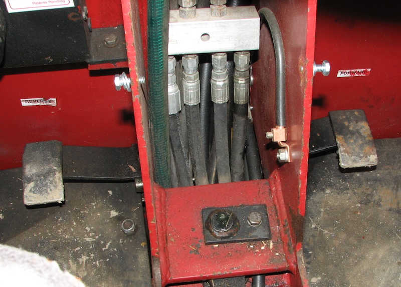

I think mine would handle the ground for the gauges :)
Ken

Ken, you are able to turn the wheel on that tractor with that cable?
